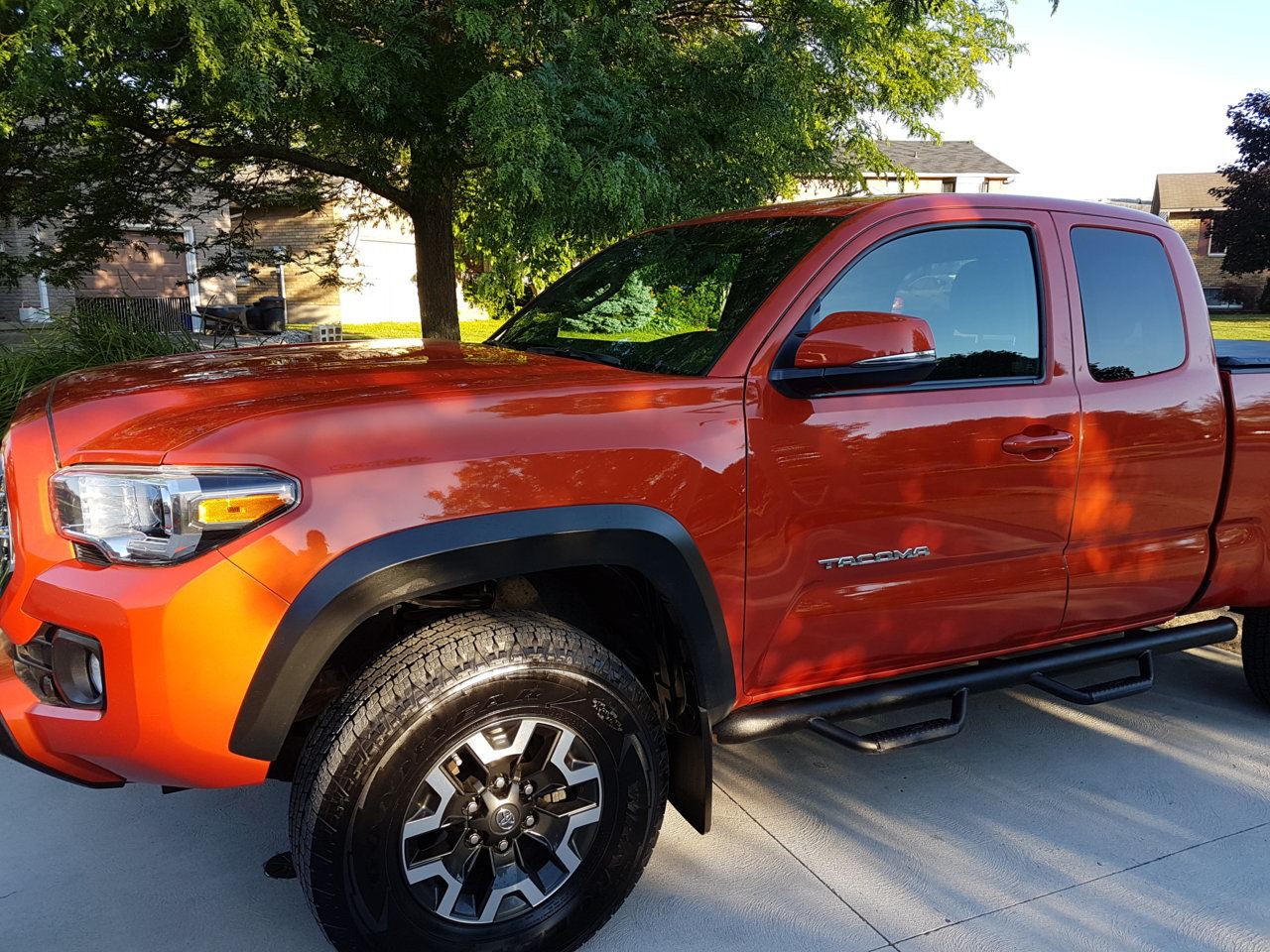

    My '16 Tacoma with the block heater connect up front

    What do you mean "what did I do with my truck?"

    It was a lease and we needed a back seat. Gave the keys back early no penalty to another guy.
