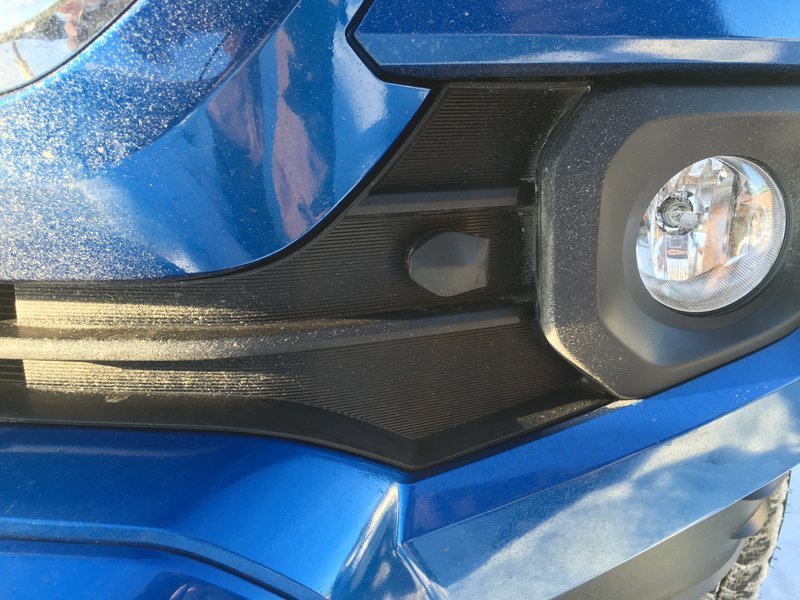

    You don't have to mount the plug next to the fog light. I have seen some Tacomas with the plug mounted in the bumper. IMG_2317.jpg

    Is there a part number for that or is it molded in the fog light housing? If there is a part number I would like to mount it to my aftermarket bumper in some way.

    That's the Toyota one. I don't have the part number but it goes basically where you want to drill a hole to install the plug. It also comes with 2 power cords. Pretty sure one is 18 inches and the other is 5 or 6 feet. Truck is usually on the road or in the garage. I like this setup. Looks cleaner and I have had block heater cords in the past flapping in the wind and banging on the vechicle. And if you forget to unplug it it doesn't cause any damage.

    Hey how come you get that clean-looking install and all I get is an ugly cord zip tied above my license plate?

    I have the block heater that was installed by the dealer. Toyota made the stupid decision to make the connection "special".
    The end coming from the engine can be mounted wherever you want. Drill a hole and mount it to the fog light housing, bumper or wherever. You then take the Toyota specific cord, attach it to the connection you've mounted and then plug in to any extension cord.
    I broke my fog light housing the first time I forgot to disconnect the cord before driving away. Dumb me but dumber design.
    If I had my way I would take the Toyota cords, zip tie them inside the engine bay and only have a little tag end sticking out of the grill. Attach to an extension cord when you want. Pull the tag end into the engine bay out of site in the summer.

    if you forget to unplug it. The plug is facing forward and it will pop the cord out.

    Mine came installed by default due to region, but it's to the left of the fogs, between the grille and licence plate; sort of where people mount the stealth LED bars. I can't believe people living in environments that require a block heater can get away with that little flip cover...does it not get covered in ice and frozen shut? I prefer the "loose" connection that allows more freedom in where cords are at and where I can park.

    Any real-world experience of the engine block heater with the plug-in located next to the fog lamp? I like the look, but - like others on here - I'm a little concerned that the plastic flap will either get frozen closed, or just snap off. Also, on the off chance that some wanker steals your cord you'd have to re-order one from the dealer. That's dumb.
