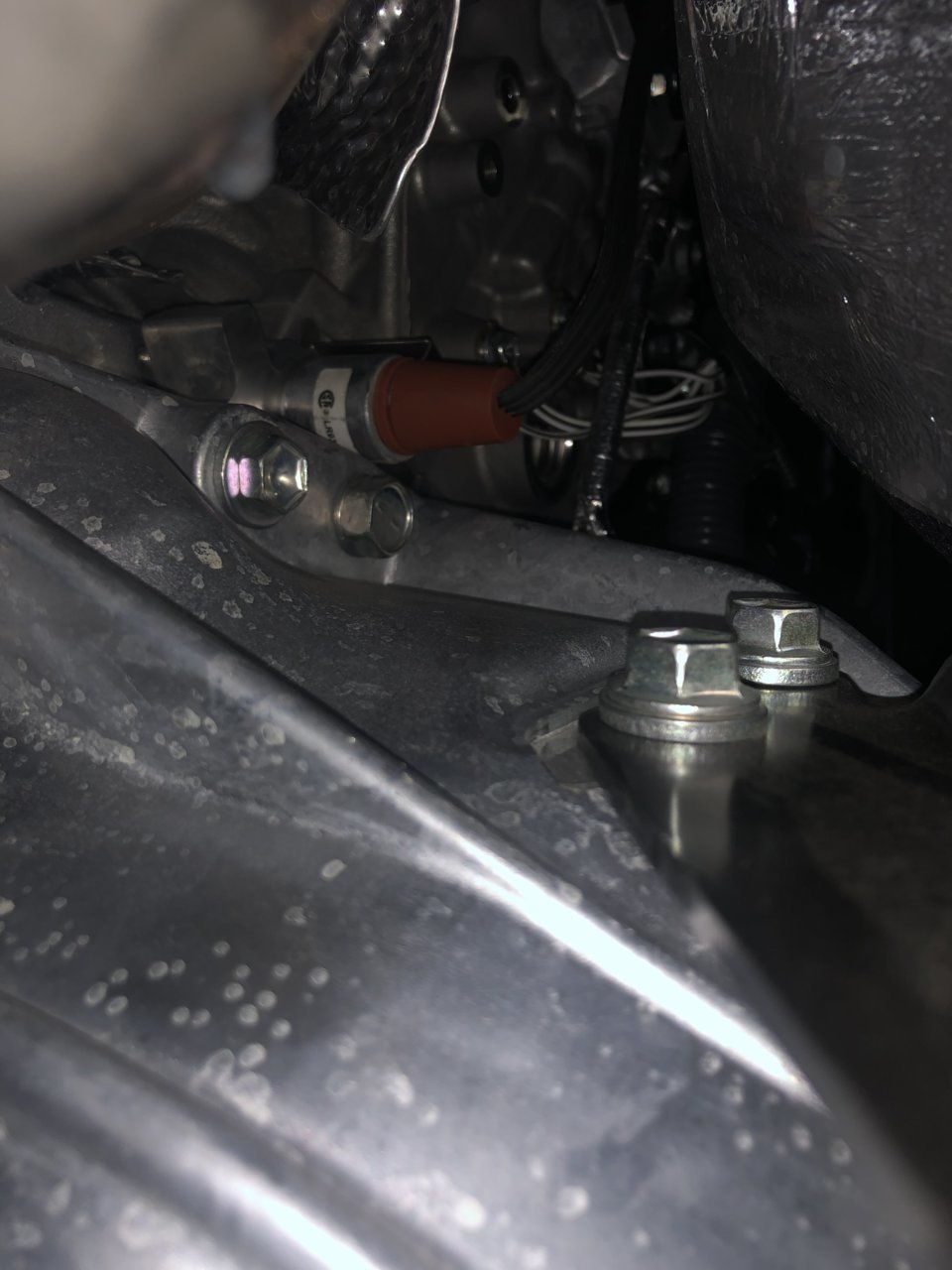

    Ok here goes with my block heater install.
    TLDR: you aren’t going to do this. Nobody is going to do this. Keep ‘er movin’
    It puts a big ugly port on the front of the truck/ you think I ruined my truck. Don’t even @me.
    As mentioned earlier here are the parts I used:
    The advantage of this over the Toyota Canada spec parts are that they are cheaper, easier to source, and does not require an adapter cord.
    That’s it, that’s all.
    The heater installation is really easy and etrailer has a link to their video on the product page. Go watch that. Only thing I didn’t do was remove the support. I had enough room to get my hand past it.

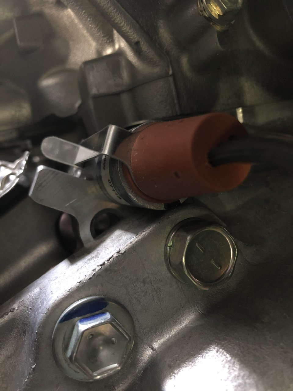

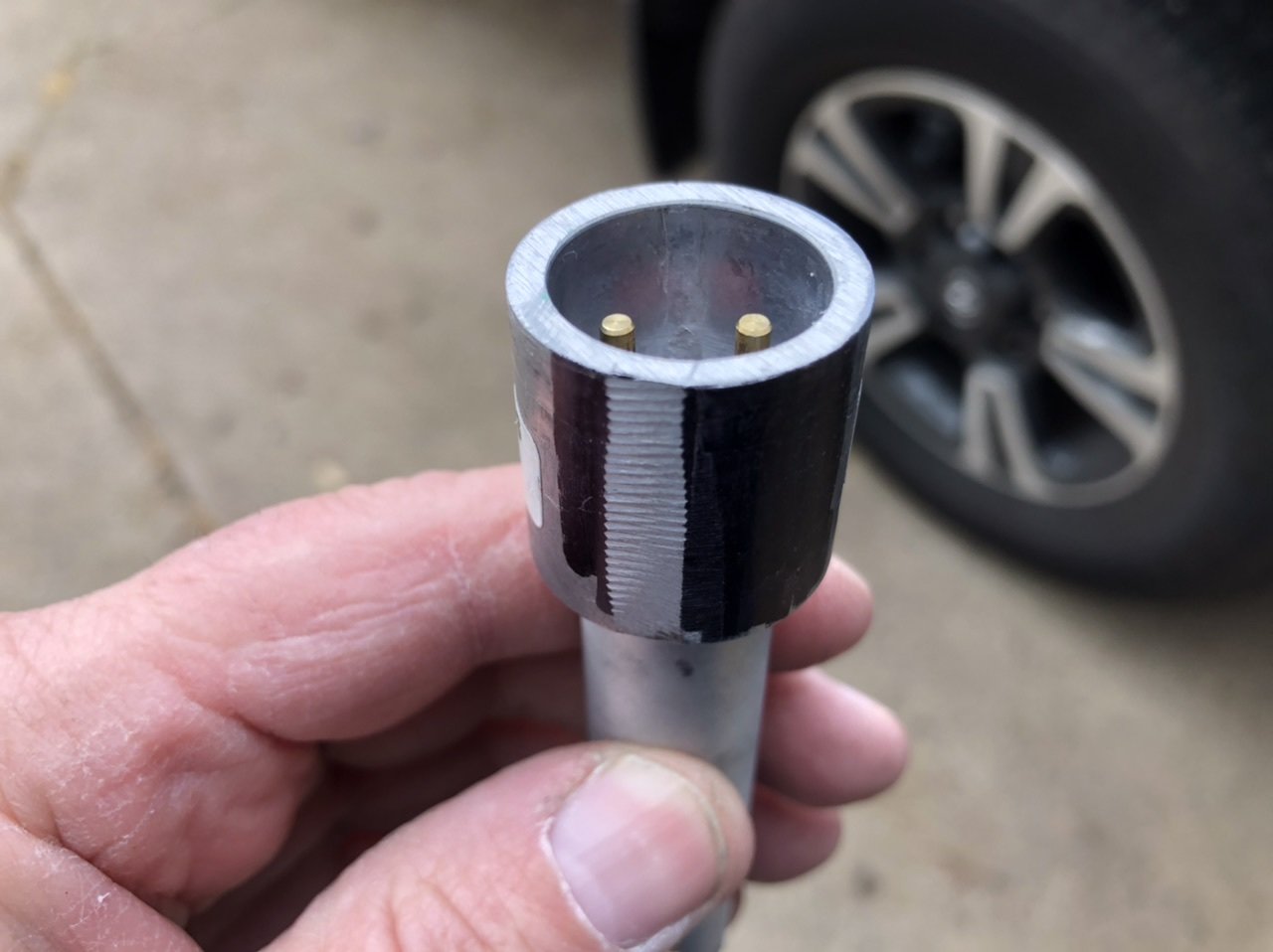

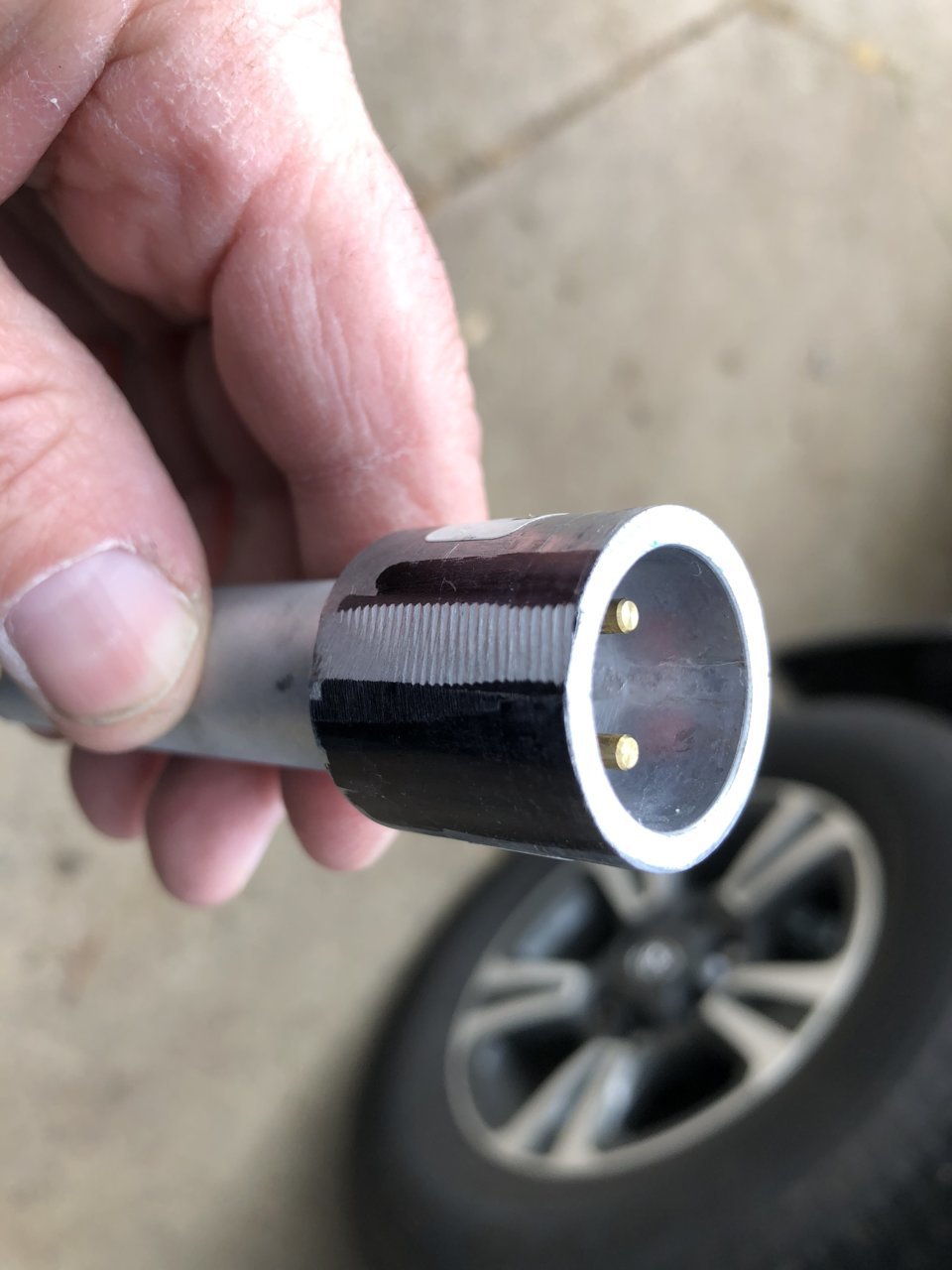

    I had the same issue as Tharris242 in that mine wouldn’t slide all the way in. It interfered with the bell housing overhang so I filed it a touch.
    This shows where I filed the flat.
    Heater installed
    it was a bit loose even with the spring clip. Hasn’t moved after being on the road though.
    That’s all that was needed for the heater itself. If you run the cord like in the video it reaches near the battery. One can then pop the hood to plug in, or get a short extension cord to run it to the grill.
    That said if you want/need more convenience keep reading.

    When installing the heater make sure the clip is seated in the groove. That is why mine seemed loose. I had to bend the clip forward just a bit to get it to properly lock
    You can see this from the side if you look under the brake booster.
