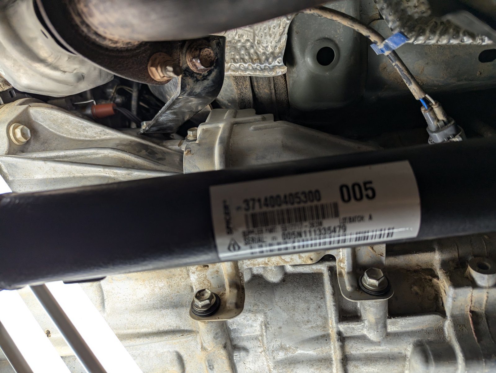

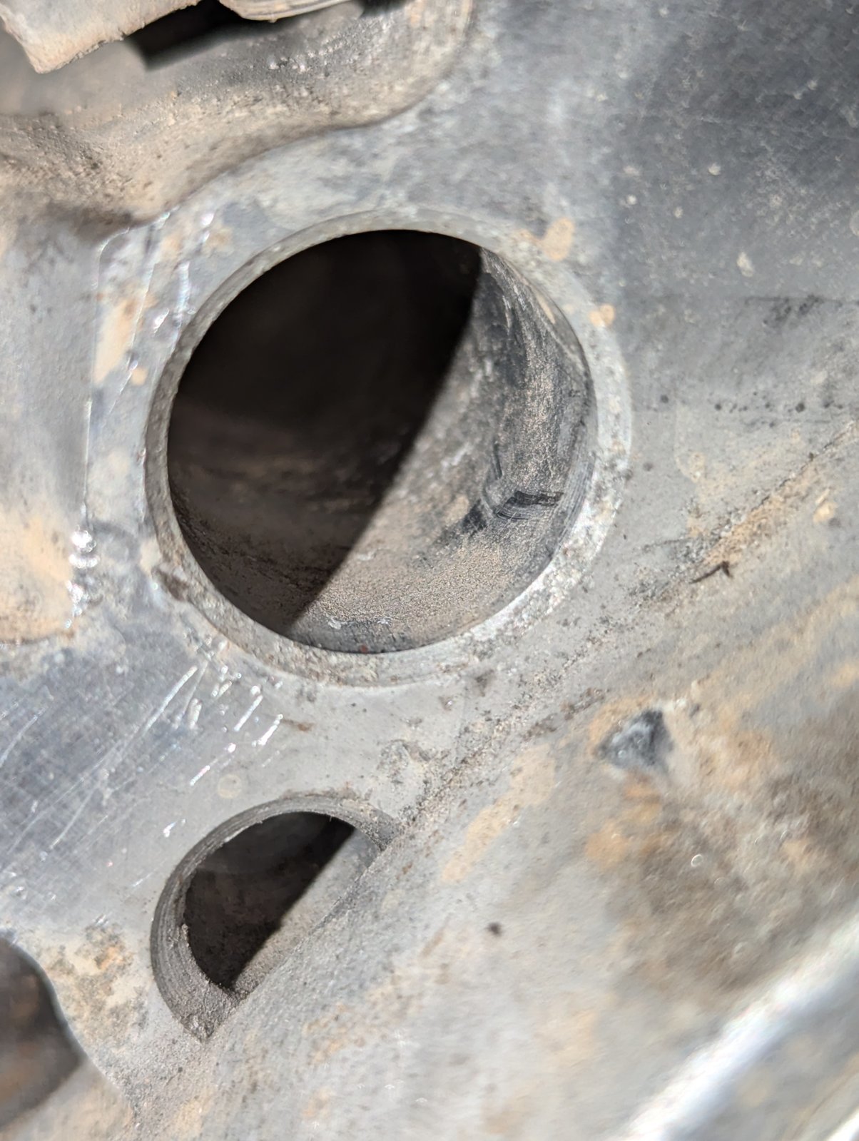

    Reviving this thread, but I had attempted the block heater install in November of last year. Got the Kats heater half way in before I got it wedged between the engine block and transmission, and couldn't get it back out. You can see in the first pic that the hole doesn't have much room between it and the side of the trans.

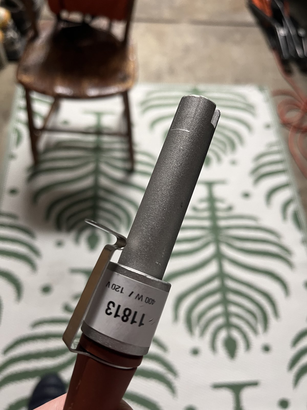

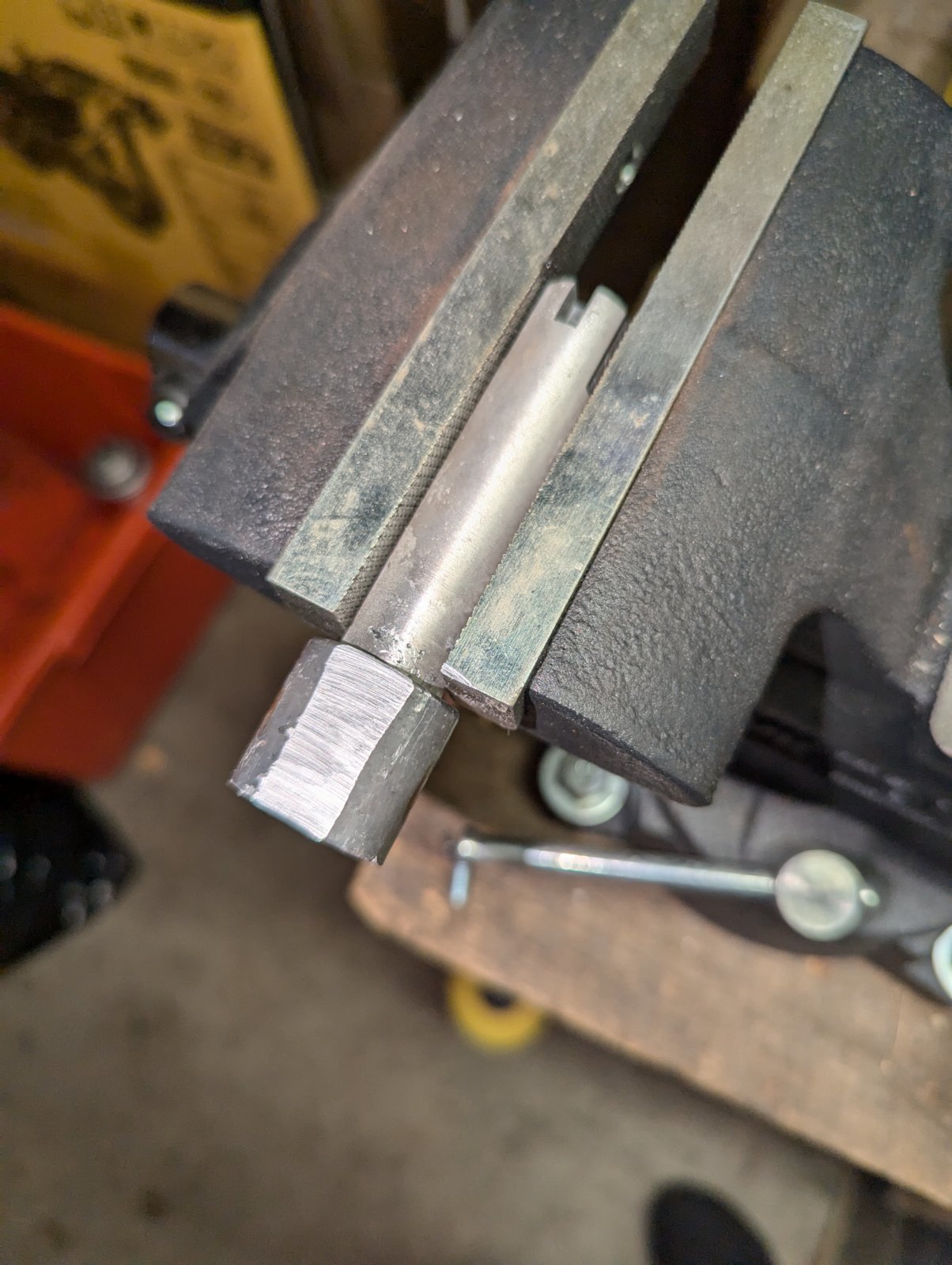

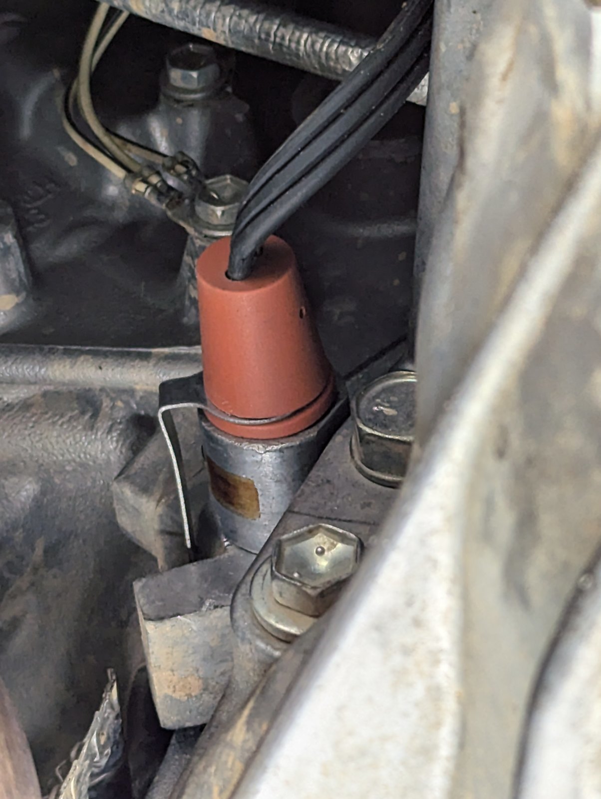

    Fast forward to today - took off the cat support bar and used a pry bar to wiggle it out. Ended up following the advice of somebody on a different block heater thread and shaved a bit off the side of the heater. Slid right in no problem, got it clipped in. Good to go! It's waaaay up in there. Even with taking the cat support out, be prepared for some cuts and scrapes if you have larger hands. Funny thing to be doing in July, but I was already in there doing the accumulator delete + trans shield vibration dampening. At least it's done right and all ready for the winter now.

    Would definitely be useful for the -40 days! Do you know if there's supposed to be any resistance when putting it into the block? Mine just slipped in lol

    Nope I haven't had any issues. I had it (improperly installed) since last year and looking at it yesterday there was no seepage. I don't think it directly interacts with the coolant system like that.

    Block heaters typically heat the antifreeze.
    Just watched a video & it installed into a dry portion of the block. Really weird

    Ya these and atleast the other Toyota one's i've installed have been into a dry cavity which is close to a water jacket. Not directly into a coolant jacket like "conventional" ones.
    Maybe a wet heater works better because it's directly contacting coolant. However i'd say the dry style last longer as there is no danger of coolant leaking through it and shorting it out or it overheating and burning out from starting the engine and having a void of air around it

    Just to echo what’s already been said, these don’t use a frost plug like I’m used to, just slip into an existing dry cavity.

    Most modern Toyota engine blocks are open deck die cast aluminum without any or few hole plugs to the water jackets. Aluminum conducts heat very well.
    These two things combined make these dry block heaters pretty easy and effective.

    It does have to clip in & then you know its seated correctly. That’s after you shave it. Here’s the one I bought.
