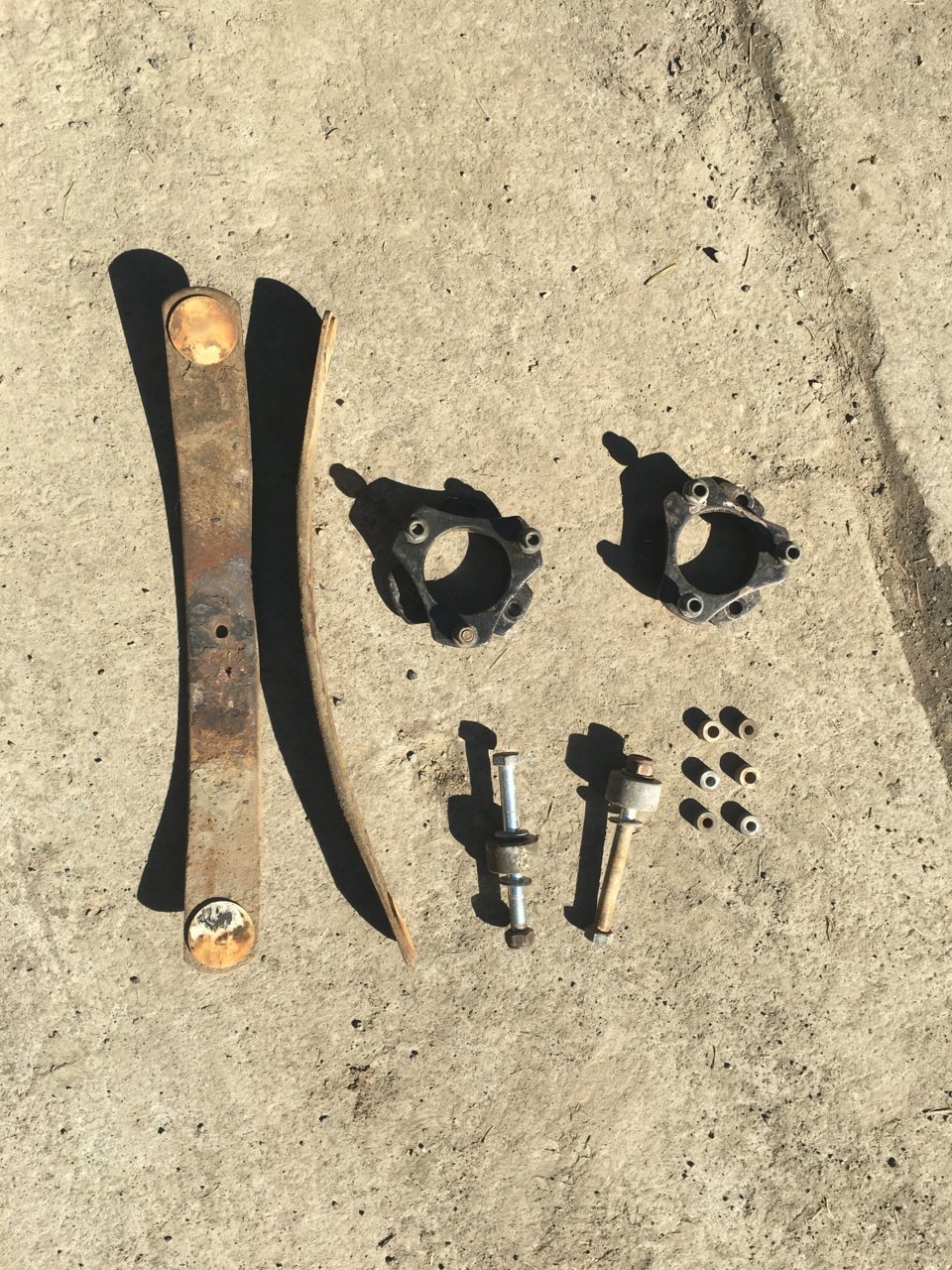

    I have a spacer lift, add a leaf, diff drop, and skid plate drop for sale if you’re interested in going that route. Came off a 2015 4wd with 26,000 miles $50 + shipping from Idaho.
