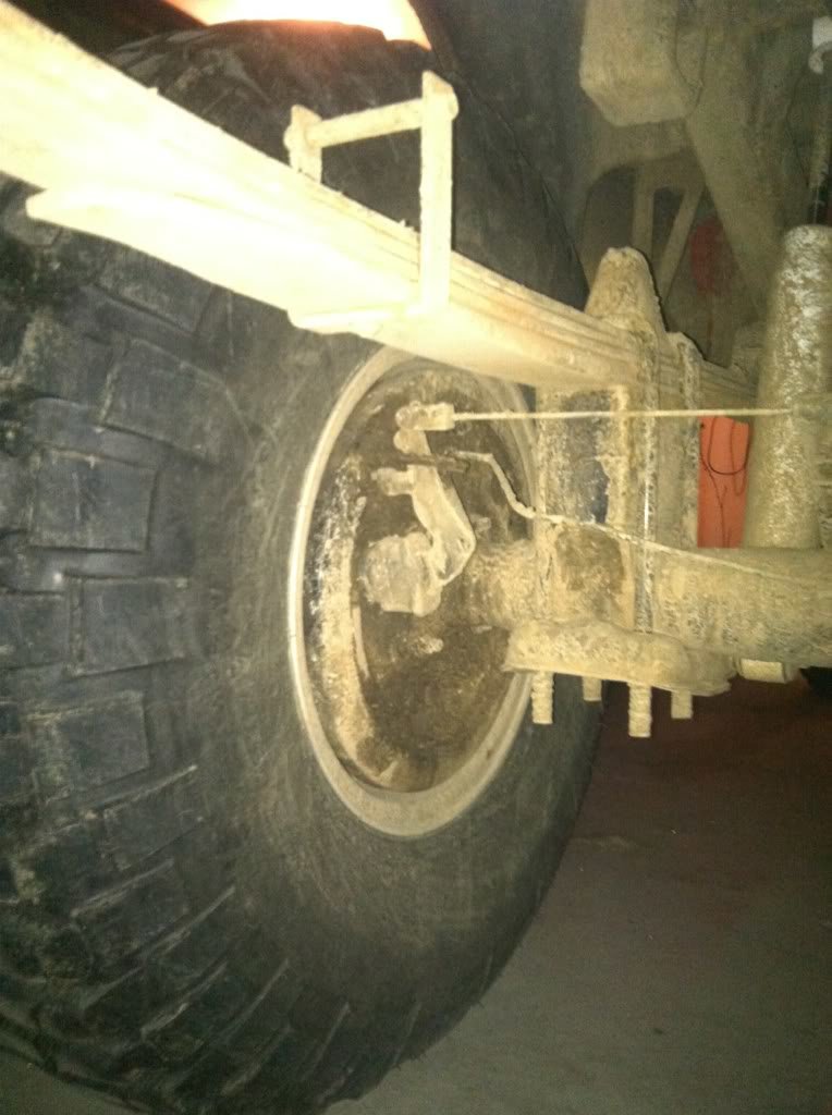

    Here's a pic of my rear 4" lift blocks. Haven't had a problem yet.
    FD6CB496-CC32-490C-B0C3-73B8C54E0FD4-145_14afd8bc252e51cd560b2fba2b934bc96b5b5928.jpg

    Maybe it's just photography playing tricks, but your leaves look nicely warped :D.... I'm stepping off my soap box now :rolleyes:
  11. Jan 1, 2013 at 1:42 PM

    They were like that long before I threw the blocks on. They are the 20 year old factory leaves...
    You are correct that the leaf packs in the rear are shot though. :D

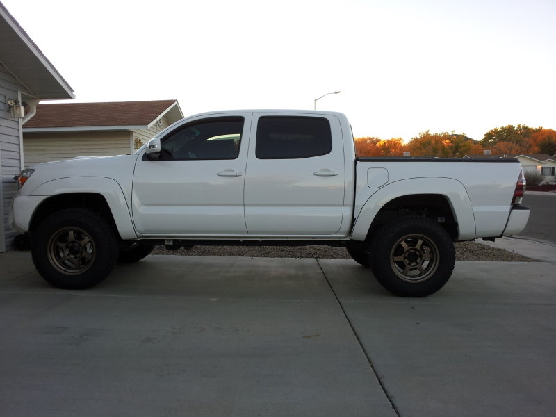

    I have the Toytec 1.5" AAL out back, with my 4 leaf pack (tsb). I went with the AAL because I was getting a camper, so I didnt want the back to sag. The back had a slight rake before, and is back to a stock looking rake now.
    The ride at 1.75 is great with the sport springs. Stiffer than stock, but doesnt have the front end dive when slowing down or cornering. I like it way better than the stock feel.

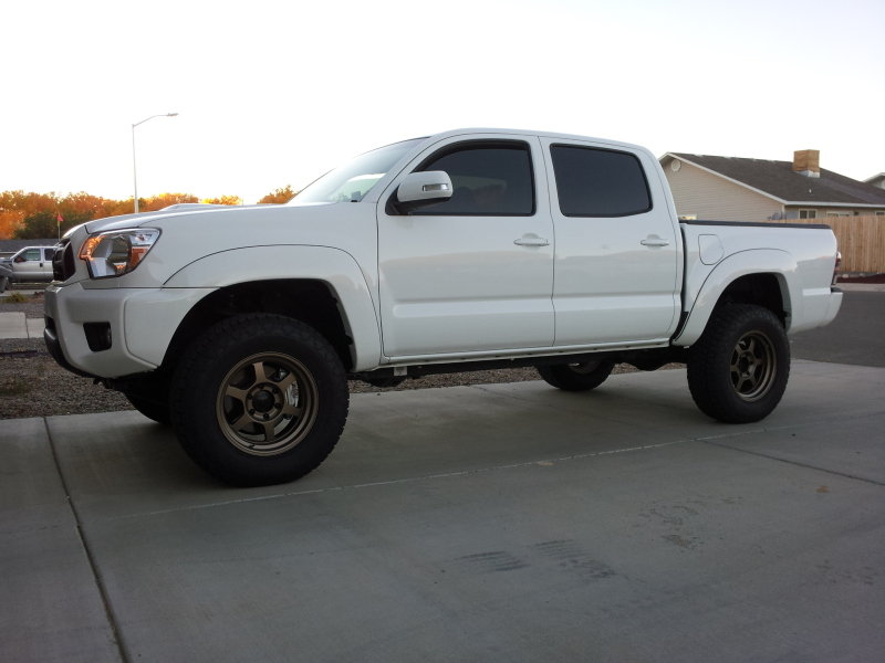

    Here is a picture, before the camper, right after installing the AAL. You can see the stock rake is returned.
    This shows a truck with the front at 1.75, with a 1" block...
    http://www.tacomaworld.com/forum/suspension/244155-1-inch-rear-block-2.html#post5857411
    Hope this helps!

    Yes this helps although it makes me wonder if I will want more than the tsb or more than an inch. It doesn't look like that much rake unless it's just the pic. Looks like it might be on a slight incline.
    Love the stance!
    Do you have any vibrations?

    It is kind of just the picture, here is a straight on side shot...
    I have a minor vibration from a stop if I accelerate kind of hard, but I also had it before, so I think it is unrelated.
