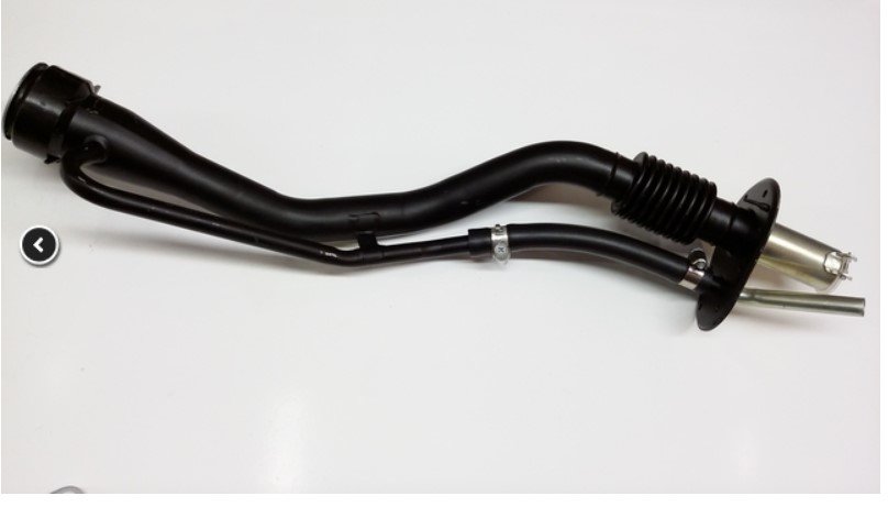

    The accordion part is actually pretty rigid; it seems to be mostly metal, not really rubberized. You can see the flap in this picture, it allows fuel in to the tank, its got a very weak spring on it, and I don't think it opens all the way so your cap could probably get stuck in it. . I'd say if the cap is stuck at the bend mid filler neck you could probably get it out like folks are suggesting, but if it's in the accordion or down by the flap I don't think you'll get it without removing the neck.

    Thanks for the picture. I felt tht 'hose' and it does feel pretty rigid, like it is not really a hose but something else.

    Looked again at mine. it has a sharp 90 degree turn to the tank. Probably because I have the 6 foot bed with my ext. cab. So that makes any kind of pulling this thing out with a vacuum or pickup tool nearly impossible. My camera won't make the turn to see farther in towards the tank.
