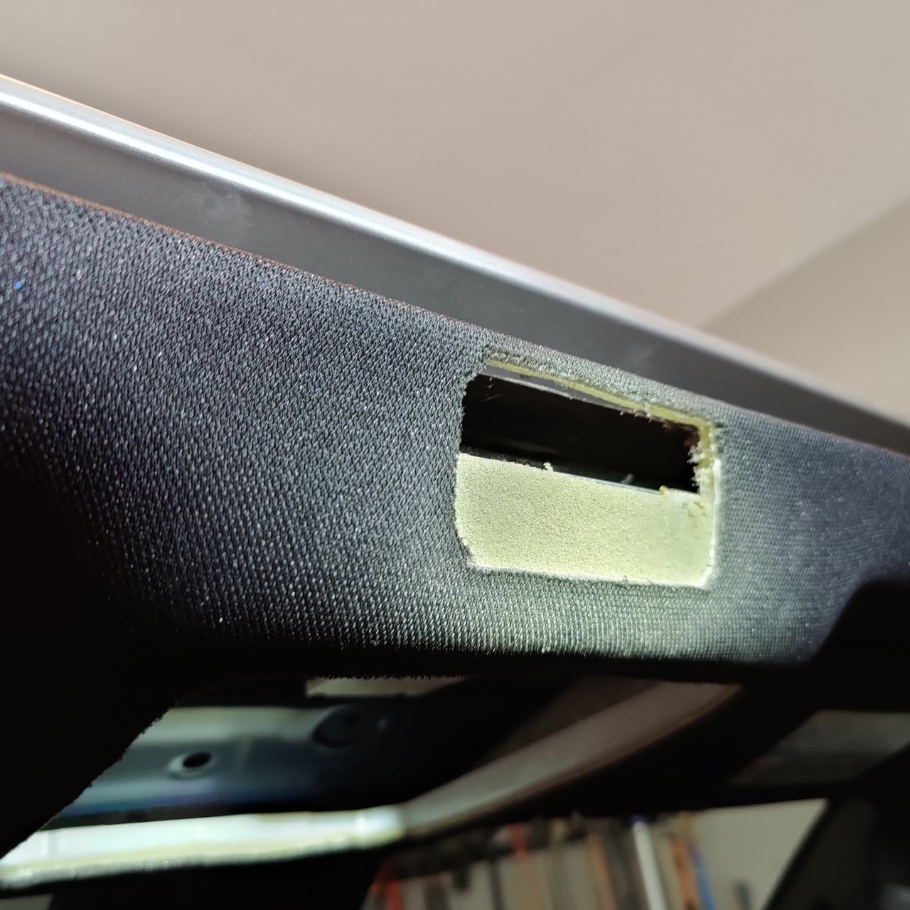

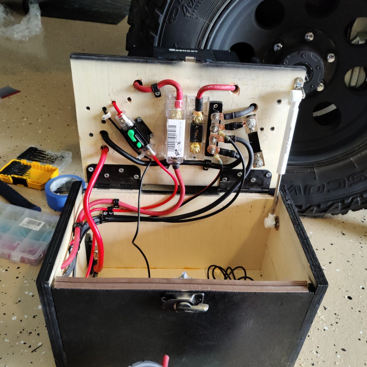

    Mounted the solar panel today. Had to cut 6 bolts down with a grinder and by some miracle I was able to thread the nuts on.
    Also built a battery box. It's both the crappiest and most over built battery box ever. Totally made for my needs and truck. Will be a very compact solar system.
    Pics once it's all together next week. Waiting on a few components

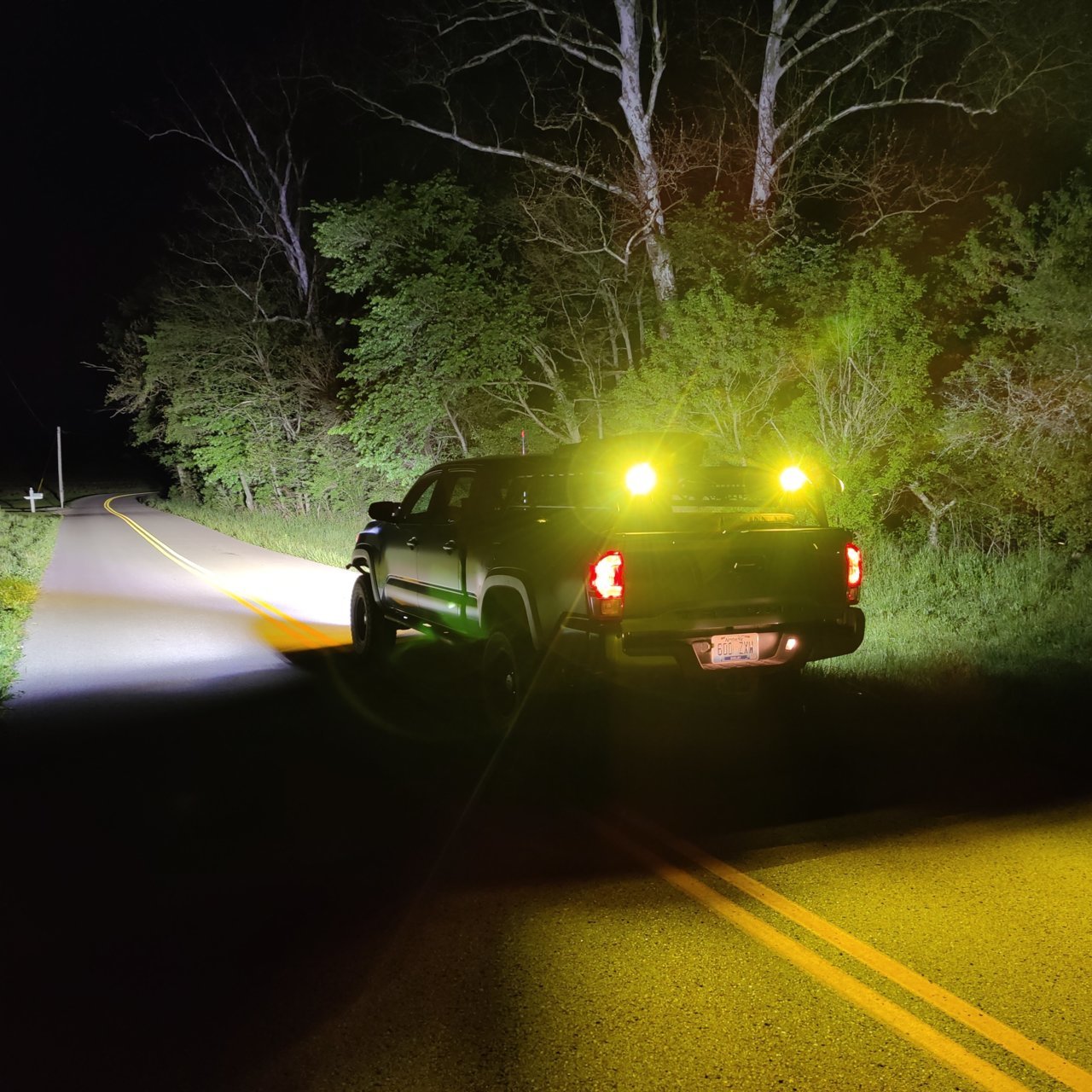

    Today, all of the lumens.
    20"light bar
    Ditch lights
    Chase/aux reverse lights
    Took it out for a night run down a very dark, twisty road. Very very impressed..
    Came across a mama fox and her kit, super cute little guy.

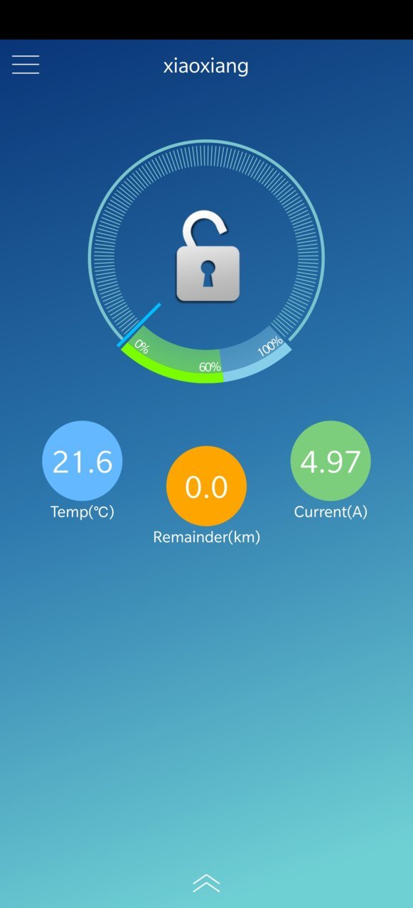

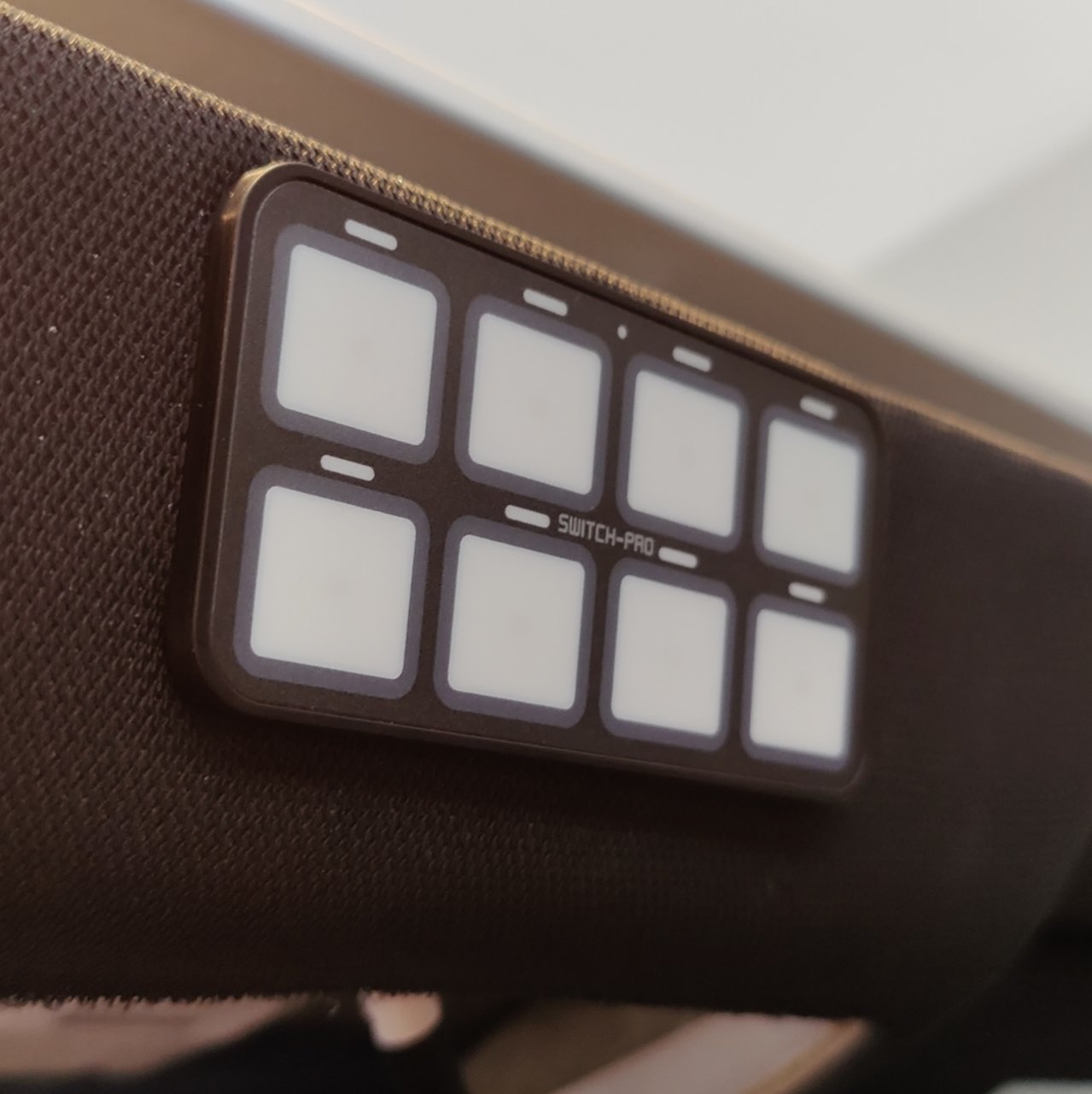

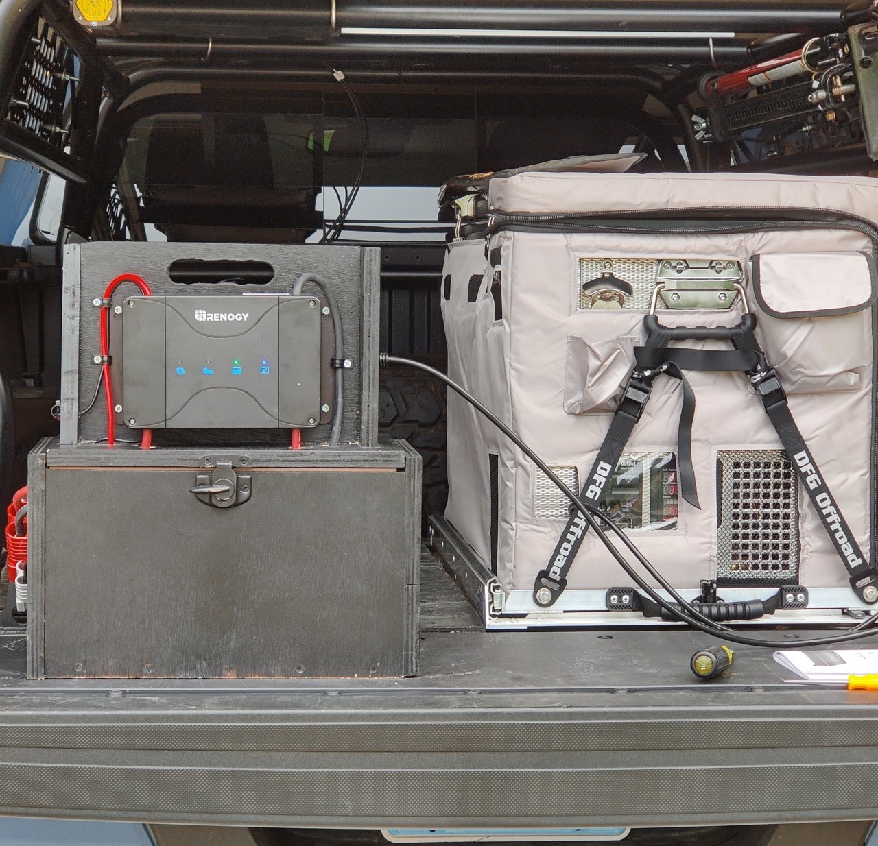

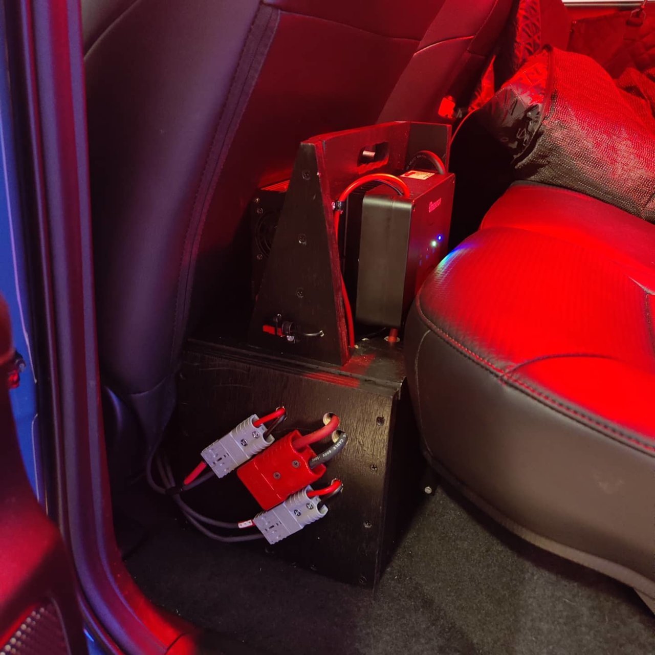

    Alright, for those who are following on Instagram (I can't believe I just typed that....)
    Solar box build:
    - independent of truck, unless alternator has charged truck battery, then it accepts charge
    - Renogy 50A DC-DC MPPT charge controller
    - 100W panel
    - 100ah DIY LiFePO4 battery
    - 1200W inverter
    Which runs...
    - 65L Snomaster fridge on a slide. Very bougie.
    - other stuff that's plugged in

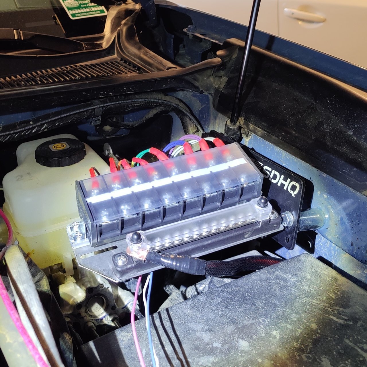

    Upgrades to truck system:
    - switchpro 9100
    - ditch lights (Rigid XL Pro, driving diffused)
    - light bar (rigid SR Pro driving)
    - chase light/aux reverse (Baja S1 wide corning, amber)
    - work lights (Baja rock lights on bed cage)
