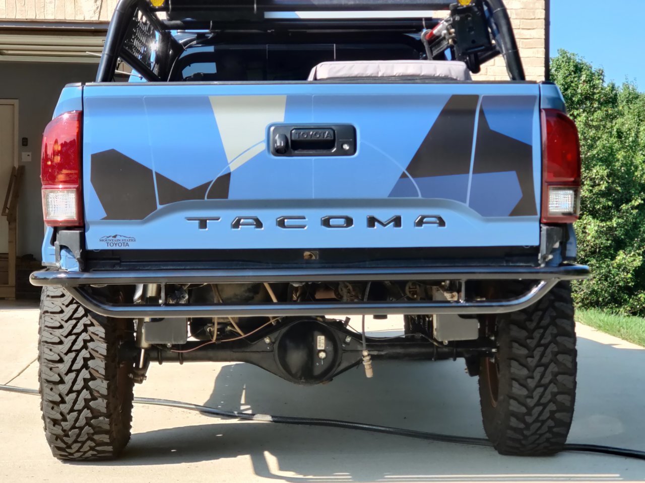

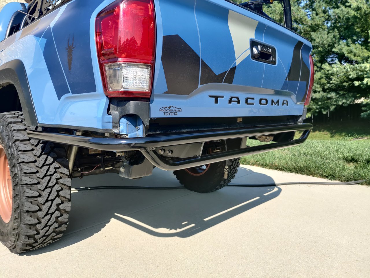

    85% complete. Still need a a receiver, gussets and side supports (and better paint job...) but this will do for Rush :thumbsup:
    (I know it's a bit crooked, not a lot of fun to install singled handed...)

    Big thanks to @Bandido for the garage space, bender usage/assistance, welding and delicious tacos.

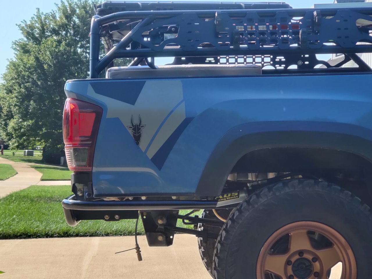

    You consider little kickers where it wraps the bed? A few of us have deleted tail lights and gained basketball size dents when the rear suddenly kicks sideways

    That's on the "stage 2" list. Def considering, esp with how long my truck it. Good news is, i'm hyper aware of the length and really pay attention to it as much as the circumstances allow.
    Stage 2:
    - Receiver/gussets
    - side supports/gussets
    - additional rear bar (I need another ~2" sticking out (or so @presta24 mom says....) to truly protect the tailgate)
    - bedside protection
    - 1/8" plate between the frame plates for: trailer adapter, backup sensors, lights, air, etc
    - figure out BSM mounting, really hoping I can squeeze it below the lights
    EDIT: also portable band saw for cutting all this shit. Somehow we cut everything with a bunch of half-worn cutoff discs. This includes cutting a bunch of 2.5 x 0.25" square for a bender base.
