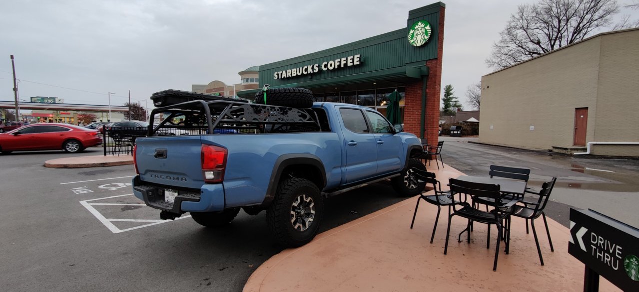

    Also going to do some final Christmas shopping. I'll need to apply some tire shine and re-mount the shovel and traction boards to really show the mall crowd what's up.

    Straight dominated the Starbucks parking lot.

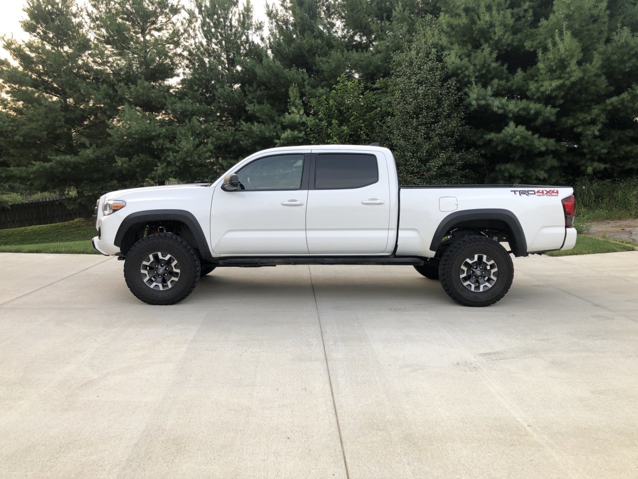

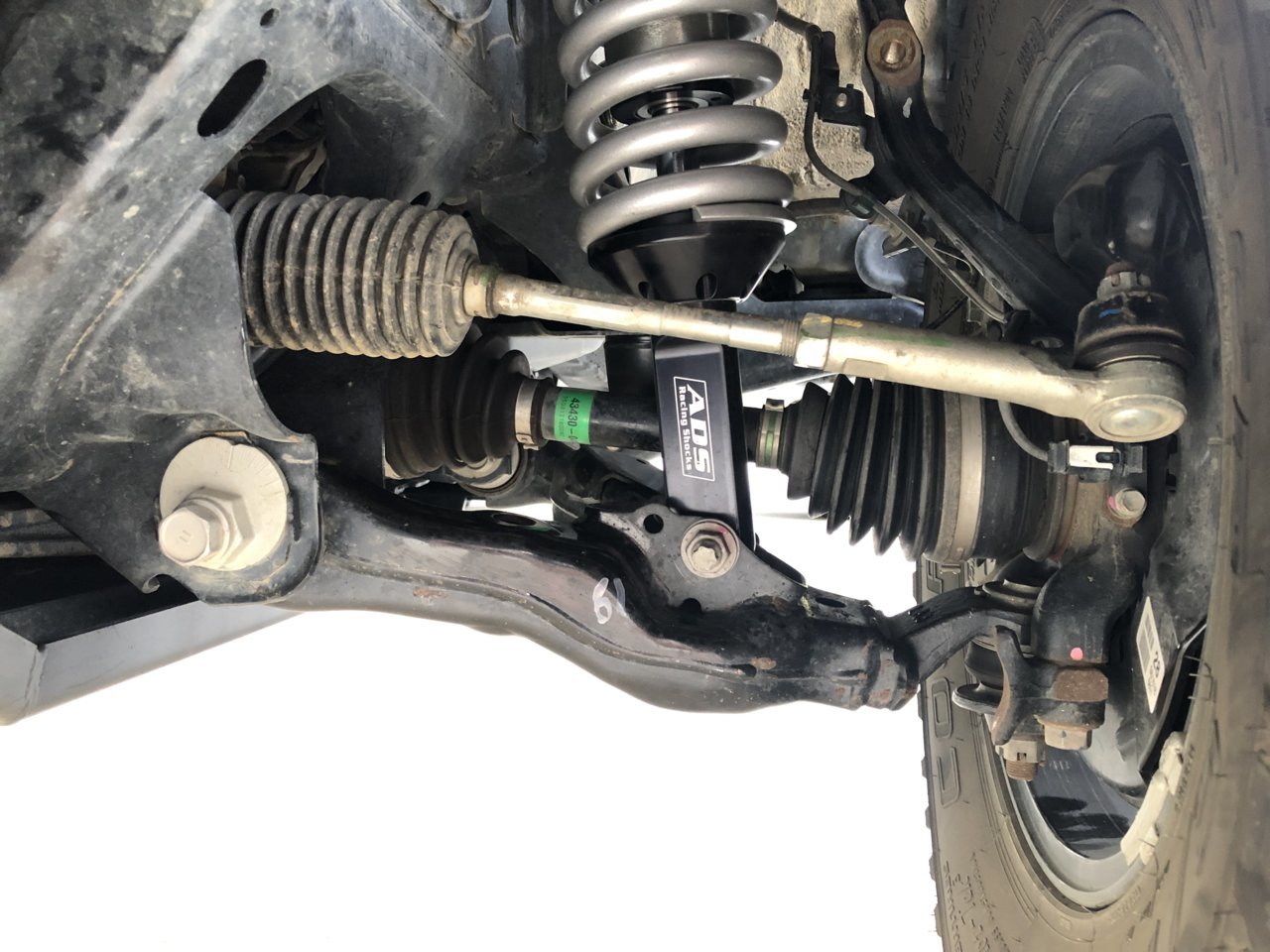

    Here are the measurements on the old truck. No suspension adjustments since, only difference is the new truck and bumper/winch.
    Of course, I have the bed cage in the back which is compressing the rear a fraction more and taking a little load off the front

    Perfect! I’m currently sitting at 22.5 hub to fender with OME 888 coils and Bili 5100s. I am hoping to keep that when I install my identical coil overs. I’m going to use your measurements as my starting point. Even if I have to dial it back some that’ll be much easier then trying to go the other way. Thanks for your time and help! It has saved me and hopefully some others stress of trying to get it right.
