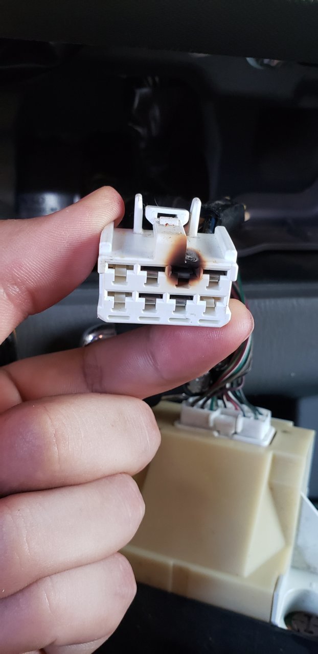

    I just replaced the resistor and the burnt connector entirely. the AC works on all settings EXCEPT high. What should I do first? Also, It seems there is a small leak on the low-pressure ac line on the passenger side. Right on the connection tube.

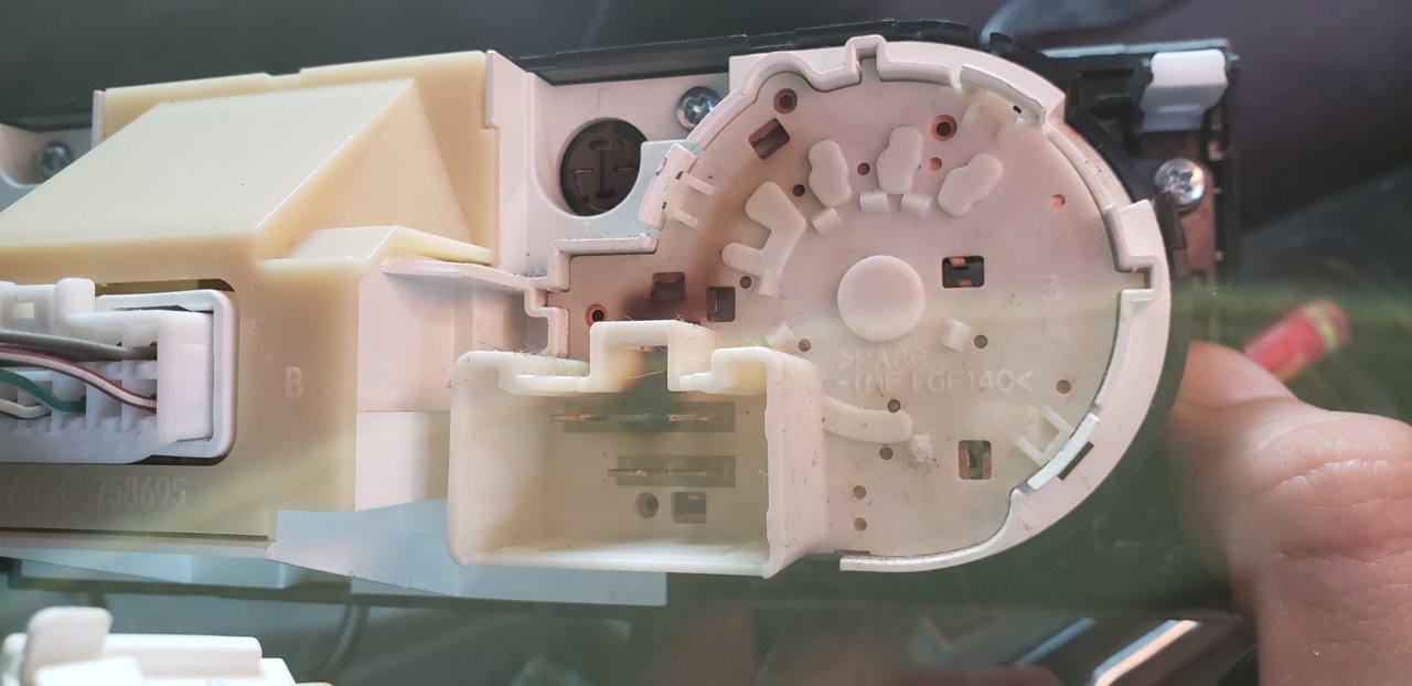

    Use a plastic knife to pop out the climate control panel. Unplug the switch connector. You will probably see the connector and the switch burnt.

    If they are both burnt I'm assuming the only way to fix it would be to just find a replacement for the connector and the switch?

    Buy a used switch and a new connector body and 1 new pigtail.
