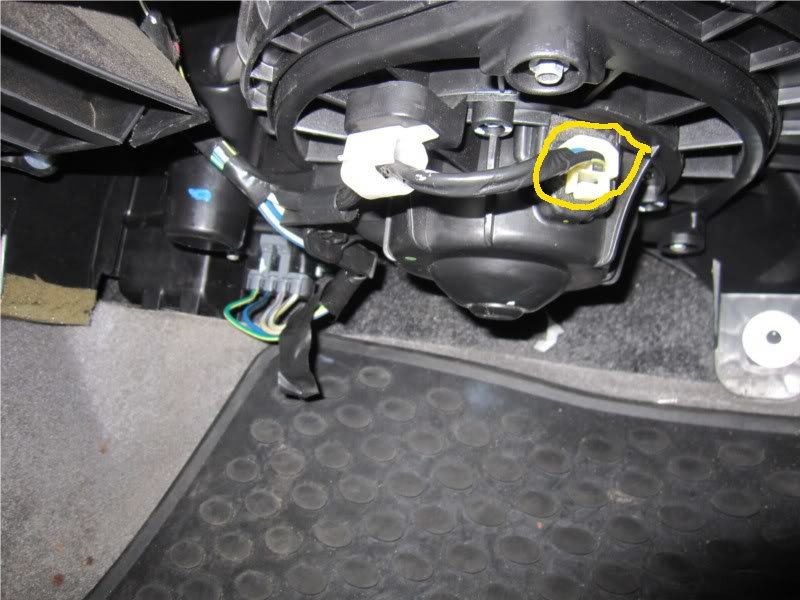

    Hey Tacoma world again! Was wondering where the heck do you find the blower fan plug without buying a new blower?

    You need to replace the terminals in the plug as they are the source for the heat ( loose connection acting as a heater ). You will need the wires and the connector itself. If it got good and hot the wires are probably damaged anyway. Cut off the old and splice in the new.

    Just my $.02, not sure in these posts if the blower motor was replaced but if I find any blower connector wiring that is melted and needs replacing, I would highly recommend replacing the blower motor too. A failing motor can draw more current and cause the wires to operate hot and melt the connector.

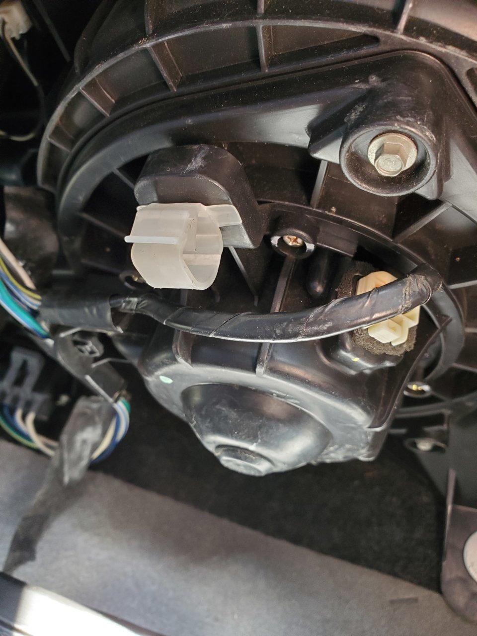

    20210314_131924.jpg Sorry to bump an old thread, but for the life of me I can't get the plug out of my blower motor. It has a little play if I push in and pull out but it doesn't matter how hard I push the release tab it doesn't want to pull out. Any thoughts? Anyone else have difficulty removing their plug? I kind of wonder if my blower motor is a cheap replacement.

    Try harder. Not pulling, but the release. Use a small tool to push if needed.

    I second the above. Your finger won’t do the trick on old connectors. Depress the tab with needle nose pliers or a pen or something and pull at same time
