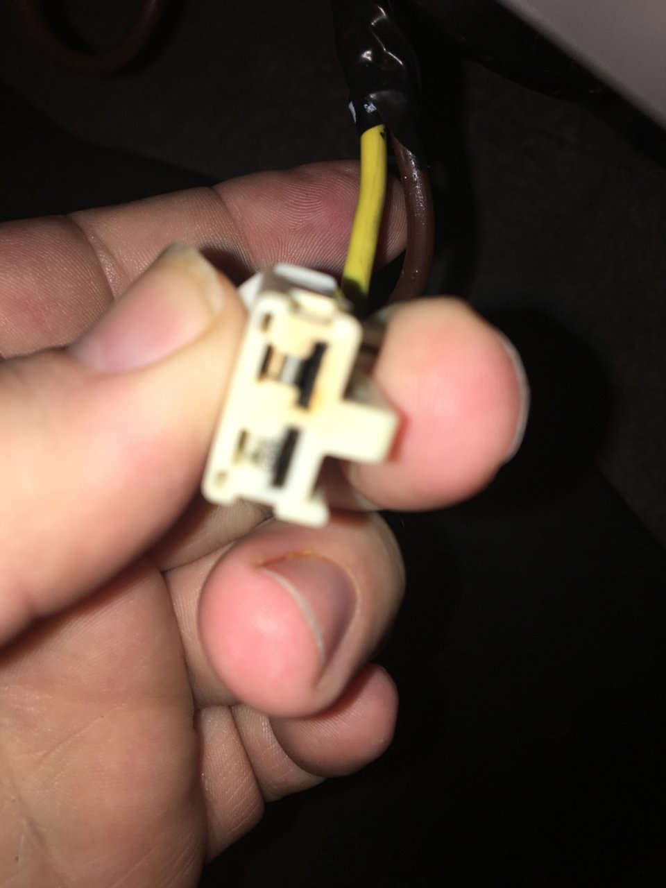

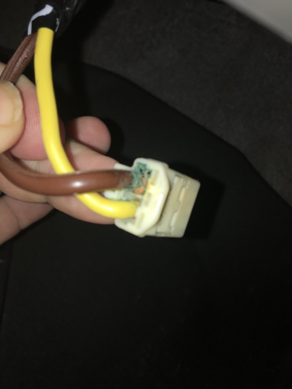

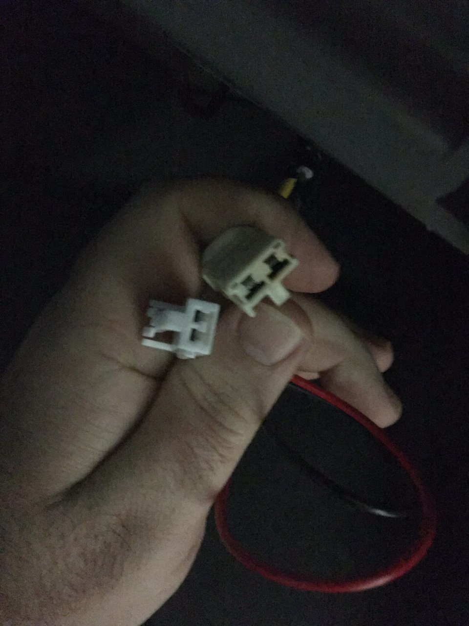

    Yesterday while driving and trying to figure out why I still keep getting a p2757 code after having my transmission fixed my blower stopped working. I checked the fuses then found this:E0555F6B-7D68-4D03-A199-C76D49A7A477.jpg if I press on the brown wire the motor starts to run again. I’m hoping I can just replace this section but I’m a little scratchy on the electrical stuff. From what I’ve read on here there are multiple connection styles. Can I order this section then just splice it in to the old wiring? It’s kind of a mess under there.89562D08-52F3-4CFD-A6F9-FC4D3A996708.jpg

    Thanks. I’m goin for it.

    Those butt connectors they give you to splice to your wiring work ok IF you have right tool to crimp them.
  6. Feb 28, 2021 at 9:00 AM
    Knute
    Knute Well-Known Member
    Aug 13, 2020
    #337515
    5,148
    '06 4.0L Tacoma TRD Sport
    Stock, 4WD, Access Cab, White,
    Suggest toss out the Butt connectors.
    Solder (rosin core) and heat shrink. Makes a strong connection.
    tacotoe and po35042 like this.
  7. Feb 28, 2021 at 9:09 AM
    diabetiktaco
    diabetiktaco Instalander
    Sep 5, 2016
    #196480
    5,738
    Eric
    New Jersey
    2022 GX460
    Yeah, just get the kit. Butt connectors will work fine. Just tuck everything away neatly. It's a bitch to get to, but not horrible. Should take 20 mins max.

    I think it’s Delphi that makes a replacement connector. Going forward, be sure that all connections are tight, a loose connection makes heat! I had one go bad on my ‘06 years back.

    Yes it is Delphi. In fact the entire HVAC system is a General Motors special. I have had to access the GM electrical catalogs to find replacement connectors and terminals for several things related to the HVAC.

    Gotta love Amazon. Came from a Toyota dealership in Ohio.
