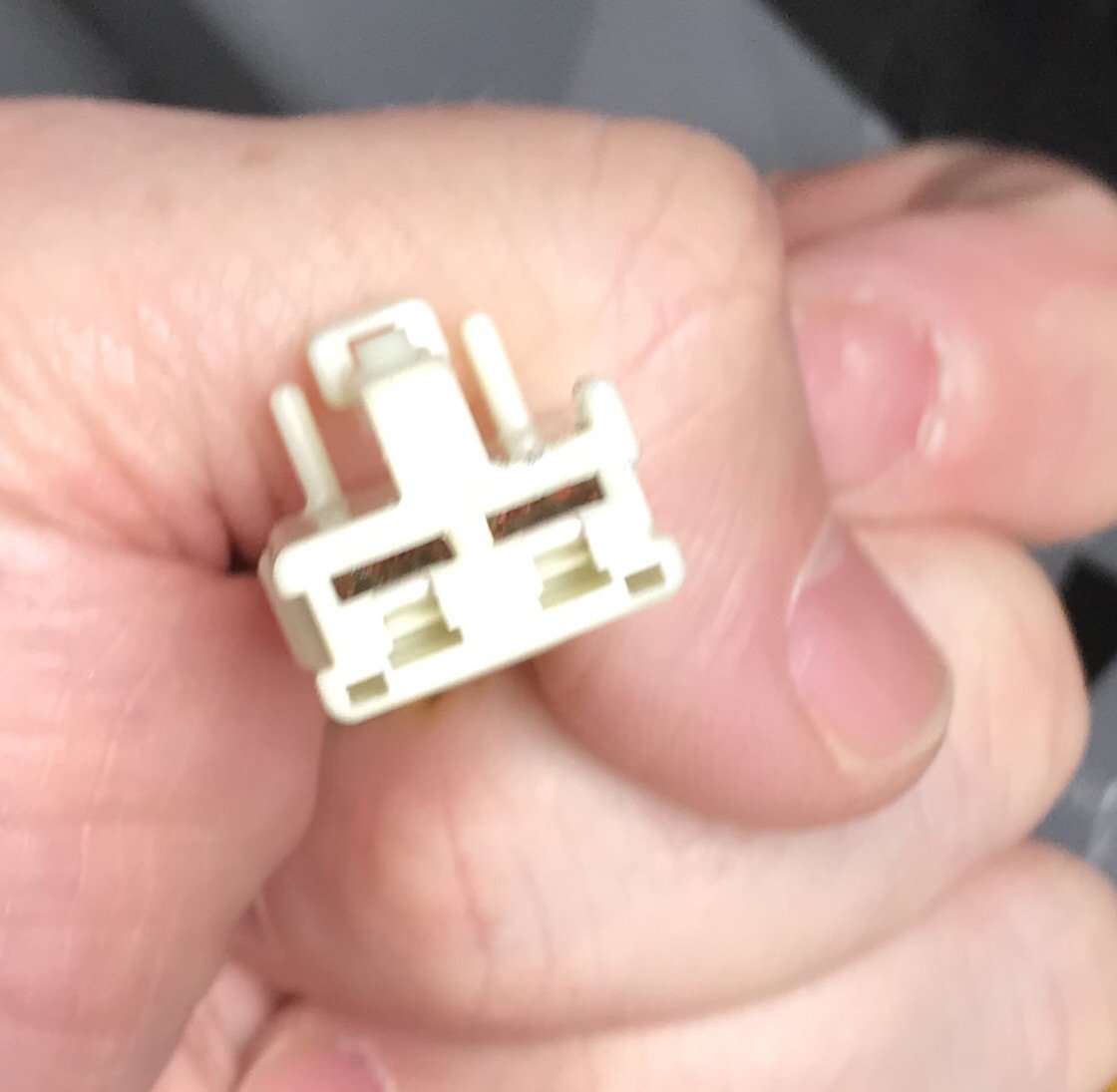

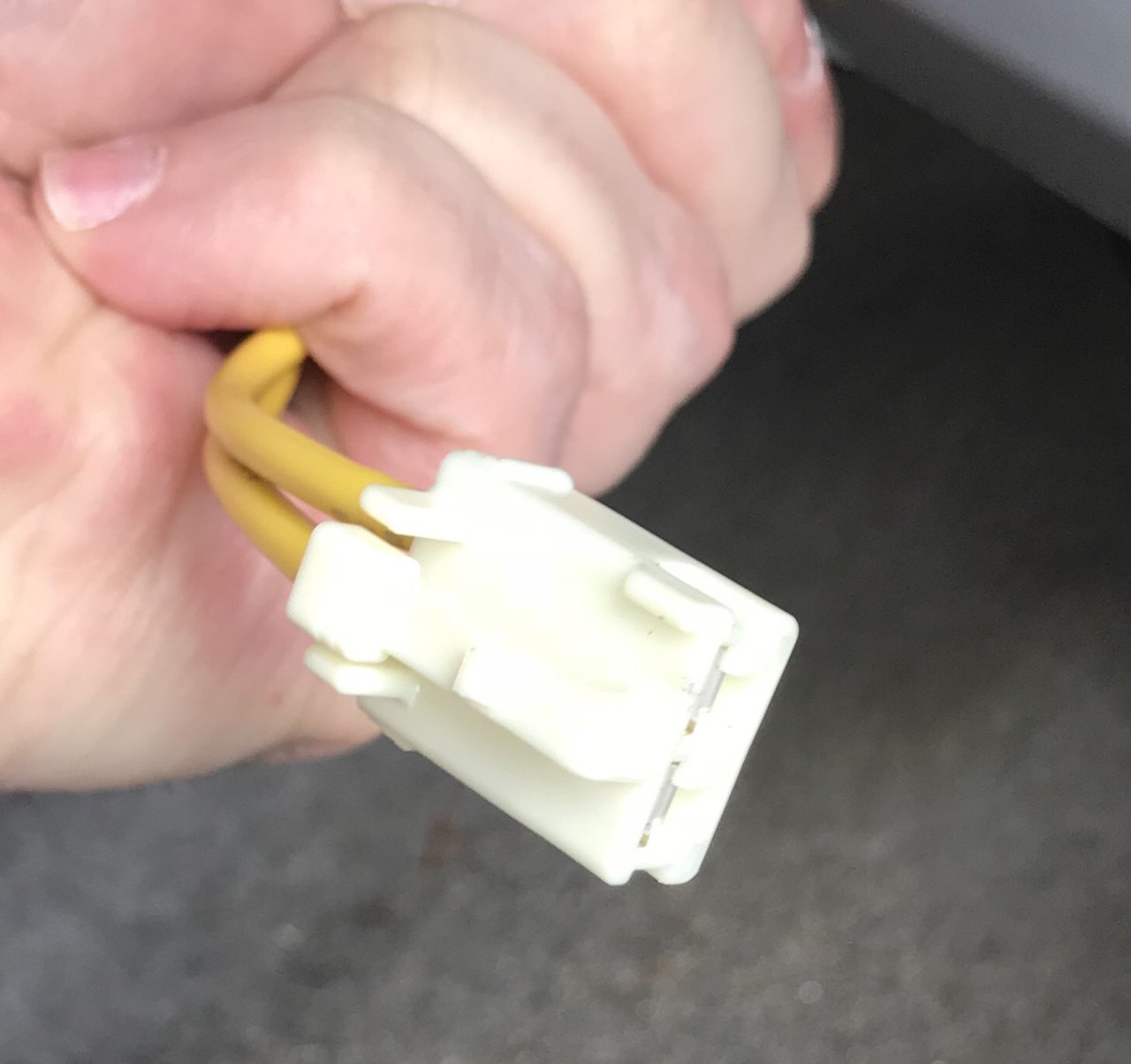

    Ok, I have read a lot of forums on this topic and nobody seems to be able to find the part numbers for the small molex blower motor plug and replacement wiring.
    After a lot of research and after going to a repair shop and being told I may need a whole new wiring harness I found the parts on my own.
    You will need 3 parts. The plug itself, part number 90980-10916
    and 2 wires with the connectors that go into the plug.
    So order 2 wires, part number 82998-12380.
    I ordered mine at www.toyotapartszone.com. The order information is below.
    82998-12380 TERMINAL, REPAIR W/W 2 $5.16
    90980-10916 HOUSING, CONNECTOR F 1 $5.25
    Also see photos of the parts attached.

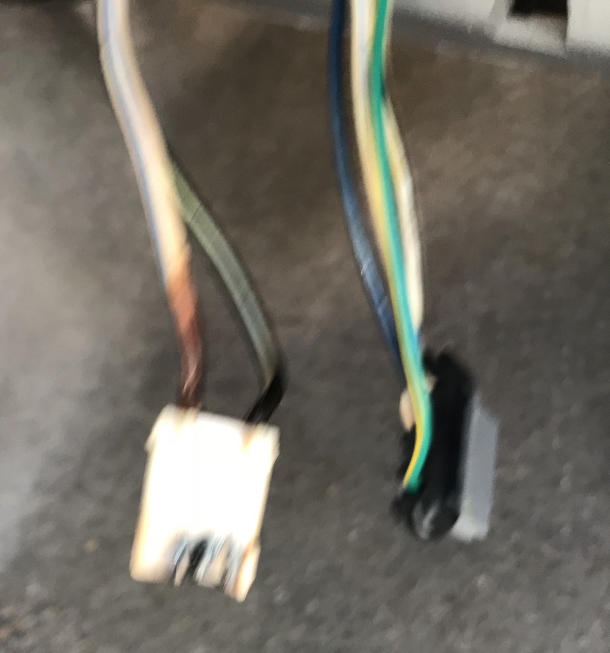

    I had the same issue with my 2010 Tacoma. Blower motor stopped working so I was replacing it and discovered a burnt plug on the blower motor. I looked for a replacement part for over a week before I discovered this site. I ordered the components to build a new plug and after reading decided to replace the resistor as well. Has worked great since the repair.
