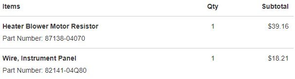

    I recently fixed my blower motor after it would intermittently run. The problem ended up being the power connector to the blower motor itself had burned. Solution is to cut and splice a new connector but the new connectors have a different connection type (hopefully to fix the initial burnt plug issues) so you will have to replace the resistor on the other end of it as well. Took me less than 30 minutes to splice this new stuff in.
    Ordered these 3 things:
