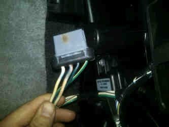

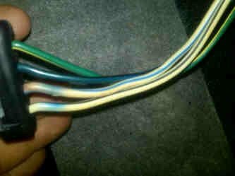

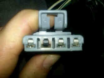

    I've been having issues with my AC/heat only working on high, and not even operating on low, med, or med-high in my 06 PreRunner. After doing research, I found it was a problem with blower motor resistor. After taking it out, I noticed the wiring connecting to the resistor was burnt. I've read that many other people with Tacomas blow through these resistors quickly. Has anyone else with problems concerning the blower motor noticed this issue with the wiring in their Taco?! :confused:

    The terminal that is burnt is the High Speed setting.

    That's a direct line from the 50A heater fuse, through the heater relay, to the motor, through the switch and finally to ground. The only thing I could think of is extended use on the high setting? Maybe the blower motor is going bad?
    I had a Pontiac that would eat them like candy.
    Here is the electrical print

    If your filter is clogged, the blower motor will have to work harder. It will draw more amps and cause that. It will also burn out your resistors.
