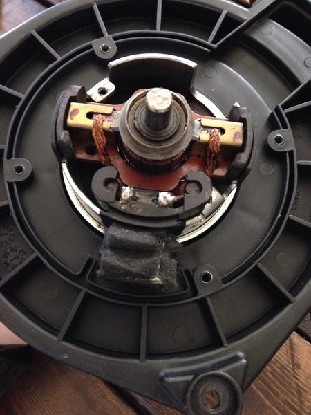

    Judging by this picture the brush holder is upside down.... Back to the drawing board

    Whoops!

    Swapped the brushes around and viola! Problem solved. I guess I have been looking at it too long, needed to step back and see it from a new angle haha :rolleyes::anonymous::tinfoilhat:
