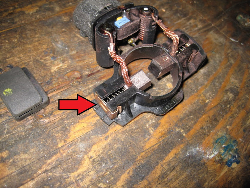

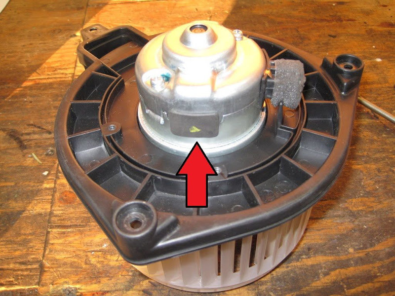

    I too had the crickets/squeaking blower motor on low speed in my 2010 DC. Started with about 10K miles on the truck. Had the dealer swap the motor out, was quiet for a few thousand miles but then came back exactly as the original - squeaking on low speed. As I was reading on this forum I see several people continue to have problems even with the latest revised parts. Thanks to the photos/description posted at the start of this thread I figured why not just fix it myself rather than get the dealer to install another one that would make noise a few months later.
    I took the motor out, cleaned the brushes out with electric motor spray, removed the fan from the shaft. Pulled the armature and greased both bushings very well with good synthetic grease. Re-assembled everything and the motor was nice and quiet, but this lasted only about a week and the chirping started coming back. I couldn't believe it. So now I'm thinking WTH now??? :mad:
    Turned the key on and left the blower motor on low, while making the chirping sound. Reached underneath and pulled the screws loose that hold the plastic cap over the end of the motor, but left the motor installed in it's normal place. Louder than ever. During my investigation, I found something a little different that I haven't seen noted yet in this thread. I found that if I pressed hard on the two 1/2" x 1" black rubber inserts on the motor case, the noise stopped instantly. Hmmm. So I pulled the motor out and took a look. The rubber inserts are directly behind the metal clips/springs of the brushes. As I was fiddling with it I could detect a faint high pitched sound if I moved the metal clip a little that the brush spring is mounted to. I am thinking the metal to plastic interface at this point might be the source of the chirping. I put a light coating of grease on the brush springs, and on the inside and outside of the metal clips and slapped it all back together. Silence again. It's been over a week now and things are very quiet.
    I'll report back again if the cure isn't permanent but thought I would share in case it helps someone else with this problem. :cool:
    Blower motor - note the black rubber inserts
    Greased the copper colored metal clips where they contact the plastic housing for the brushes, and put a light coat on the springs too to dampen any high frequency vibrations there. (DONT put grease on the brushes). Also put a dab of grease on the inside of the rubber insert for good measure. The purpose of the rubber inserts is to suspend the plastic brush housing/assembly with no hard mechanical connection to the motor case, providing electrical and mechanical isolation.
    9/3/2011 UPDATE: Everything is still completely quiet. Maybe I'm lucky, but it's been 4 months and the fix I did in the photos above seems to be working. Will check back again in a few months. This was an easy fix and saved me a trip to the dealer to install yet another new motor that would just end up chirping again.

    *Heads up * my problem was finding the spring when it popped out lol easiest way is to just pull back the springs and lift it up that assembly as a whole.
    So far the only noise I hear is faint rotating. thank you very much for the write up.

    I noticed from the photo above that the part that carries the brushes definitely looks quite different than mine, which is a 2010. Apparently there have been some changes to the internals along the way. Your sig says 2006, is that the original?
