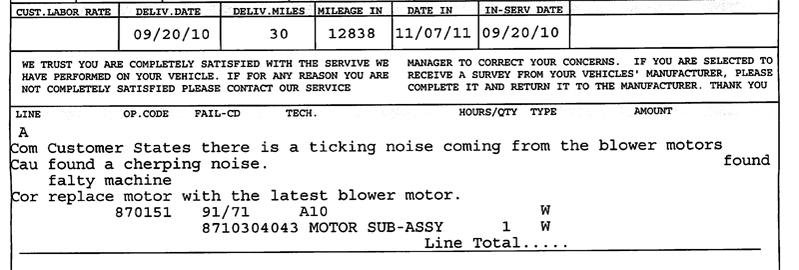

    Got the new blower motor installed today per the Oct 2011 TSB. Part Number 8710304043. No more ticks. All speeds sound quieter in general too.

    Does anyone have a copy of the new TSB T-SB-0162-11? Does anyone have a copy or PDF of this?
    I had been using the other one T-SB 0092-10. I already had the "new" blower motor installed, and it lasted about 6 months and is now chirping along. Is the new fan part number the same as the one I already have, 87103-04043? If so, this would be extremely disappointing!
    I'll have to try the aftermarket one, maybe from Autozone, although it seems that it's just a rebranded TYC motor with a warranty. And either way it looks like I'm going to end up replacing my fan once a year. What a bummer! Hope replacing it is easy to do...

    got the newer motor installed today. quiet as can be, but then again so was my last TSB blower motor
