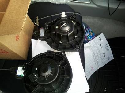

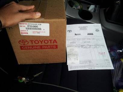

    So i finally got fed up of kick starting my blower everytime i needed ac I went to the dealership and got Part number used was 87103-04043: the cool thing is the dealer was nice enough to give me employe discount. i'll show you the receipt later.
    old vs new similar didn't see any new changes...lol but right from the start it blew nice & quiet finally...
    got it for $130. ish instead of $180

    My biggest issue was the motor not starting up without me reaching in and spinning the blades... I put the new one in and i heard of few chirps. But fuck it ...it works lol
