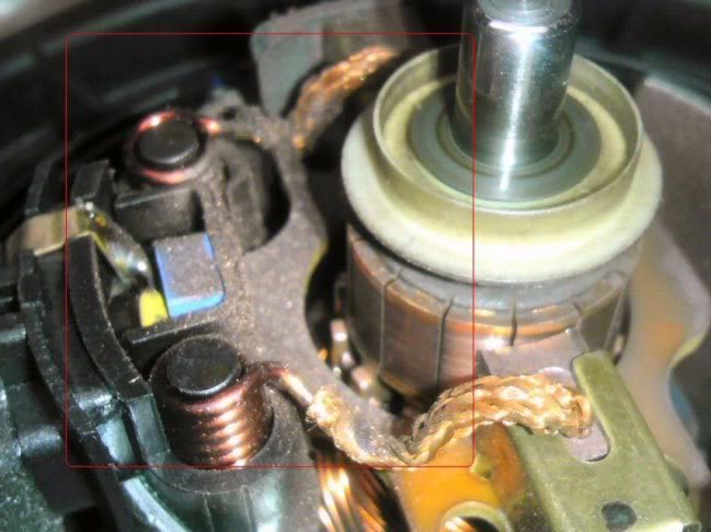

    I have the new blower installed for a few months now so I took apart the original blower last night and this is what I found. The area inside the red square is covered in copper dust, the commutator is grooved and the brushes are not equal in length. I don't think oiling it would've helped.
