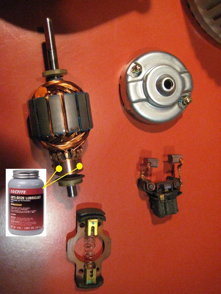

    For you guys that have an expired warranty would you mind testing this "fix"?
    It's easy just pull the cap off the back of the motor and put 2 small dots of Copper Anti-seize on the rotor, Loctite sells 1oz tubes for $5 p/n 37533. You don't have to disassemble the entire unit just the cap.
    If you notice the rotor has recessed slots that help retain the lubricant and keep it quiet over time. I've been running this fix for over a year with zero ticks/squeaks or problems. I just need a few people to test it out before I can say it's a solid fix, thanks.

    Just fixed mine today by adjusting the two screws that held the motor. Took me 10 minutes and no more tick. If it happens again, I'll go with the anit-sieze.

    After about 30 minutes, the trick w/ the screw did not work. Took the blower apart and put some grease on it and so far, no tick. Hopefully that fixed it.

    Cool...thanks for trying the anti-seize hopefully that damn noise stays away like mine did.

    I've never seen the Copper Anti-Seize? I use the grey/silver anti-seize on everything. What is the difference?
