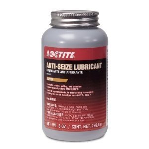

    The Copper Anti-seize is for higher temp applications. Also, the Silver Anti-seize is not recommended for high speed moving parts. Since the motor is always in motion the Copper version seems like a better option.

    I used regular anti seize, and greased everything and the noise went away.... For about 2 weeks.
    Now its louder than ever, I'm gonna give the copper anti seize a try.

    The anit-sieze lasted all of one day. May work for others, but not myself. It was actually louder than before I did it. Quiet loud even on the 3rd setting.
    I took apart again, for the third time, cleaned it up again and put grease on it like the original post says. So far so good. Hopefully it stays. You would think that Toyota would take care of this issue after so many problems with a blower motor.
