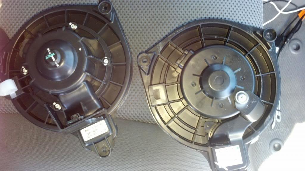

    Just installed the 043 Toyota blower and holy moly, the silence is amazing. Speaking as someone who almost always has way more problems than necessary when fixing something myself, this was super easy. Who knew there was a 5.5mm socket! Even the wire connector came off easily.
    Well worth doing. Hoping this is a permanent solution.

    I tried the oil and it worked for a minute. I fixed mine by adjusting the screws without removing the motor. I removed the plastic housing only and adjusted the screws until no squeak. tightened front and loosened the back. Been going for months now. I actually forgot how much of a PITA that sound was. Gone now.

    No ticking or noises since the switch! Seems to have done the trick for me.

    MJS,
    Try adjusting the screws on the metal end cap with the motor running on low. Worked for me. Unplug motor with truck off then remove plastic cap only, do not remove motor. Plug motor in then start truck, set to low and adjust screws until sound goes away.
