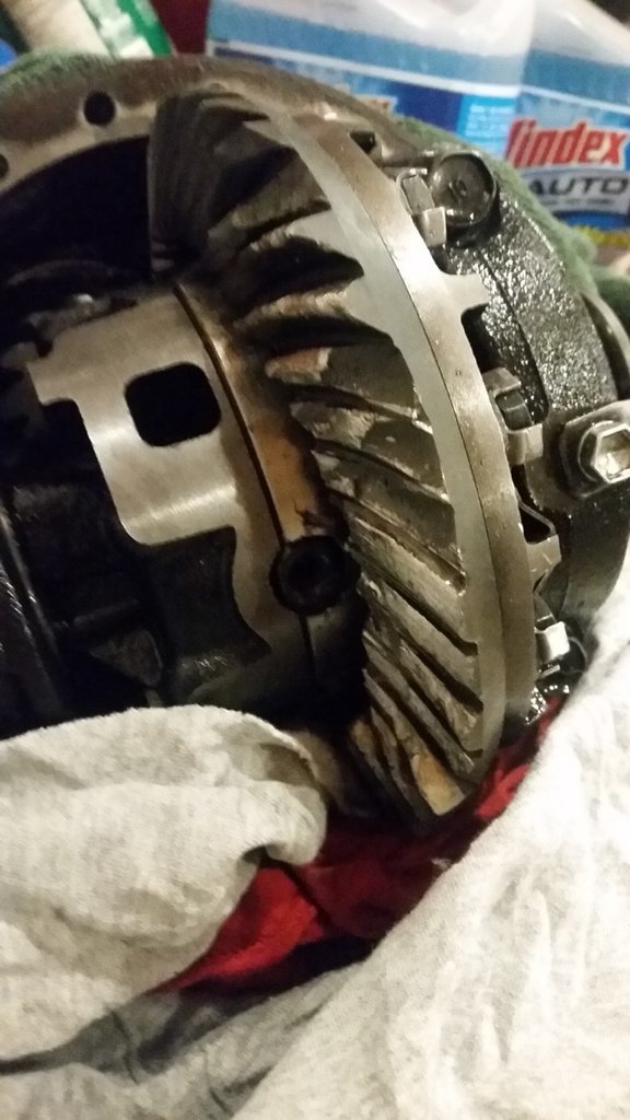

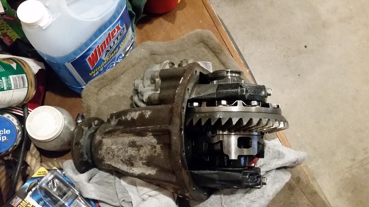

    just blew my second diff.. just wondering if theres something better thats not crazy amount of money .. just need the complete carrier assembly.. axle shafts r fine. thanks!thumbnail_20171002_165715.jpgthumbnail_20171001_193327.jpg

    First one blew stuck in clay and this one blew cause I gave too much throttle in 2wd over big log and log shot out and tires were spinning when they hit the ground
