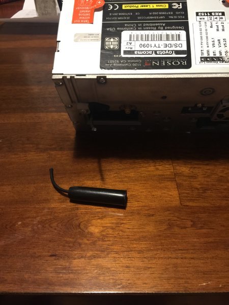

    also while im in here how exactly do i fix this?
    it was damaged when i got it and than broke while installing.
    its the radio antenna
  5. Sep 23, 2016 at 4:15 AM
    DukesTaco
    DukesTaco Well-Known Member
    Feb 19, 2015
    #149086
    5,673
    AZ
    2nd Gen Double cab Pre Runner
    Send it back and get a new one
  6. Sep 23, 2016 at 4:23 AM
    TRD2010SpeedwayBlue
    TRD2010SpeedwayBlue [OP] Well-Known Member
    Sep 12, 2015
    #164039
    1,809
    Brandon
    2010 Speedway Blue TRD Offroad
    thats what im in the process of doing just wasnt sure if it could simply be soldered together.
  7. Sep 23, 2016 at 8:54 AM
    timothom
    timothom Well-Known Member
    Aug 24, 2014
    #136879
    863
    2014 Tacoma Access cab sr5
    Kenwood DMX7705S PrecisionPower Phantom 900.4 Alpine type-r 8" Image Dyanmics CXS64.2
    Na, that wire is coax, an inner core with braided shielding around it. Hard to repair coax wires...
  8. Sep 23, 2016 at 8:56 AM
    TRD2010SpeedwayBlue
    Sep 12, 2015
    #164039
    1,809
    Brandon
    yeah thats what i figured.
    selller told me can exchabge no problem
    thanw as all oh thats not my wrong doing.
    im like well it was damaged when i recieved it..... and he was like oh can you call rosen and see if they can sell you a new antenna and i will pay. im like nope its hardwired in and im not taking the radio apart....
    agreed to let me send it back im waiting on a lable from him
