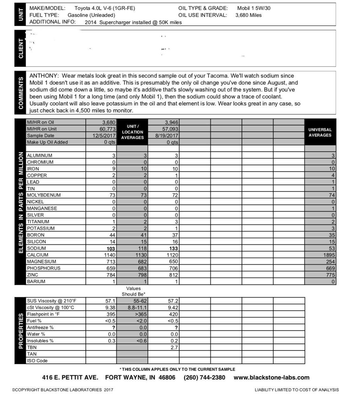

    What exactly does the black stone test tell you? Would it tell me if the oil I’m using is doing good ? Lol

    This is what a blackstone test will show you.A3A9D69C-02F3-4AD6-95BF-068E942BA781.jpg
    So the very left row is the most recent sample, 3rd row is my previous sample, the 2nd row is the average between those. Then you compare it to the far right which is universal averages blackstone has for all the samples they get for the 1GR-FE motor.
    They will tell you how long they think you can safely run the oil based on the additives it still has in it, so you can get the most out of your oil.

    As seen below it shows you the numbers for everything in your oil that could help detect something before it gets obvious/expensive. It may say something about the type of oil you're using, but that's a good question for them. I still use 5w-30.
