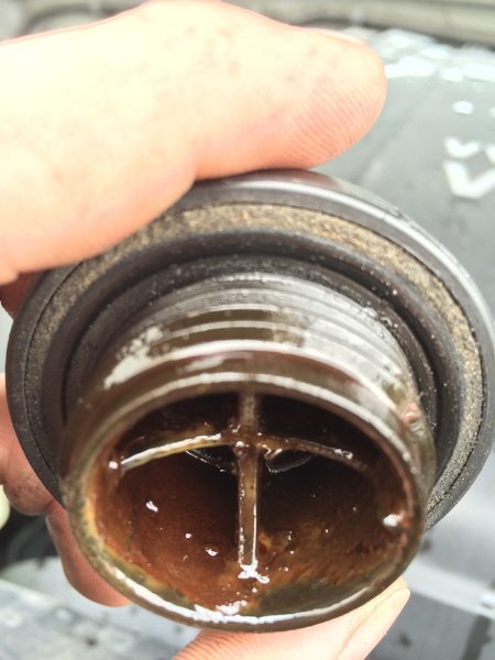

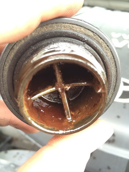

    Jimmyh, I have had my check engine light coming on then going away on its own. I read the codes and it says cylinder #4 misfire.
    WormSquirts, out the exhaust. And the cap looked a little milky, my dad thinks it's just condensation. Also when I took the cap off, there was smoke/steam coming out. I'm not sure if that's normal or not, im not a car guy lolimage.jpgimage.jpg

    Is the oil level high? That looks to be a bit more than just condensation to me. I had the misfire cylinder 6 on mine with occasional white smoke out the exhaust and I could hear coolant bubbles quite often going through the heater core. I removed the plugs and sure enough number 6 was clean as a whistle. Mine was just barely weeping into the combustion chamber. I'm positive that's why my truck got traded in as it was immaculate with extensive service records. But it's a costly job to do. Fortunately I had just bought it and the dealer covered it under warranty. I recall them saying it was like $3800 to fix. I've put about 50k miles on it since and it's been perfect. And it's got all new genuine Toyota gaskets on the front of the motor and from the block up.

    looks like it is the head gasket to me as well.... only one way to know for sure though. sorry man, i hope we're all wrong!

    With steam coming out of the oil filler cap, I think that the coolant is actually getting into the oil pan.
    Pull the dipstick and post a picture of that. Or Drain the oil. If it is milky you are getting coolant into the oil.
    Do not run it like this. It will kill the engine and gel the oil into a thick creamy sludge.
