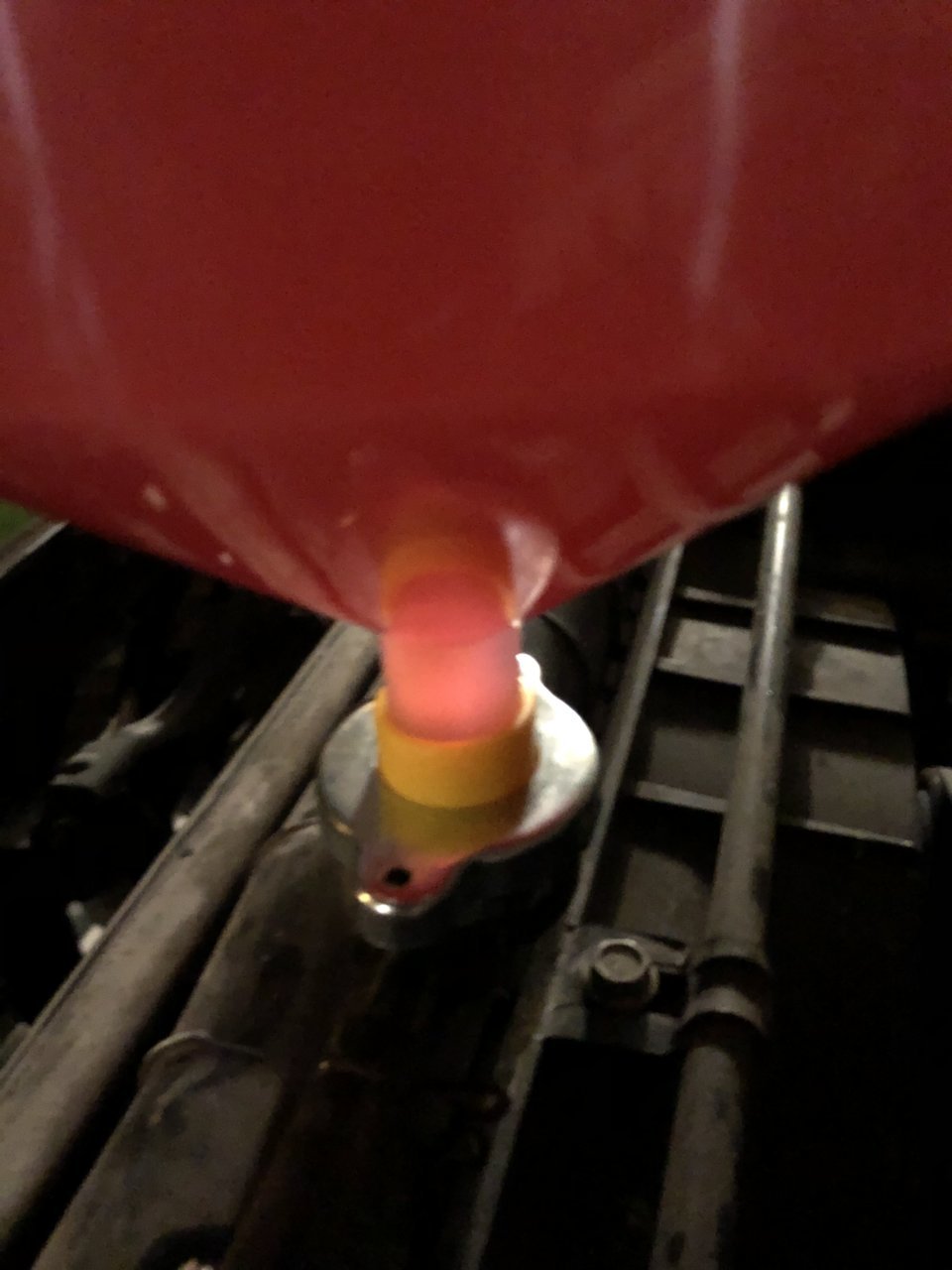

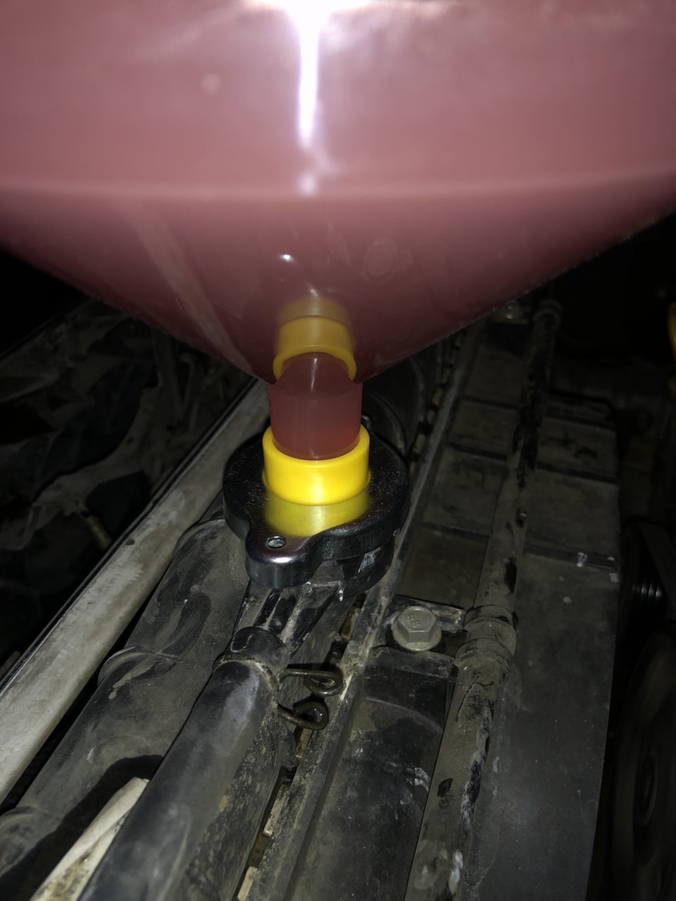

    Alright guys, got home let it cool down and flushed my radiator (just my radiator) Again I ain’t no mechanic and didn’t drain the block etc....
    I did not see the “pink” milkshake it was just really brown color and looked like used coolant.
    since I didn’t flush the whole system I did see the fluid in my funnel turn slightly off brown color (probably from what was left inside)
    I’m waiting as I type this for it to cool down to remove the funnel to take it on a test drive.
    I tried to do my best at capturing the fluid in the pictures but not that great. Really can’t appreciate the “gunk” coming from the radiator.
    It’s supposed to look pink but I’m not sure why with the flash it’s looking like Pepto lol
    Hopefully this makes the situation a bit better. The oil looked good but this weekend it will probably get changed also.

    Your transmission oil is done. I would do a drain and refill.

    flush it with water....................this time o year antifreeze NOT necessary
    flush several times
    if its oil U will see
    if its trans fluid U will see
    either way U might flush some o that ' peanut butter '
    pull spark plugs...................do compression check
    dont jumble plugs
    #1 plug labeled........... #2 so on etc so U will KNOW what plug what cylinder

    I didn’t see that my truck had previously had pink milkshake until I realized the previous owner forgot to clean it out of the radiator overflow tank. It was brownish red and smelled like atf and coolant, once it sits it doesn’t stay “milky”.
    Again, I would highly suggest changing your radiator and trans fluid, if it is pink milkshake then you need to change the trans fluid ASAP and put in a new radiator.
    Edit: did you measure how much coolant you took out? Because if you took out more than around 2gallons then that would probably mean pink milkshake. Also did you smell it? Taste it? Jk lol

    for flushing & testing Any clear water source will do
    the engine with milkshake/peanut butter goo already thru the entire system ( might NOT ever get it ALL Out !!!)
    having been heated ......run .....& cooled may have solidified to some extent
    flushing might provide a level o clarity the actual source of the Trouble
    replaced or repaired then filled with the CORRECT COOLANT
