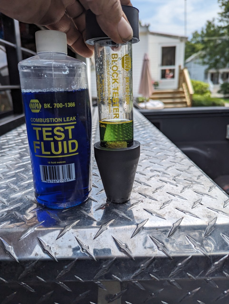

    You mean like this....?
    Sigh...
    b_r_o likes this.

    Aux back up lights, Bed lights, Re-located trailer plug, Good dooby, a.k.a. jumper cable mod, Heated seats, back up camera,
    What @b_r_o said makes perfect sense.
    You could have a coil that becomes an open circuit when it gets to hot.
    I'll just leave this here...
