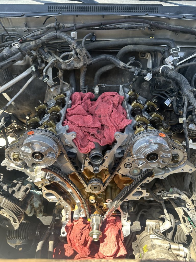

    I have more miles than you and just DIY the head gasket. 175 compression on all cylinders BTW. I did replace all timing components but they were completely fine.
