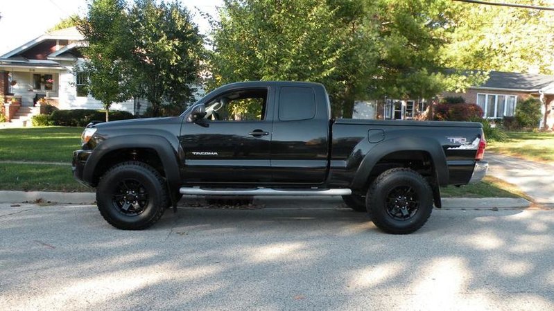

    I have Dakar's , it lifted it 4" but I had 64K miles and it was sagging from stock. OZ's average with them is 3". Funny thing when I cleaned the brakes the boots were off so I cleaned the 5100's and tied them down. With thicker wire ties.

    Before lift with 265" and after with 33"s
