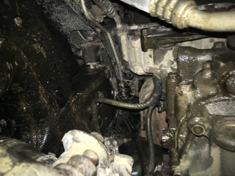

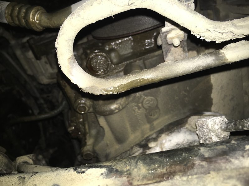

    Out of curiosity has anyone ever blown a stock shock absorber? I have a leak coming from somewhere and the fluid is unfamiliar in viscosity and smell to me. I found the leak last night after finding spots on driveway. The passenger side wheel well is full of the fluid and the passenger side fronts side of the engine block is covered as well. (reasoning for first thinking it was oil)
    I do have some attempted photos of the leak if that might help? Thanks again for the time. Really enjoying this forum.

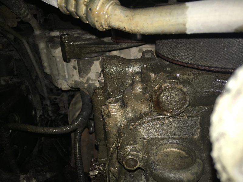

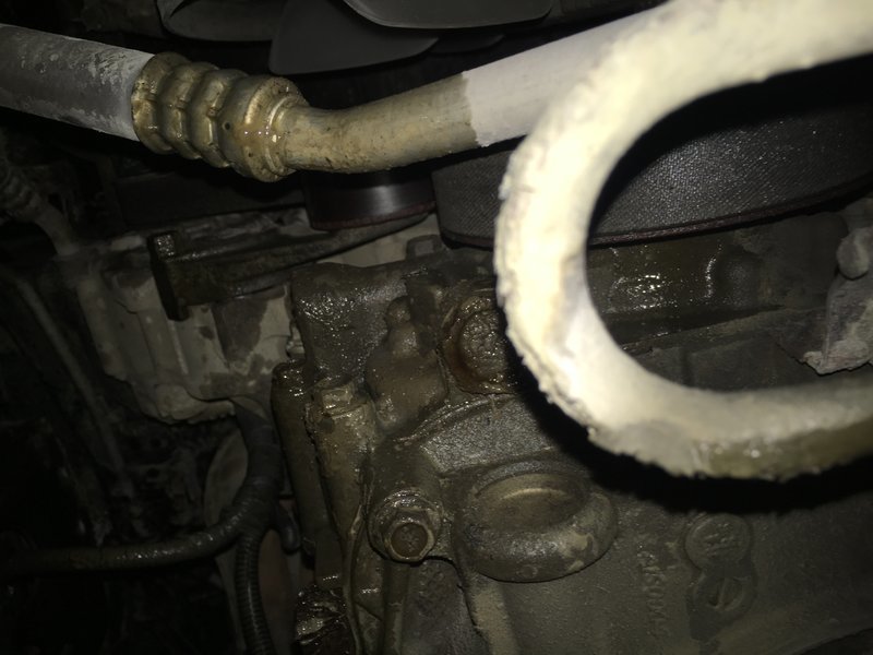

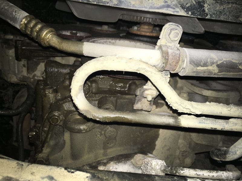

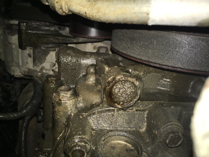

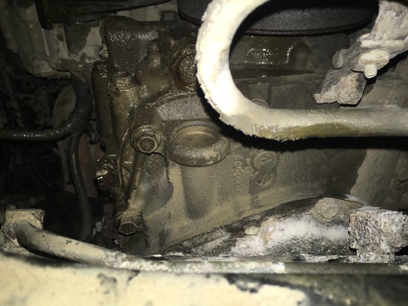

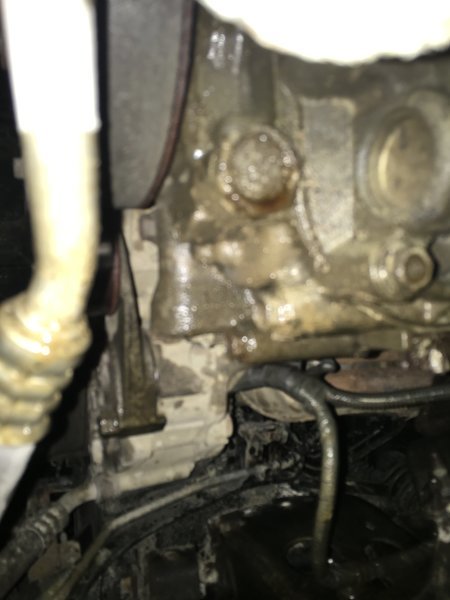

    Okay here is my attempt at photos to best capture the leak. All photos are taken from under the truck, my head pointing towards the bed for reference of direction. If anyone has questions about the photos let me know and I will do my best to clarify. There is no fluid on drivers side, only passenger side.

    Thats not from a shock... Hard to tell from the pics but I doubt a shock made that much of a mess.

    Power steering fluid?

    My first guess, but given that it's all around the wheel well, maybe CV? It doesn't look to be heavy CV grease but could have been diluted on the trail if it was wet.
    OP check your CV boots and steering rack for any splits or dripping areas.

    x3 on the power steering fluid, it doesn't take much oil to look like it just detonated. 1. Did you check the fluid lvl when the engine was on or hot that could give you a very inaccurate reading? 2. Did it look a little foamy or had micro bubbles in Reservoir (air in the system indicates a leak). a couple drops of power steering fluid makes a hell of a mess and looks way worse then it could be.

    A/C if it has a greenish tinge and a bitter smell.

    No way from a shock. Something around the motor is leaking pretty bad.

    It's a work in progress. See my build thread.
    What connection is this?
    That looks like it *could* be the source.

    Clean it up with degreaser, or steam clean it. Then with the engine running, check for leaks. Have some one crank on the steering wheel, and pump the breaks. If nothing drive it around the block and recheck.
    Could have possibly ran over a quart of oil that feel out of another vehicle as well. I've seen weirder stuff happen.
