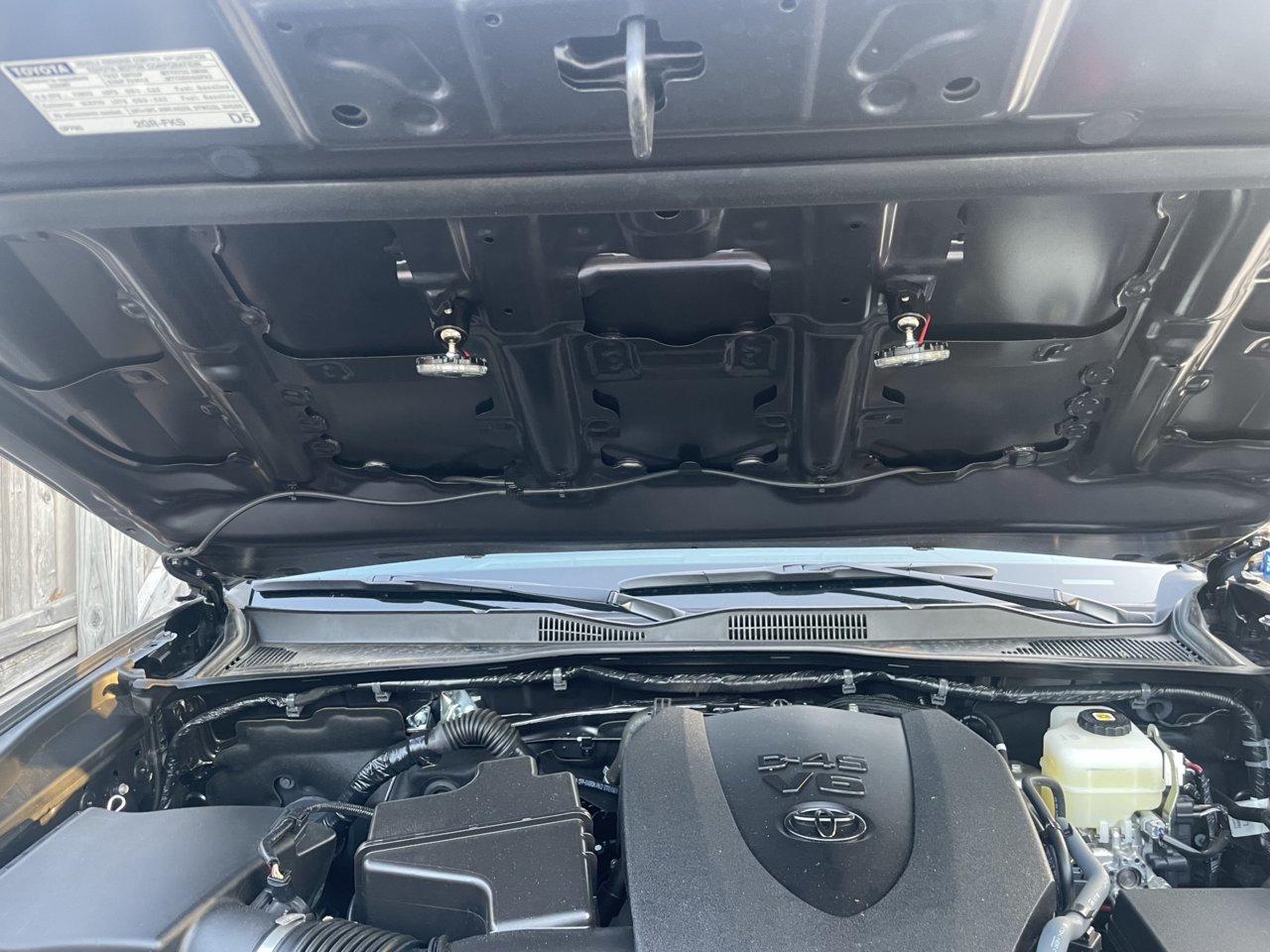

    When I had my Frontier, I originally bought these KC Cyclones and some flush mount pods from KC to mount in the Frontier bed as bed lights using a 2.5" hole saw. I never got around to it before I sold it, which I am happy about. I decided to repurpose them for the Tacoma.
    I am always messing around under the hood, sometimes when I should be and other times when I shouldn't be. Regardless, it's always better to have some light under there. Especially at night, if you're finishing up an oil change or something, or searching for problems on the side of the road. So, I had good reason to repurpose these lights to be hood lights.
    I bought some camera mounts from Amazon, and removed them from their clamps they come with.
    Tripod Clip Clamp Camera Mounts
    After taking the pivot mount off of the clamp, I was able to bolt the KC lights onto each mount, and then bolt those to the under side of the hood using some empty holes. Easy enough.

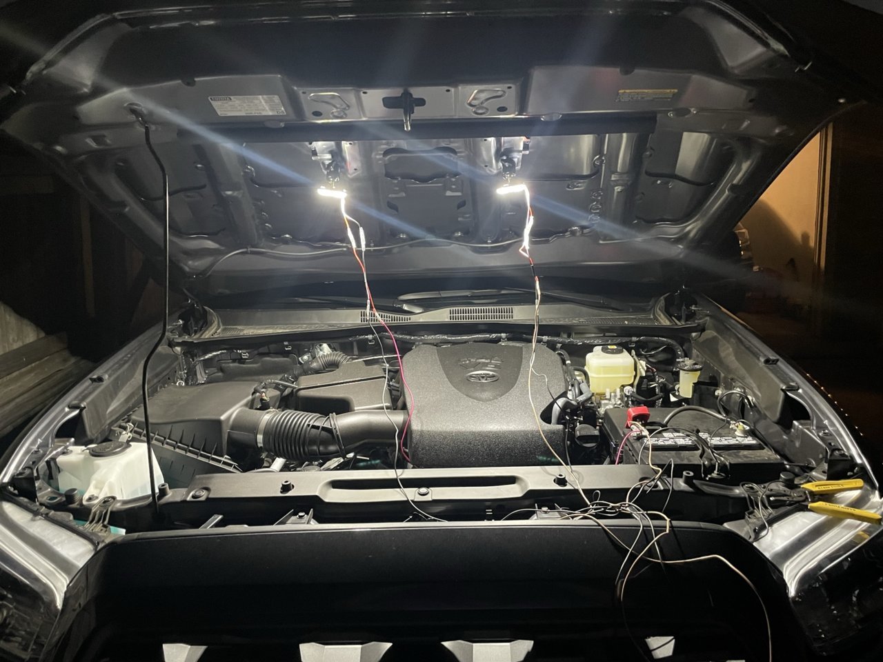

    I temporarily hooked up wiring at night to see how bright they are....they'll do the job!
    I have not finalized the wiring yet, since I wasn't sure how I wanted to do it. I originally wanted to wire into the factory hood latch, so that the lights turn on as soon as the hood is opened. However, this latch works backwards from how I need it unfortunately. The hood latch grounds the hood sense circuit when the hood is shut. When the ground is lost, the dash alerts you the hood is up. Sadly, I needed the latch to provide my lights a ground when the hood is up, not down. So, I can not make this hookup work.
    My plan is to get a hood pin switch from Amazon (DEI brand) and bolt it into the front grille frame area. I will use that to control a relay. Open the hood, the pin switch gets ground and triggers the relay to turn the lights on. Easy enough. I preferred the OEM hood latch because it would have just been that much sleeker, but oh well. I'm not a huge pin switch fan as it seems the elements affect them, but I'll set it up the best I can and see how it goes. Part of the problem is not adjusting them to where the hood smashes them way down. They only need to be operated by the hood a tiny bit to disable the lights, beyond that you're just weaering out the switch's spring, which causes the switch to not spring all the way up later and you don't get ground when you need it.
    So, I think with the switch adjusted properly I'll have an automatic light that serves me well enough. People will talk about what about the lights during the day, yada yada, and so on. Valid point, but I don't really keep my hood up all that long. If I do, then worst case I can just disconnect the single wire on the hood switch and they'll go off. Or I can unplug the relay.

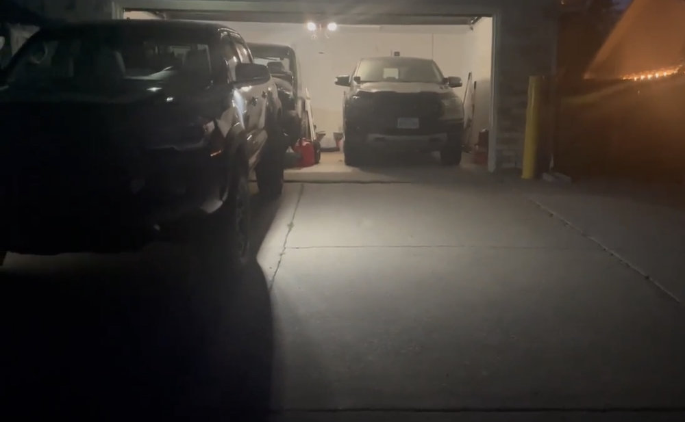

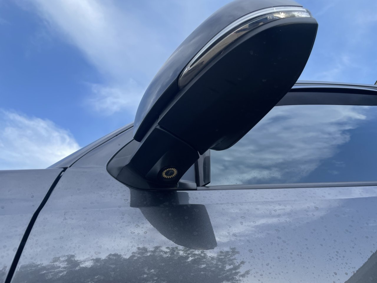

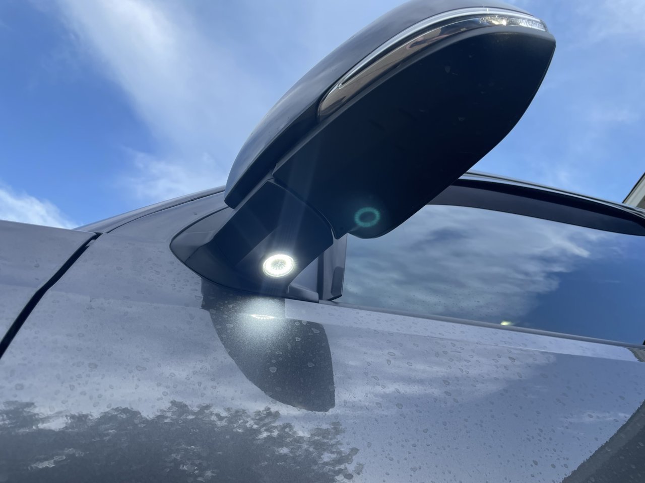

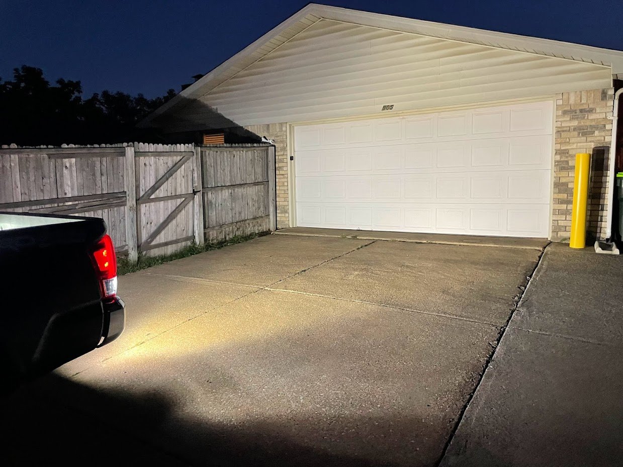

    Meso Puddle Pods
    I received the Meso Puddle Pods from Bustabeatgeorge. I didn't realize it at the time but I needed a splitter harness from VLEDS, so I ordered that as well. This allowed me to plug the puddle pods right into the VLEDS footwell light kit.
    I'm not going to detail out the whole install, but basically you run the Meso harnesses from the VLEDS hookup, over to the doors, through the door boots and then up to the mirrors. Then you run the short harnesses through the mirror hinges and into the little spot where the lights go. Plug the lights in and clip them in place of the old mirror trim that they go in place of.
    The results are sweet. Super bright lights that come on with the unlock button or the doors opening. You can get a switch to turn them on on command as well, but I don't really see the point to it so I opted to skip that functionality.

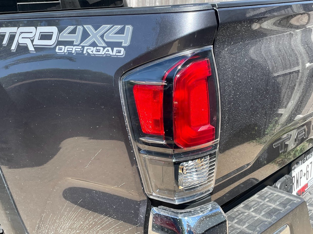

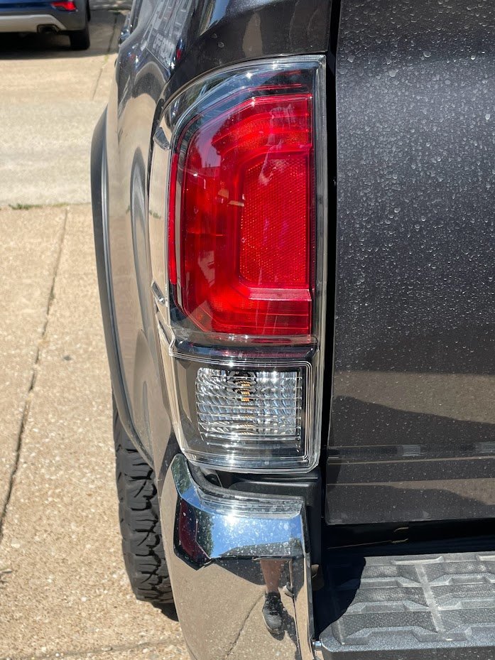

    2020+ TRD Pro Tail Lights
    I am not a fan of the chrome accented tail lights that the 2020+ TRD Pros and Sports come with. The previous owner of my truck swapped my OEM tail lights out for all-red ones from a lower model. I liked them, but a tab was broken on each of them. I liked the way the TRD Pro black accented lights look, so I ordered some brand new from Sparks Parts.
    Left: 81560-04230
    Right: 81550-04230
    I also ordered new bolts and guide clips.
    Installed:
    7PqX0ItkyAdzBdH0VWxXoge-gHJ1nqHHHdCzRTGM_679624fe5d9a0ab2bb72c7726c05d0ea5bb98ef8.jpg
    nnK0thy3g-jz6yIBM_7cbPUc9xyfxb2owRtVZajG_ef2c3a3c55ed36b86a0227c4607d0b4ff3ac82df.jpg
    Very easy install, obviously. I ended up using these with the VLEDS 50-LED red bulbs that I have mentioned previously. For about a week I used incandescent bulbs (Meso Stage 1 kit still), but with the clear lens of these tail lights, the red of the VLEDS bulbs is actually quite visible. On the all-red tail lights, the LED red would be sort of washed out. I like these better for sure.
    Here is a comparison of the incandescent vs LEDs. Left is incandescent, right is VLEDS:
    FFmbW3XhxLxCHanWpwwBxjkdG6whfsiUdF0Y-T6l_0b881dbabb81e7e59d6149269e5df44186521091.jpg
    Final pic, all LED:
    3JlOYa9V59qvWUsiwgqocLSk81jh0JYSCaidh-8X_31d100f6d6a55c1ff8d3789eb0b4ccc11b3e0790.jpg
    Overall I'm happy with the turnout of these tail lamps. They fit the truck better, are plenty bright with the upgraded bulbs and Meso functionality, and they aren't broken! Can't ask for much more.

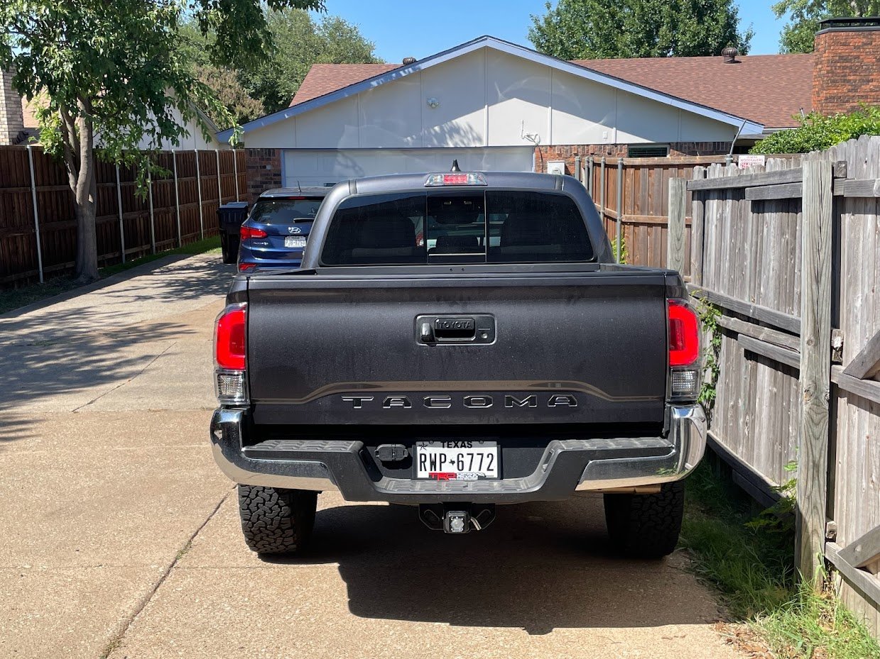

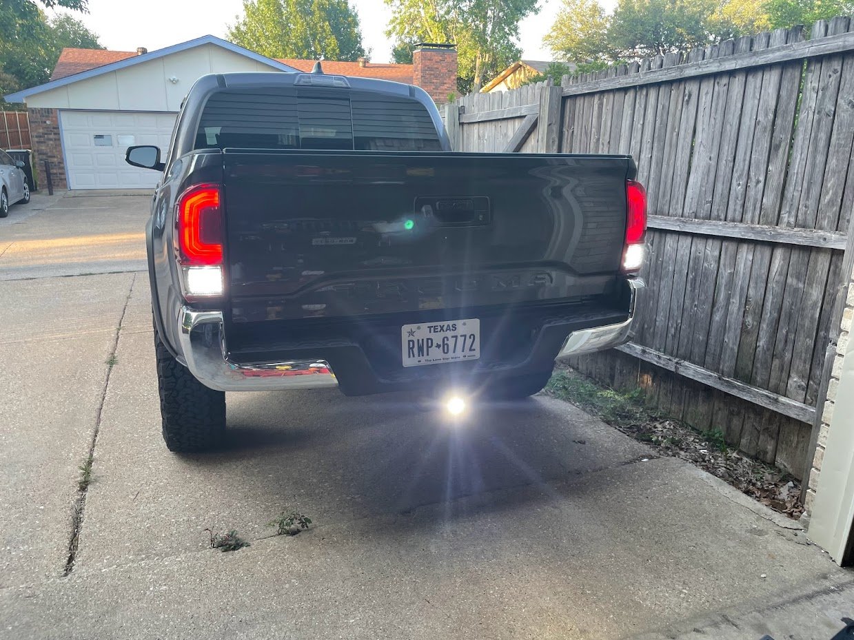

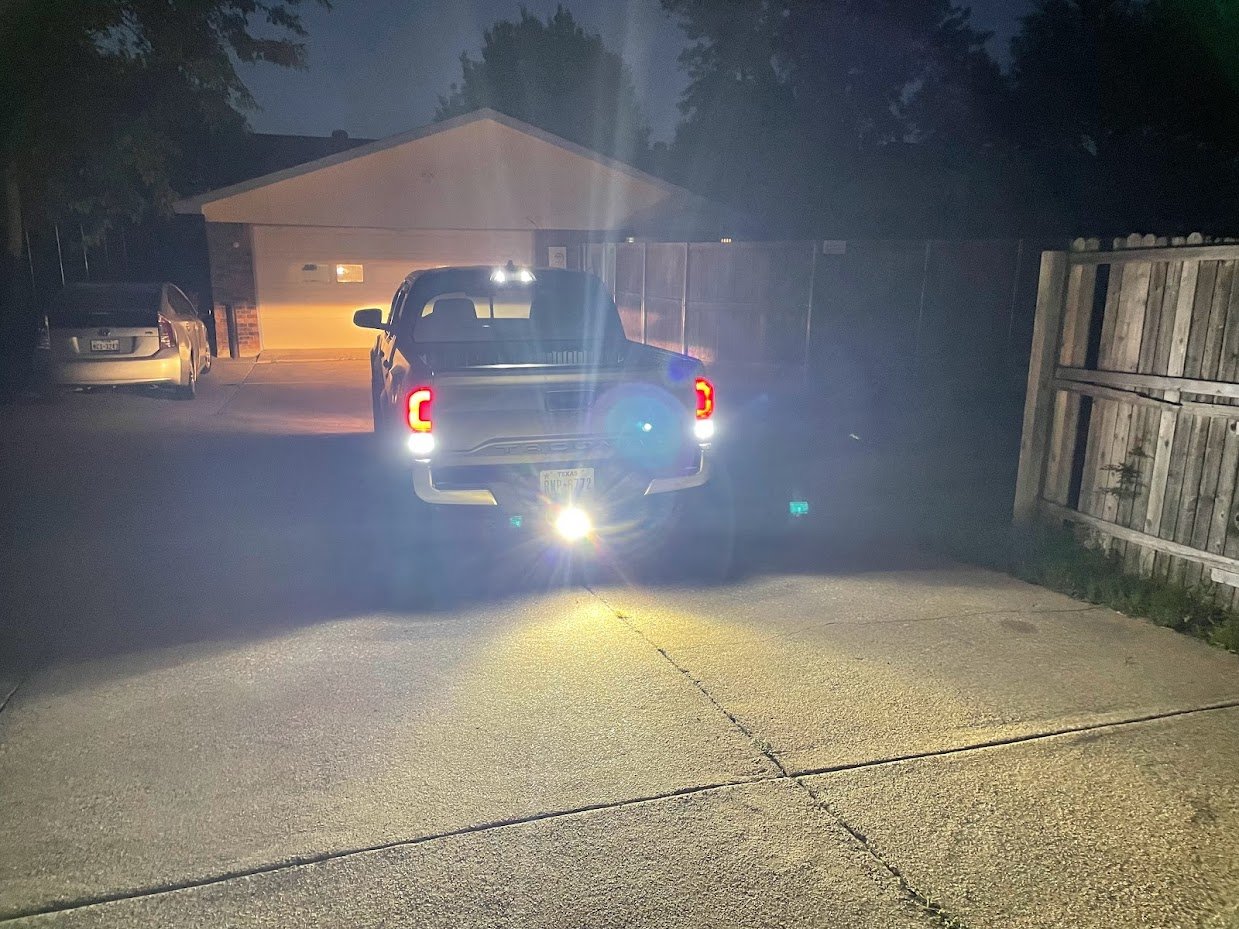

    License Plate Disable in Reverse (DIR)
    AND Meso HitchPod with Baja Designs S1 (powered by FBC DIR Harness)
    I saw the DIR thread and instantly had to try it out. I was going to build my own harness as the original thread was just a DIY tutorial, no product was being sold in that thread. Later I found the actual thread where they were later started to be sold to forum folk and so I ordered one up from FBC. I also ordered my OEM LED headlight harness. Both were very nice quality.
    Install was easy, I'm not going to go over it as Chloe has a good video on YouTube and plenty of info can be found on the forum.
    I love the results. You can see in this pic that my tail lights are on, reverse is on, license plate lights are NOT on.
    WgNiZiMUJd0puxZaE_dYctm1AwaIbK94_prRk59U_3a2921cc4cb45ef8306f5db0c2e0842f90dcd2ac.jpg
    What's also really cool is the Meso HitchPod and Baja Designs S1 light, which mounts inside the HitchPod and goes into the trailer hitch. What's even cooler than that though is that the FBC harness offers an option for the S1 to plug into! So I did this all plug and play and got a ton of light behind the truck with very little effort at all. Another cool thing about the FBC harness is that they bring the power from the license plate light harness, so the HitchPod light actually does not come on until the parking lamp circuit is on, so during the day when the light is unneeded, it isn't on.
    Here are some pictures:
    e9FCabWt1SAALk0HL5GGGwJ3yvGogOSkY0TcO-BZ_02940db166a3eed40924199184641a077bb6f7e7.jpg
    N8K7SZoO34G0yB5fGig-Jty0PMkP_VLT2pYtpxBu_1330e7978b2c280473016f51ccca1413afa7a385.jpg
    Overall really happy with this outcome.

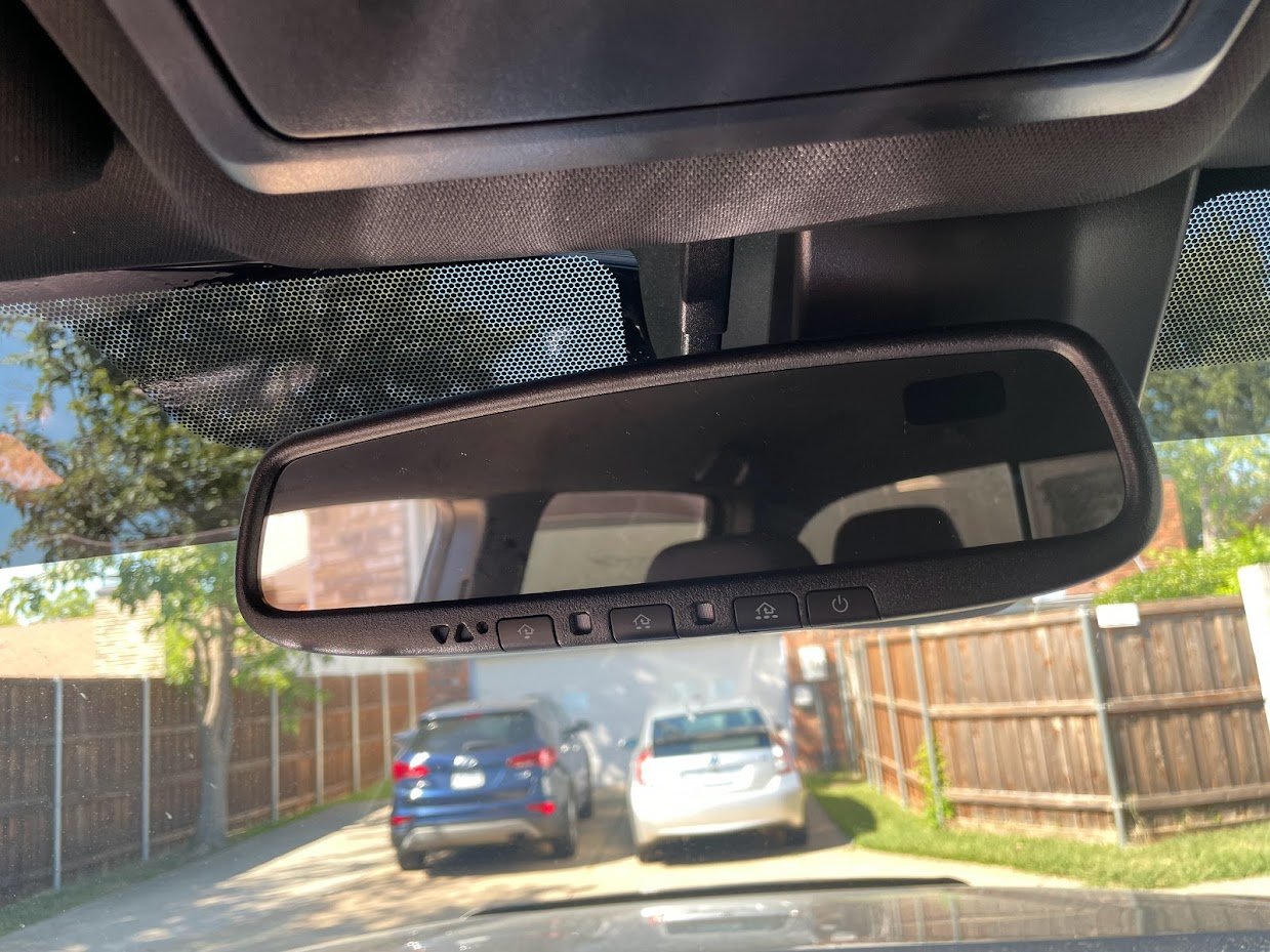

    Homelink 5 Mirror Upgrade from Homelink 4
    When I got the truck, it had no garage door opener. I wanted one, so I ordered this mirror from Bob's Automotive Mirrors and More. It was Homelink 4, and I was very happy with it! Until....I learned that there was a Homelink 5 mirror he sells that I missed when I looked the first time. The Homelink 4 supports 2013+ garage door motors that have higher security. Homelink 5 takes garage door communication a bit further by knowing the position the door last went in when you left the house. That way you can see what direction the door is going when you press the button, as well as check when you're away from home to see what the last direction it went was.
    My garage door opener is from 2008, so mine is not fancy enough to be able to do the Homelink 5 stuff anyways. However, my parents have a compatible opener, so I wanted Homelink 5 for their house. Also, this mirror is brand new vs the Homelink 4 being used. Also, the Homelink 5 mirror has a nice function that no one knows about: after clicking the button, the mirror holds it for you so that it has the best possible chance of getting the door open or closed. Sometimes you have to hold the button and let go too early or whatever? No issues here. Just click it, it self applies for about 3 seconds, and that's it. So far so good, I am really enjoying this mirror. I sent my Homelink 4 back under the return policy and other than paying for return shipping, I got all my money back. I am happy with it.

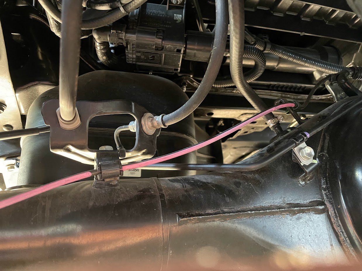

    Rear Axle Extended Breather
    I don't really do water crossings, but I like to have my axle breather as high as it can be. For me this means up behind the tail light. I bought this kit from YotaShop. It was affordable and did the job just fine. It is just a hose, a nipple fitting for the axle housing, and a breather fitting for the end of the hose.
    Installation was easy, I removed the old fitting, threaded in the new one with some teflon tape, snugged it down, installed the hose and snugged the hose clamp, and zip tied the hose to various items, running it up to the tail light. I made sure to leave enough slack for the hose to flex with the brake lines for axle articulation.
    Not much to say about this one. It's cheap insurance, easy enough to install, and certainly can't hurt anything. The kit was complete, and I used my own long zip ties that I prefer. Not much else to it.

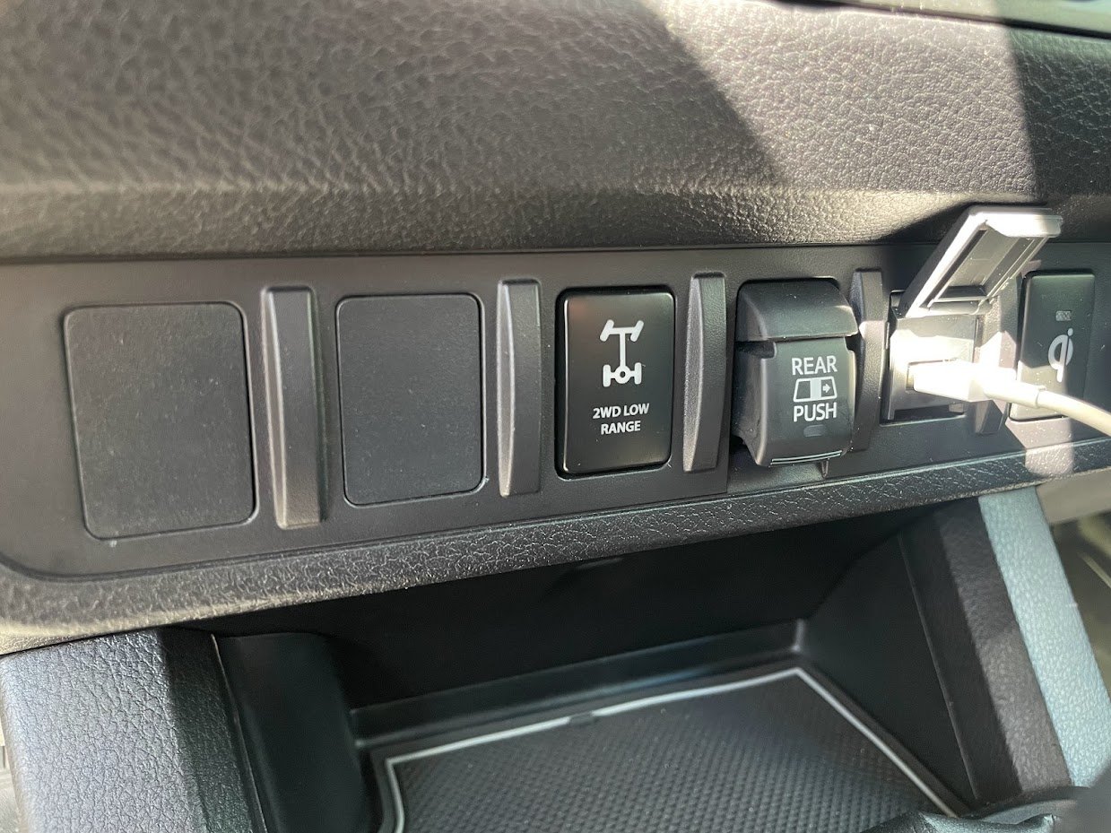

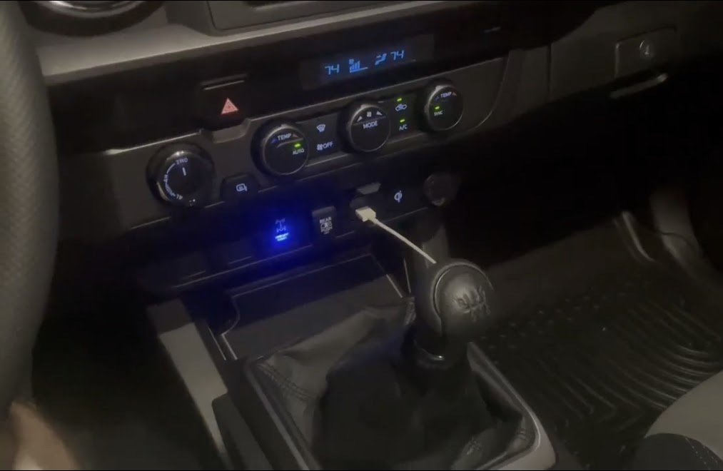

    2LOW
    I knew before I bought the truck that I would do the 2LOW Modification. It's basically a plug and play harness that plugs into the 4WD control module and disables the front differential from actuating when you go into 4LOW. What this does is allow you to get the gearing benefit of the transfer case, but still be able to steer without damaging the 4WD system, steering, or have to physically fight the steering which sucks.
    there is plenty of info on this forum about this mod, so I'm not going to post the install or pictures. I will say however, holy cow is it nice! It's great being able to just idle around in reverse super slowly, especially for backing up a trailer or a steep surface.
    I bought a switch from CH4x4 and put it next to my power rear window:
    YtdDO-LcHKaAGMRRY75RCwJE27hByM4bsIRKG20p_0b4533aba9929c2e069d4161e59f23a69daadc4d.jpg
    It is a bit bright at night, so I am working with kmorgan3 on a plug and play harness that will instead power the "2WD Low Range" indicator on this switch with the dash illumination circuit, which will also intelligently dim the switch. It will still be a bit tacky since the blue does not match the dash blue, but there is nothing I can do about that.
    uB4H2UfiquzHdWwjbqPtGoKlfewlt-Yioh72J65z_8a28ea10b8f101c2f21b1da1f76681cbad94ecfe.jpg
    Overall I really enjoy the 2LOW mod and highly recommend it for manuals or automatics. It's just too convenient of a function to not have it.

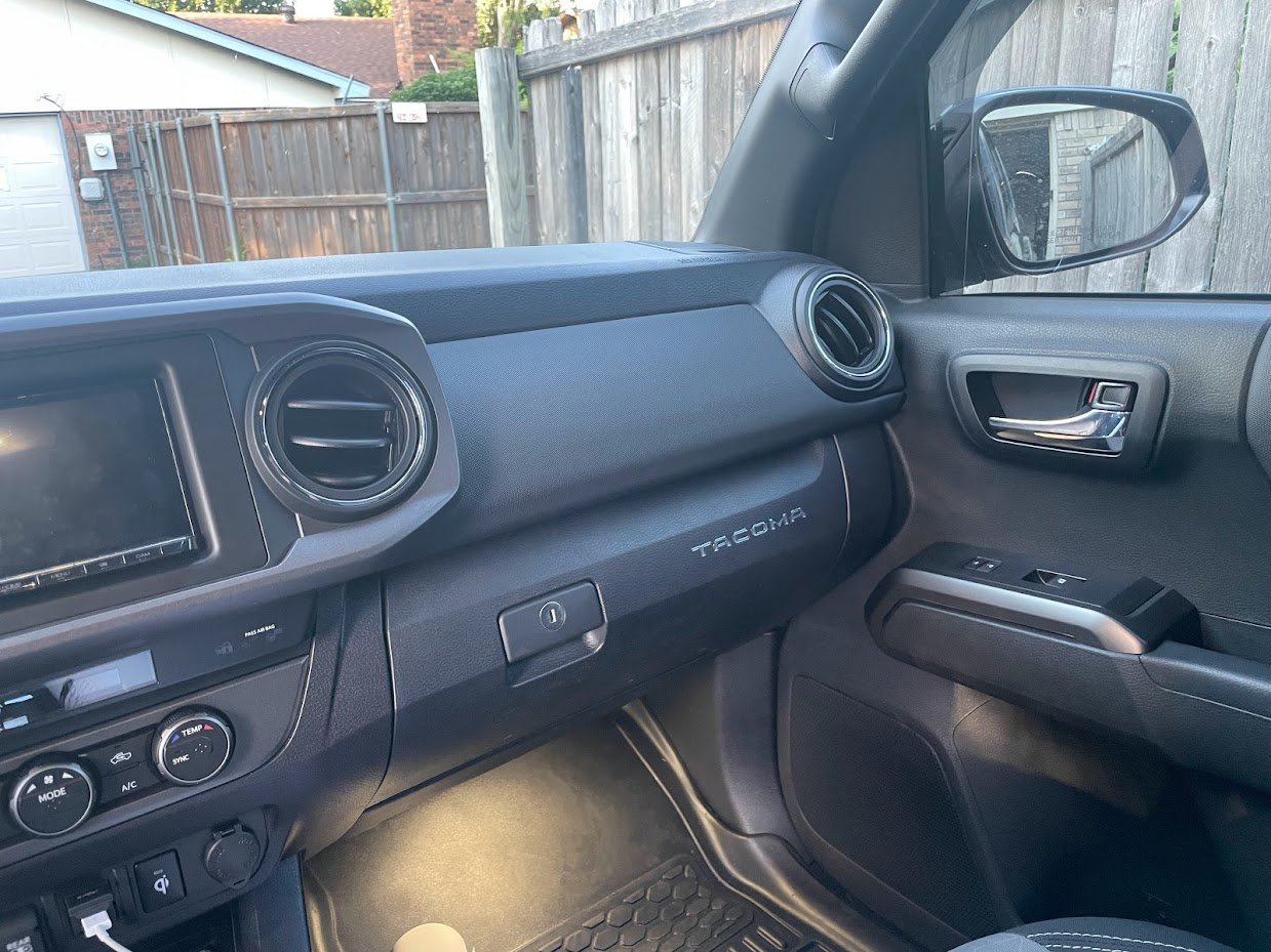

    I’m glad I found your build. Great info. Can you share a bit on how you removed the blanks on the lower switch panel? I have been searching and what I’m finding isn’t very productive.

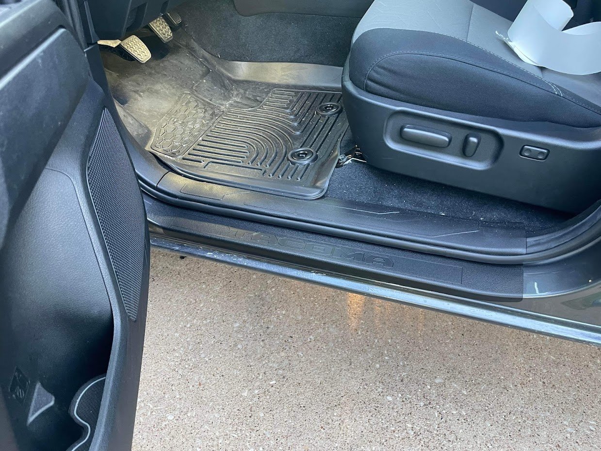

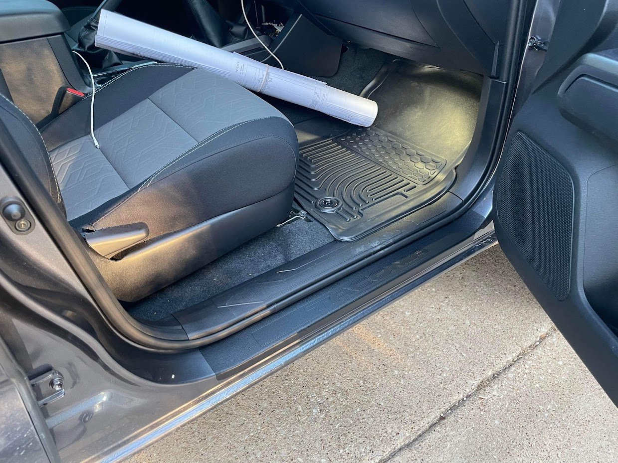

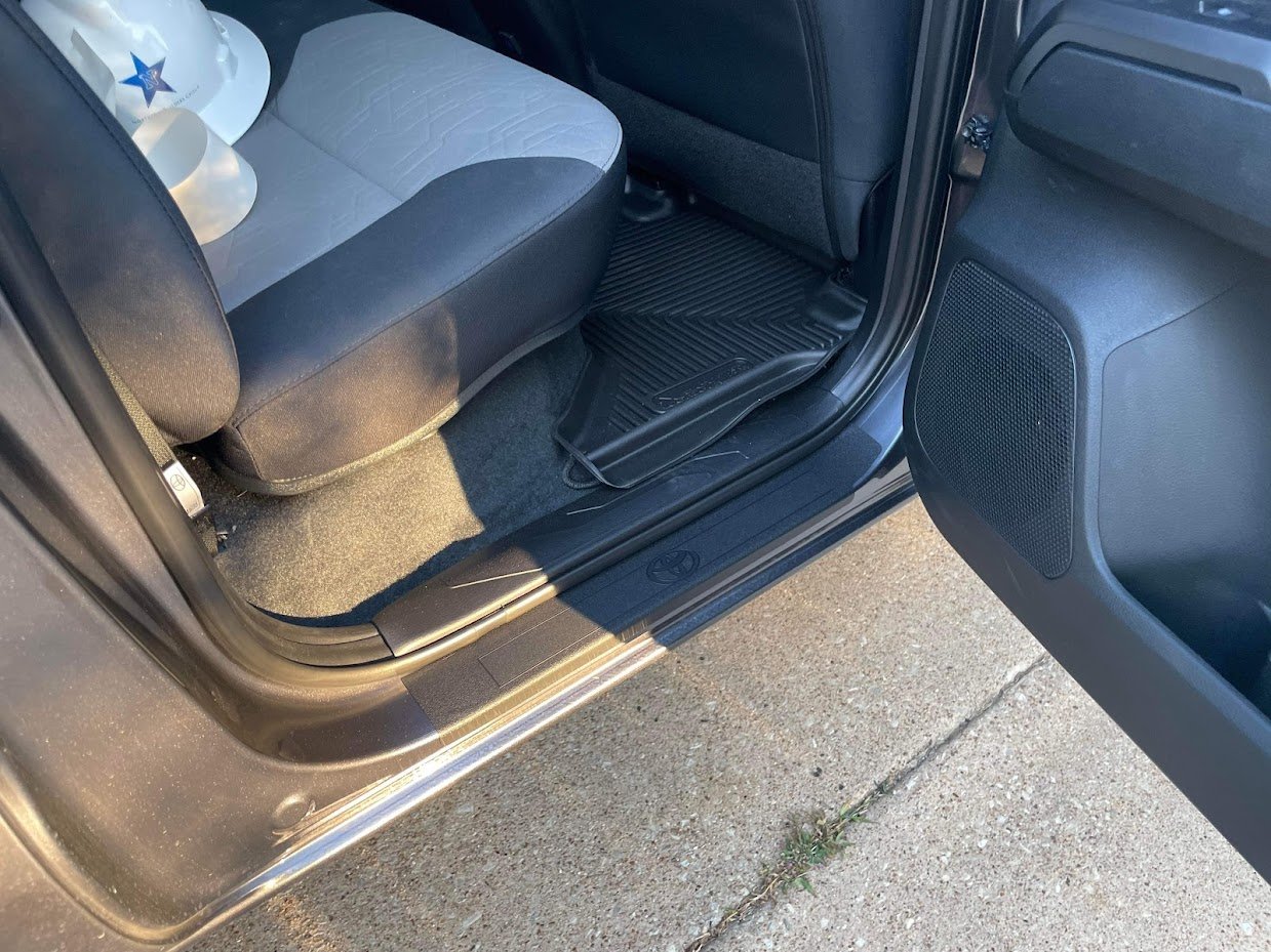

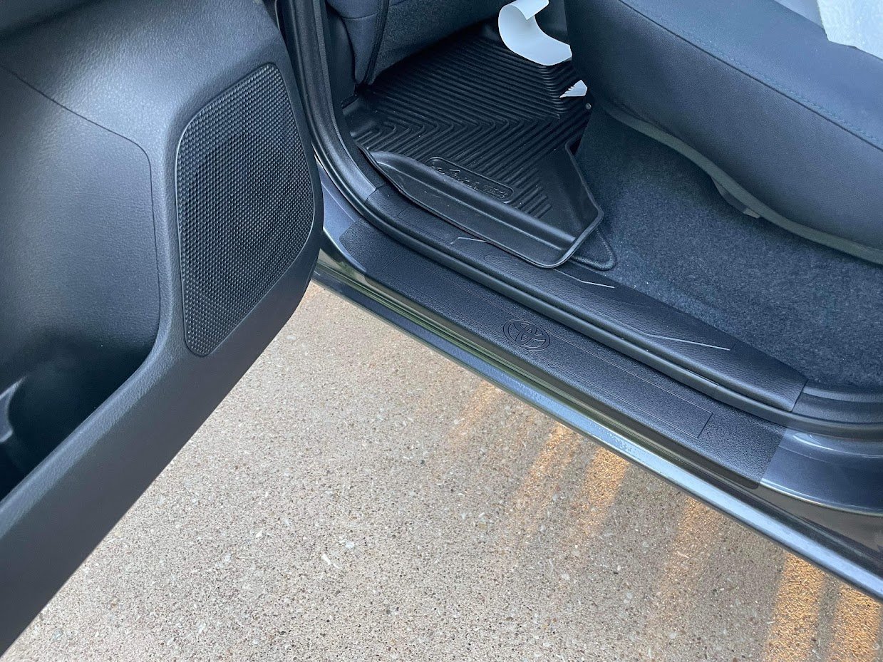

    OEM Door Sill Guards
    When I was installing the 2LOW harness, one of my trim panels got lodged against the door sill and scratched the paint pretty bad. I already wanted door sill guards, but from the scratch, I now had the urge to fix it by getting some touch up paint and then covering up the spot with door sill guards. So I ordered touch up paint (1G3 for MGM) and door sill guards (PT747-35201-02).
    I don't have any pictures of the fixed spot with touch up paint, but here are the door sill guards:
    FmzChvdqAP9oILChLmf5Y9N1arplbtxP7MD5wlM0_c1d2dd0762e3ee490e956ba4db0d0163c6fda0b1.jpg
    WIFmMlzFZk_8FBFHV5Cqpn2gTpTbLGhOTpstniJ7_9c38a4e665f3aab6feec8fd7881df1ff66b7a54b.jpg
    jkxkkdX86oqgFeZFJFBrq4EINR_tNwUtkzaxvSNc_f2802edd81bf5e31ef158a6f83d0983ab0cb8554.jpg
    tgCWHd2Jsl5-Il6E9nbBe0HGZFxT-w9uX1LQlQaL_4dc14e20bb31f3a3858ed7e942ea964552fbd664.jpg
    I think they look sharp, they cover my paint messup, and will protect the area for the future. All good results.

    Thanks, and sure thing. During the 2LOW install you have to remove the glove box. I believe most people take out the radio, but after I did my Kenwood install I really am dreading going back in there, so I tried without and it worked. I reached in from the removed glove box area and found the empty blank I wanted to put my switch in, squeezed the top and bottom of the switch blank and kind of rotated it backwards like a backflip. It seems difficult but it wasn't really at all. You could also grab a small flat blade screwdriver bit and use it blindly to dislodge the tabs if you're good. Either way I don't think you'd have trouble this way. If you do, then just remove the radio and do it from above. I just didn't want to go through all that if I could avoid it; it was super hot in the garage that night and I was already sweating buckets from 2LM, so I wanted to be done.

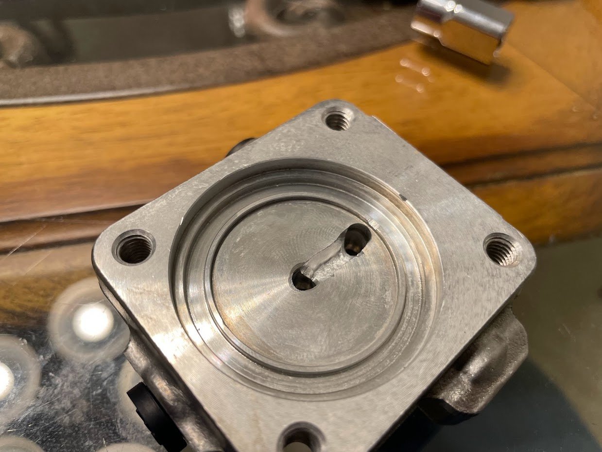

    Clutch "Accumulator Delete" Hack
    Everybody with a manual Tacoma knows the clutch sucks. Well, it's not so much the clutch disc/pressure plate/flywheel that sucks, but it's the hydraulics. The hydraulics would be fine, except Toyota plumbs in this dumb "clutch accumulator" into the hydraulic line. Literally all it does is act like a shock absorber or dampener to slow how quickly you can release the clutch pedal and reengage the clutch and transmission to the engine. It works okay for what it's supposed to do, but for a skilled manual driver, it is only a hindrance/annoyance and literally provides 0 benefit. It is mostly to protect the truck from the shock load of a new learning driver who is not smooth with releasing the clutch.
    There are many ways to skin this cat, my personal favorite is the accumulator hack. What this does is basically modifies the accumulator to remove the acculumator function, and puts the stock part right back in place. No need for custom made fluid lines or anything else, just the stock part still in place but no longer doing the stock job.
    It's pretty easy. Removing the clutch accumulator is outlined on this forum in many places, especially the mega thread, so I'm not going to detail the removal.
    Once it's removed, unbolt the 4 bolts holding the backer to the accumulator, and remove the little circlip, the circular plate, and the rubber square seal. The "hack" is to dremel out a channel between the two holes you see. Doing so removes the hindrance in the brake fluid circuit and allows fluid to flow freely like we want it to.
    I did this in about 2 minutes by putting my accumulator in my neighbor's vise. I used this bit, Dremel #194, and my Milwaukee rotary tool on the highest speed setting. After that, I followed it up with some compressed air to blow out all the aluminum shavings. I made sure to hold various holes closed while blowing the air in others so that shards would be blown out in all directions.
    The end result:
    7x_RQK_fCC4RNoXBaaowh8ZsuxcOFxhdnLJEJEGj_a6f80c3080d0c79a035b4ce6b349c24d2bdf0ee0.jpg
    I installed this morning and wow! The results are great. At first the pedal felt really soft, which made me think I didn't get all the air out, but later it firmed back up. The engagement of the clutch is just great. It's really solid, doesn't feel vague at all, and it releases in the exact same spot every single time. Shifting feels much more realistic and similar to my Jeep that I'm used to. I really like the way it works now, and highly recommend!

    TufSkins Glove Box Letter Inserts (MGM)
    Similar to the tailgate, the glove box letter indentions irritated me. I saw body color ones from TufSkinz, so I ordered them in Magnetic Gray Metallic. They went on real easily, no issues at all. Very small change, but nice enough.
