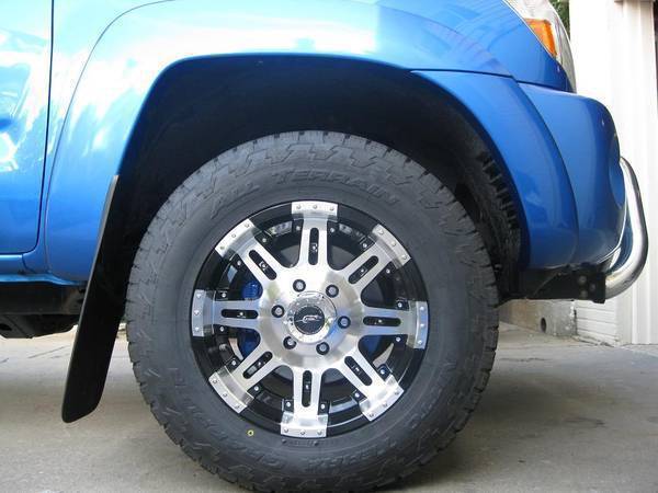

    This is a relatively simple, cheap mod. It does take several hours of work however. I used the Duplicolor Caliper Kit. It costs about $17. Based upon the amount of paint I had left over, it could easily do 2 calipers and 2 drums, maybe even 2 trucks. It comes with almost everything you need. The paint included in this kit is applied by brush. It is actually some kind of ceramic epoxy stuff so it should last a really long time. I had a really hard time finding a blue kit in Topeka. I think I bought the only one in town. The blue is not a perfect match to the Speedway Blue but it is extremely close.
    First you remove your wheels. For the best results they suggest that you remove your caliper from the rotor, however I did not do that and I am glad I didn't. You just have to be more careful with your painting. I think they turned out perfect. I then taped up everything around the calipers so I didn't get any dirt or cleaner where it shouldn't be. Then I used a wire brush to clean the calipers. The wire brush did not come with the kit but it made the job faster. Then you use the included caliper cleaner spray to further clean them. Then I used some sandpaper to rough them up a bit. I then applied 3 coats of the paint. You have to work quickly because the paint sets up fast. By the time I finished painting one caliper it was time to put another coat on the other one. The paint is dry to the touch after about an hour. You should wait at least 3-4 hours before using the truck.
    I haven't decided yet if I am going to do the rear rotors. I think I probably will because they are fairly small. It makes a very subtle difference but I like it. Here are the results:

    Looks good but DO NOT...I repeat DO NOT paint the rear drums! I painted just my front calipers and it looks great. It will look really cheezy with rear drums painted..I think you'll like it just fine with just the fronts painted.

    After I waited the 4 hours I moved the truck away from the house where I could get a better view from a distance. I agree with you guys. I will not be doing the rear drums. It would be too much.

    I have a radiant red 06 TRD Sport. I painted the front calipers with cherry red Rustoleum. Through the alloy wheels, it looks real good. Since the rear drums were faded and rusted, I did paint them black. I tried to revome them from the spindle, but after half can of penetrating fluid, repeated banging and coaxing, no luck. With brake cleaner and wire brush, I just painted them in place. Easy to do.
    All in all it looks neat and a sharp. Yours in blue just looks "GOOD"!!! It is subtle and draws the eye to the nice wheels you have. Good job!!
