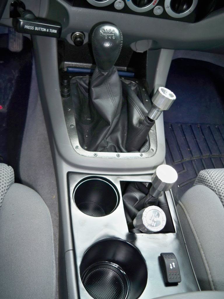

    Wait. Whats with the T-Case shifter. Am I seeing that correctly?

    yea your seeing it correctly... and theres more where that came from... :D :D
    dont mind the shift boots on the back two.. they aren't done yet.
