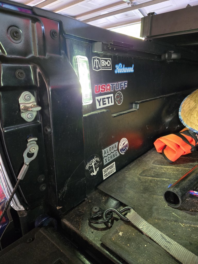

    Let there be BED lighting!
    Why the hell does Toyota think that access cab owners don't need a bed light? Easy install. Went with non-OEM bed lights.

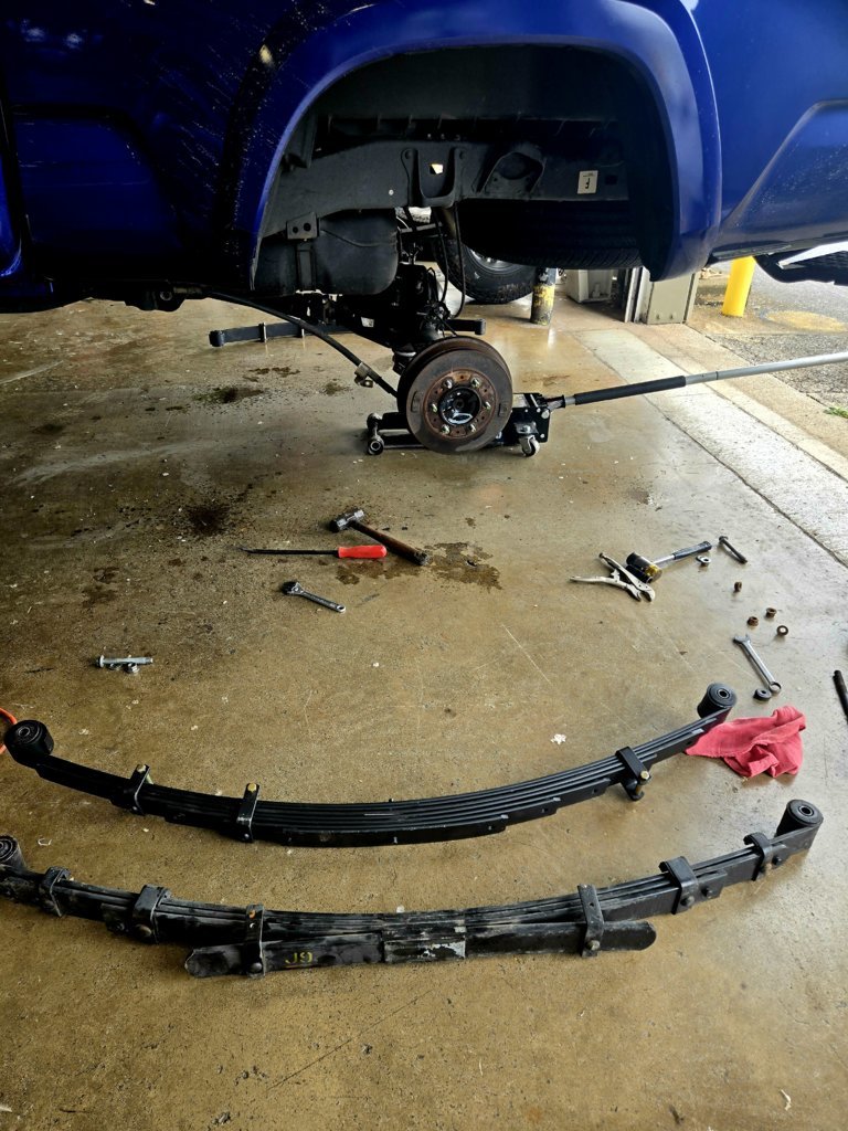

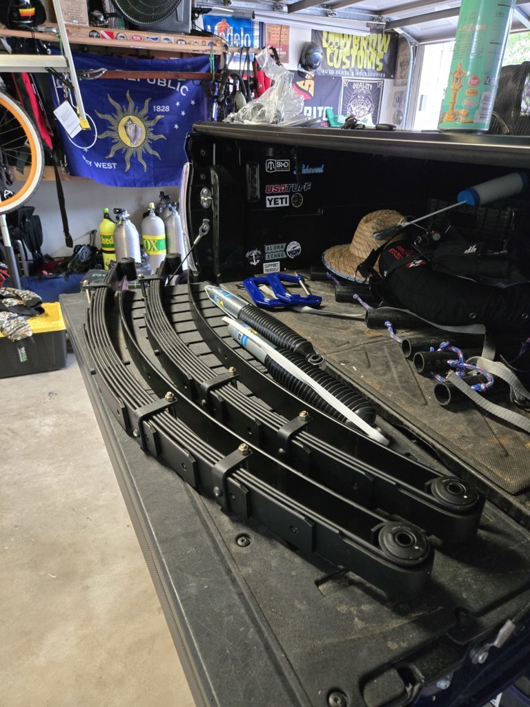

    Getting ready to install the Icon RXT leaf packs and 5125s. I’m going with option 2. I started removing the third leaf and installing the new one today. I’ll finish that up this week and also trim the 5125 sleeves.

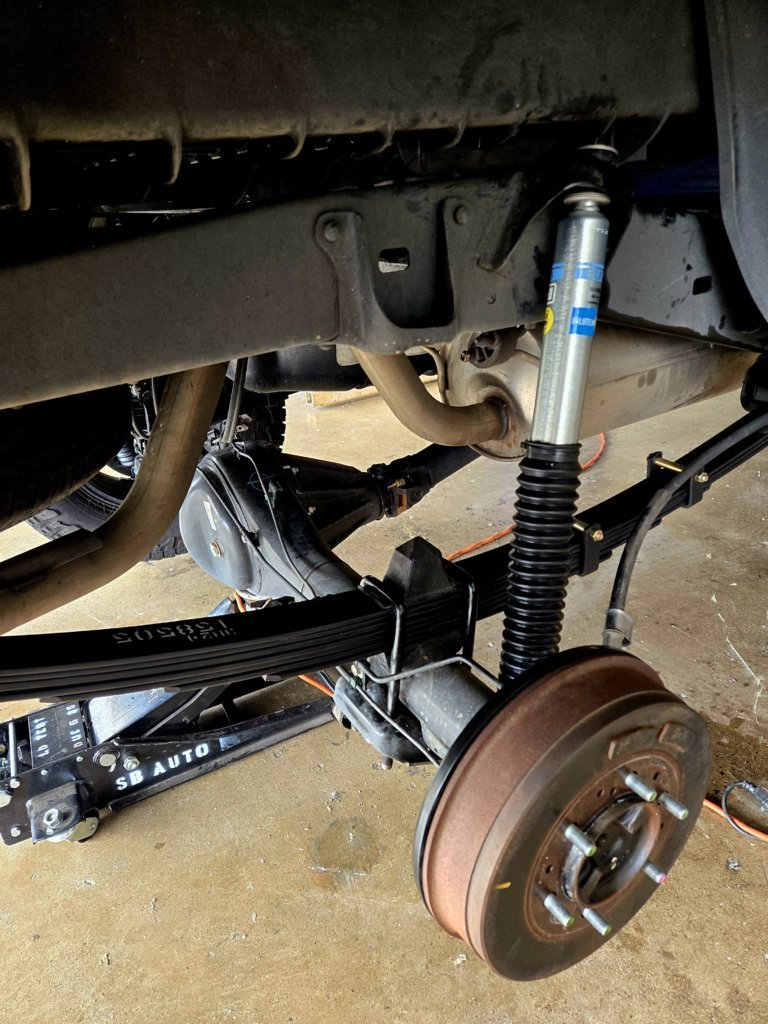

    Big day!

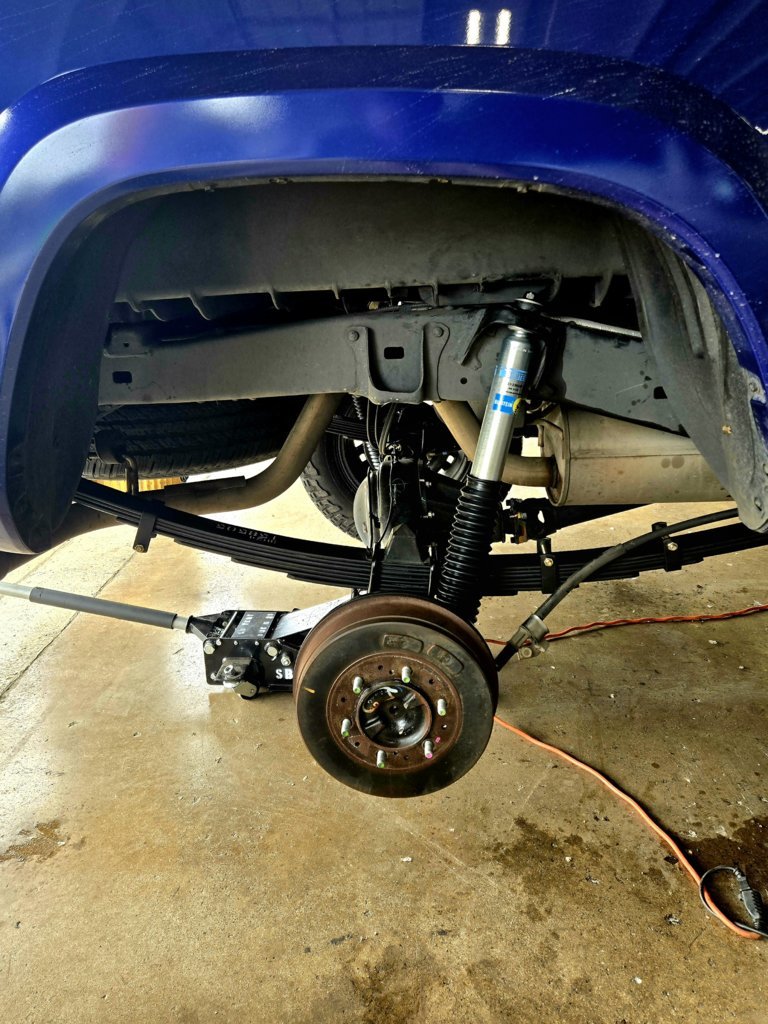

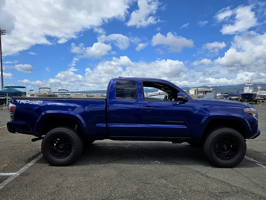

    ICON RXT leaf springs (option 2) and 5125s installed.
    I took my time during the install. Probably 4 hours total. Nothing too difficult. My wheels were seized to the drums (o_O) from the salt water exposure when launching and recovering the boat.
    It took some WD40 and a big hammer to get them off. Minor pain in the a$$.
    Loving the new ride. Much mo’ bettah than stock!

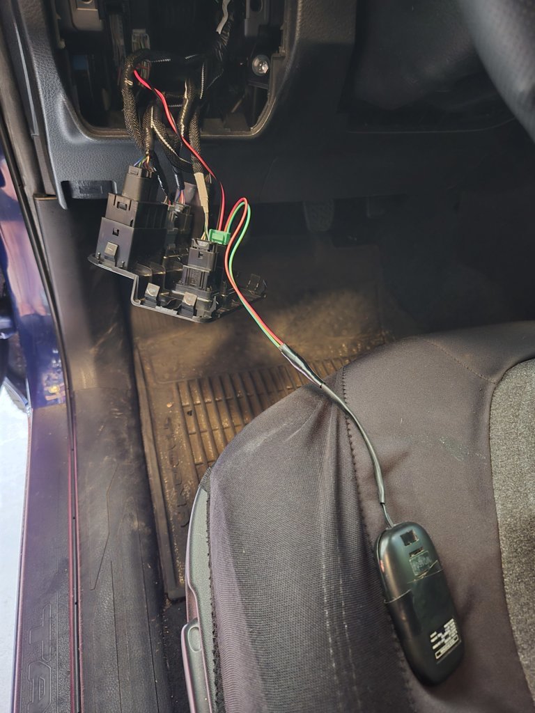

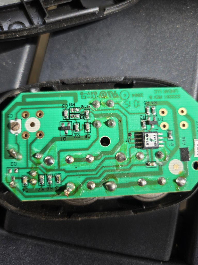

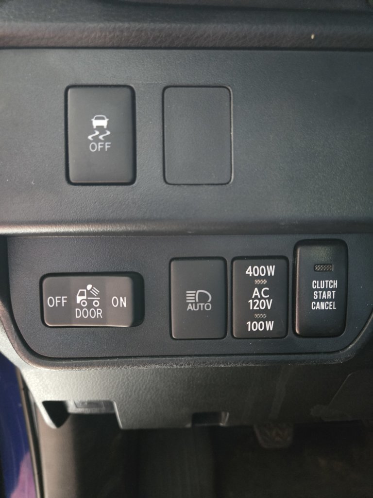

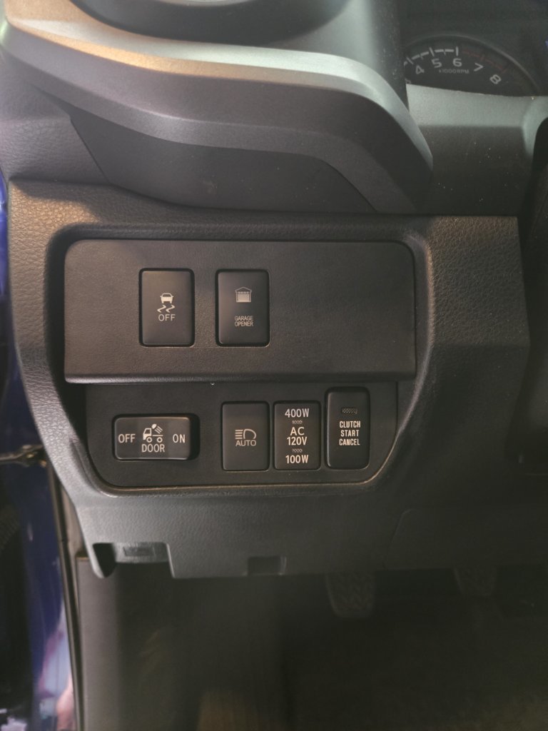

    Garage door opener with OEM style switch! Easy and cheap mod. Filling up those empty switch spots on my lower end TRD Sport model:)
    Wired in the two leads from the switch onto my existing garage remote. Then tapped into existing dash light and ground. There's a good thread here on TW with a more in depth install. It works great, and I don't have to open up the glasses holder to grab the remote anymore. Highly recommend. I used this switch off Amazon

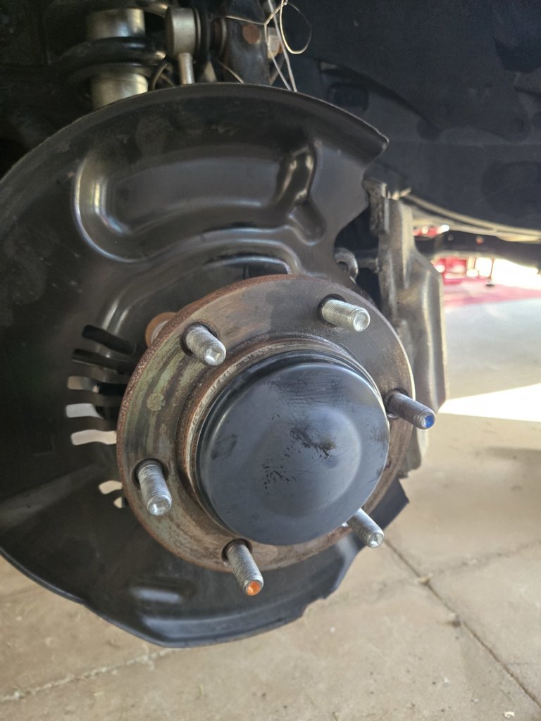

    I broke a wheel stud a little while ago after wrapping up my front lift install. Gave her wayyy too much umph while torquing the wheels down (stupid, I know). Finally got around to replacing it. Easy job.

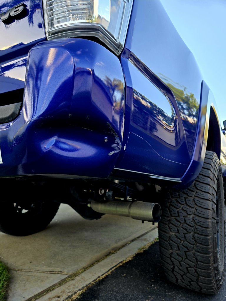

    My first wash, clay bar, and wax since I bought her brand new last year. I absolutely hate doing this. But I should probably do it twice a year.
    Also first carnage. I backed into a guard rail while getting a spot to camp out for surf competition. Time for a rear steel bumper!

    Replacement bumper caps are easily found online, check eBay. Clean truck!
