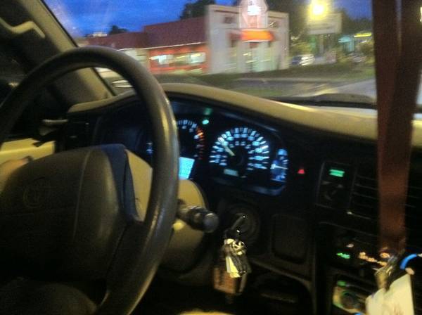

    im about to swap to Blue LED's (had them months just finally have a day off this week). Mine were green stock, I swapped to Blue (turned green) white, red, and currently have amber. Its not hard to do especially once youve pulled dash apart a few times. This is all my guage cluster. On the otehr stuff I went white then white LED's. I like the white look.

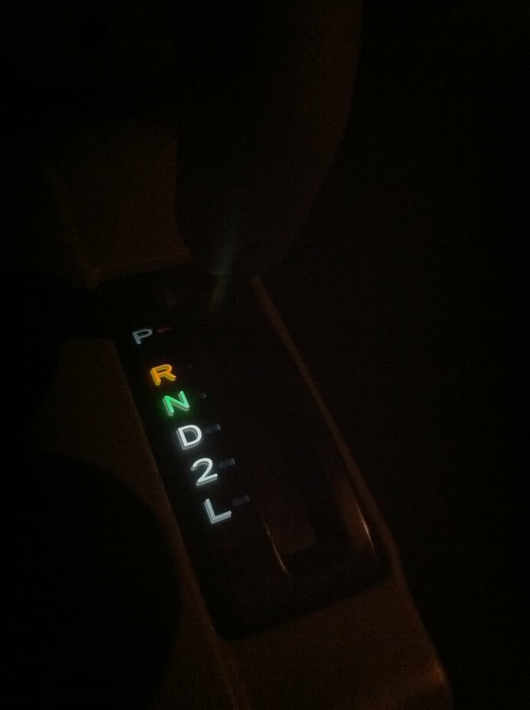

    and here is my white, 360 degree L.E.D.s. youll need 4, 194 bulbs.

    hmmm..idk why they look warm? mine are so white i have to dim them!
