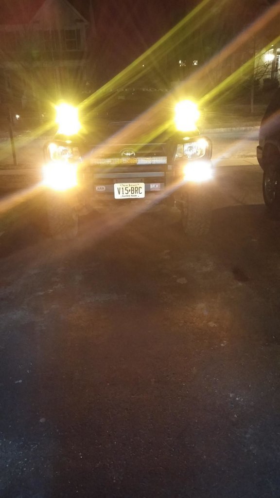

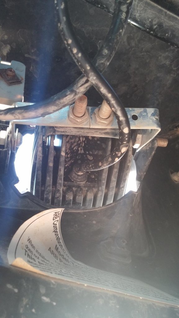

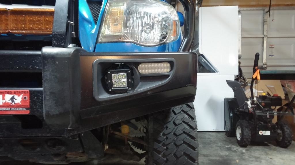

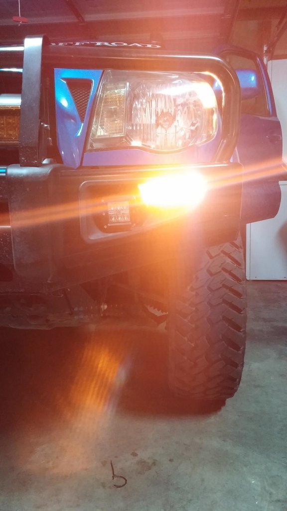

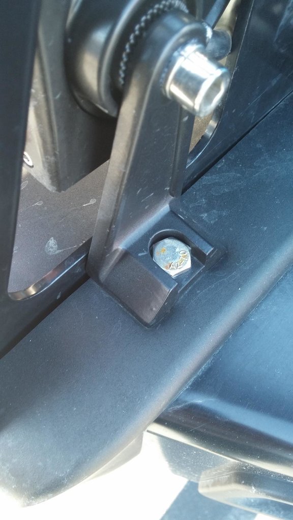

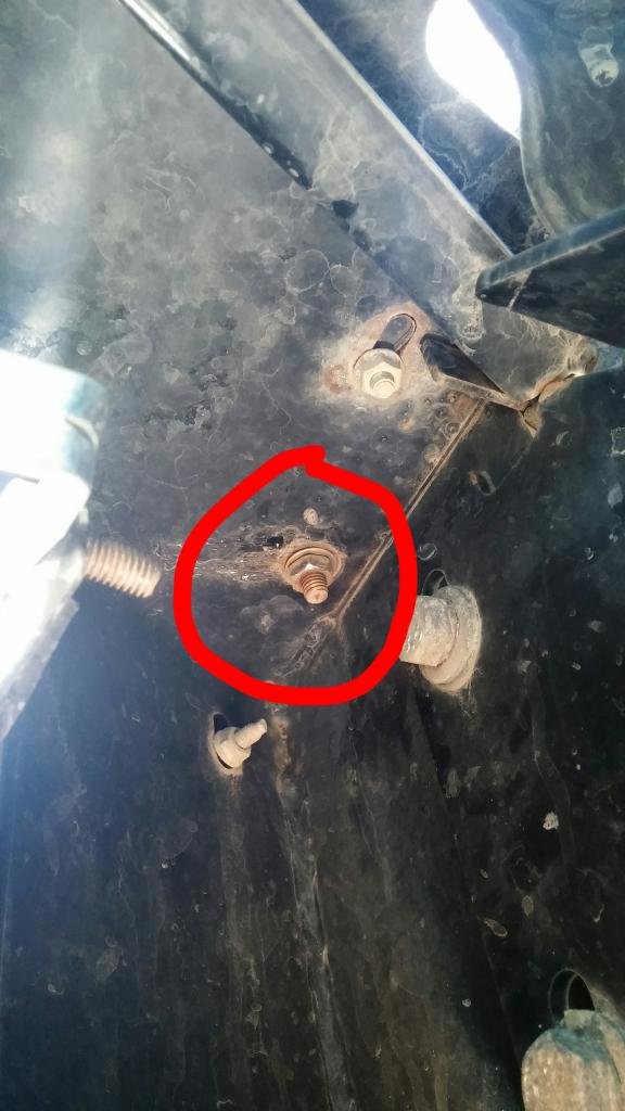

    Here's the pics you asked for.. for the bar, i just drilled through the bumper and bolted it down really tight. hasn't moved a bit. The fog lights took a little bit on engineering because the ARB fogs mount on the side and the pods mount on the bottom. I wound up using bolts and "L" brackets to make sort of a custom cradle mount.
    The LED Light Bar:
    Underneath:
    0110151430a_zpskulicdk_edit_142091865072_b229d3e942e983a20d252280f8cc326c071f874a.jpg
    The LED Pods Mounted:
    Yeah im in Barnegat, but i'll be back at school soon down near hamilton soon. The NJ thread has a lot of members and we try to wheel as much as we can :cool:

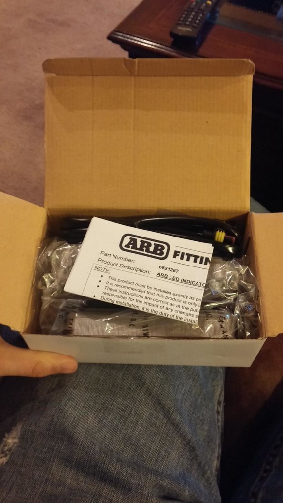

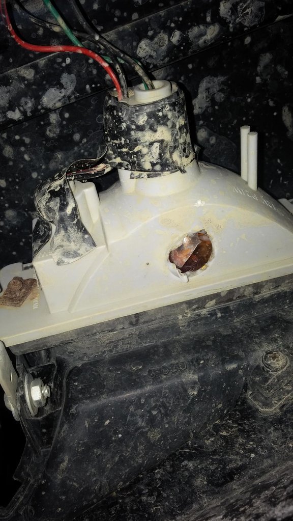

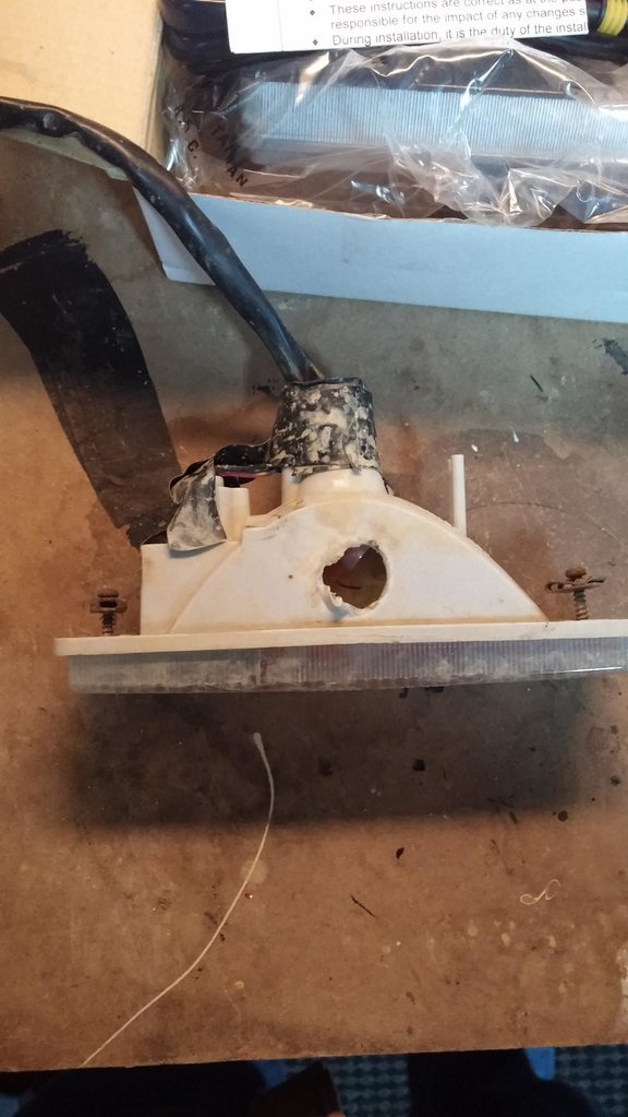

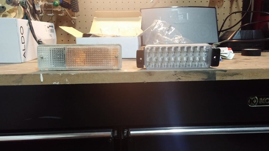

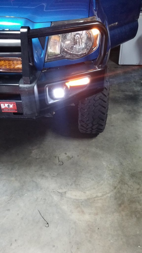

    Changed out my ARB indicator lights today with some ARB LED indicators. These are WAYYYY nicer then the old ones and are made much better for water/dirt/dust/grime etc.. After constantly changing bulbs when water would get in, one of the indicator lights actually melted from the heat :confused: and that was the last straw haha
    This is a comparison of the old vs new lights.. Notice no more amber refection lenses which makes more a better look IMO
    Installed and turned on :cool:
