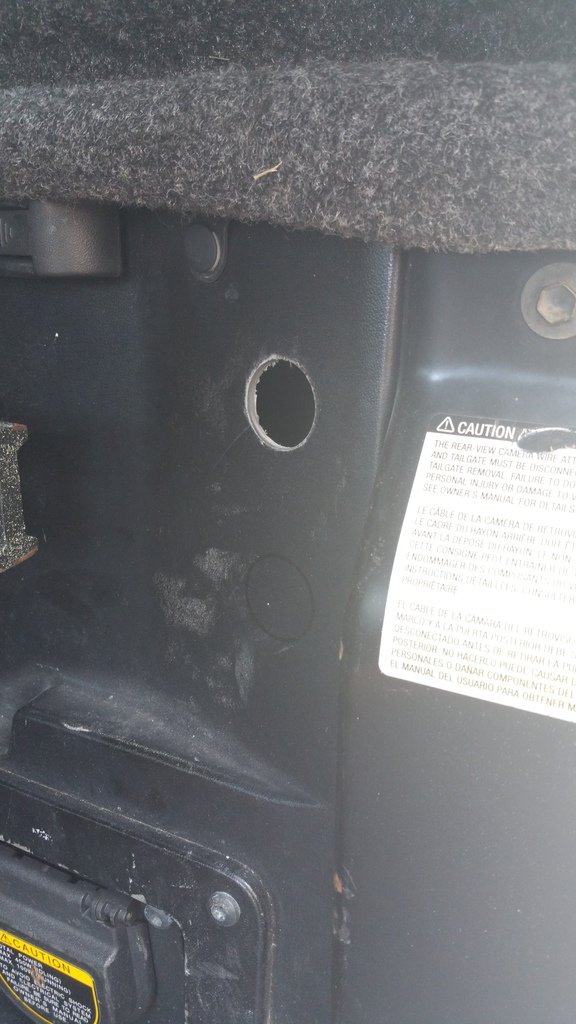

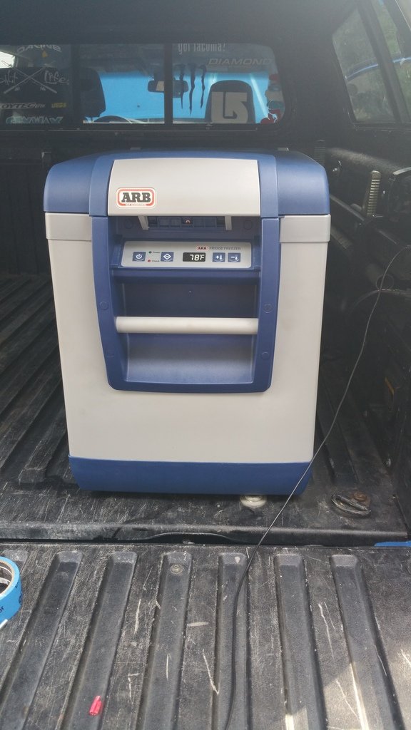

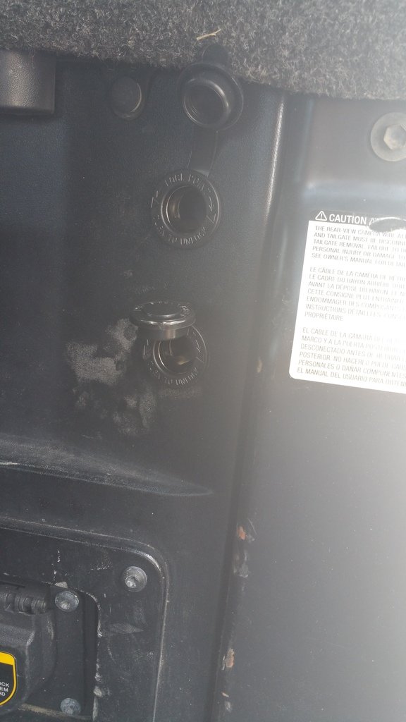

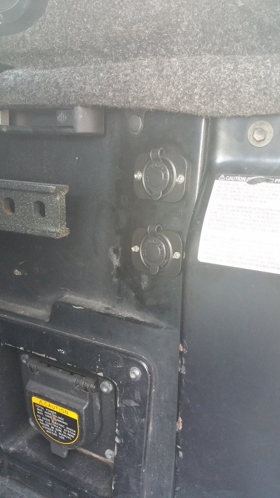

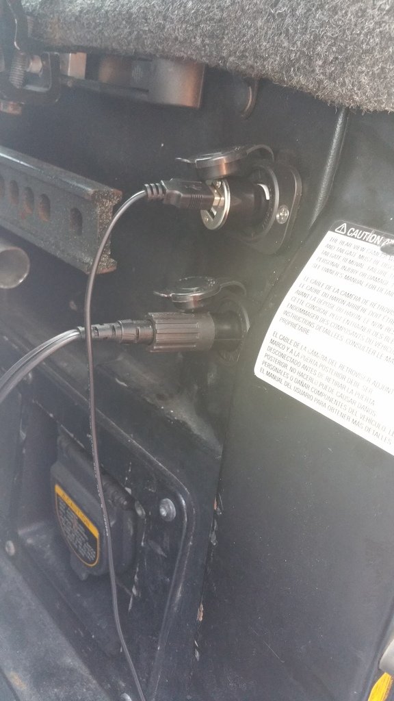

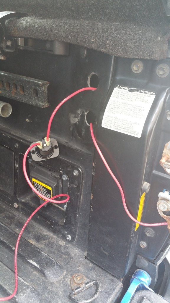

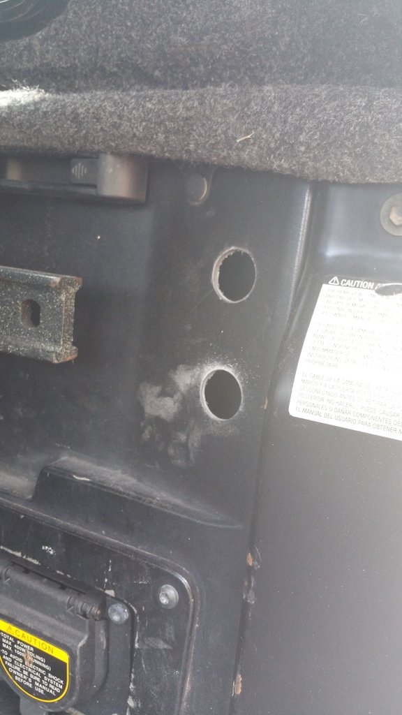

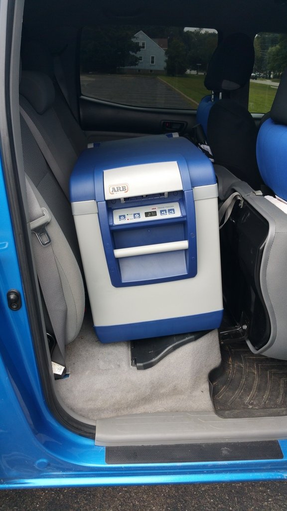

    With the new fridge, it was time to add some power to the bed of the truck so I copied @Chux idea and ordered some blue sea 12V plugs from Amazon. These plugs will always be hot, and will be used for running the fridge and whatever other accessories I need back there. Install was pretty straight forward but here's some pics I took during the process.
    I traced and used a 29mm hole saw to cut out the spots where the plugs will go:
    Both holes cut:
    Test fit of the plugs:
    Running the wires:
    All finished and mounted:
    Pirhett, Chux, Acerwin and 3 others like this.

    I've been sitting on that mod for a loooong time now.. lol Procrastination is an understatement.
    looks good man! did you tap into anything or run new leads the whole way for the constant?

    Thanks, this is definitely gonna be a useful mod, i have another setup for in the cab i need to install as well. I didn't tap into anything for the install just ran them to my blue sea with a 15A fuse

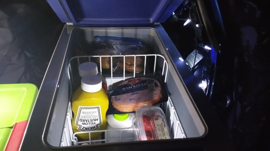

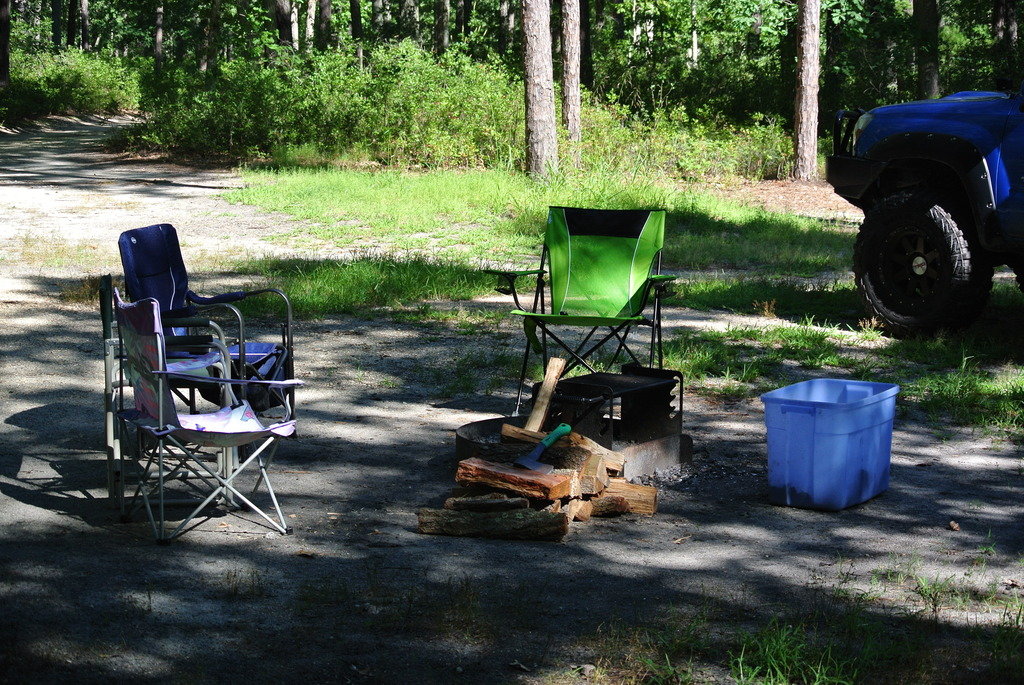

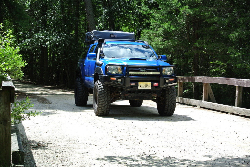

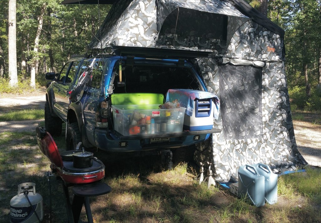

    Just got home from a 3 day camping trip in Wharton State Forest. Got to test out the new ARB fridge and 12V plugs I installed in the bed. Heres a few pics of the trip:
    Loaded up and ready to go!
    Crossing Hawkins Bridge on the way in:
    Here is what camp looked like:
    Fridge filled up:

    I need to do the wires to my bed for my fridge. Trip looks fun buddy

    Such a useful mod.. I installed 2 so i was able to run the fridge, and charge my phone at the same time while the truck was off. Worked great for the trip

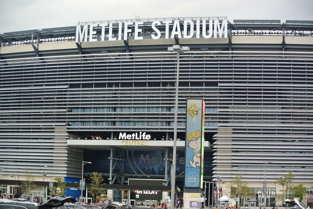

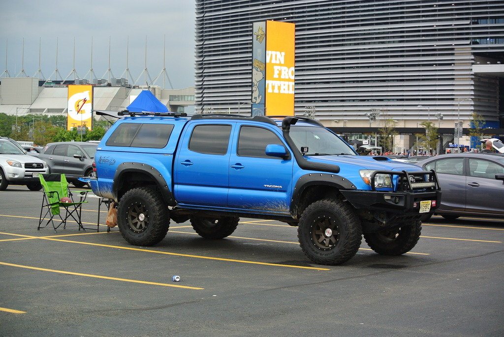

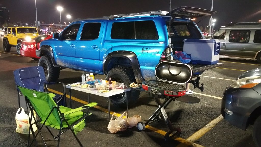

    Went to the Bruce Springsteen concert at Metlife this past Thursday and all i can say is wow.. Seen him about 5 times and everytime it just gets better and better. He played for 3:59 which broke his record for his longest show played in the U.S. no breaks, no intermissions, just 4 hours straight. Anyway, got some pics of the tailgating setup just to show that the setup i have is great from camping in the woods, to tailgating in the parking lot, used the fridge and grill again and everything worked flawlessly. Now time to get an awning!!

    2015 Black Tacoma TRD Offroad
    - Matte Black Plasti Dip Front Chrome Grill - Method NV - 285 KO2 - Full Kit 5100 w/ AAL - LR UCA
    What type of shell is that?

    09' DCSB 4x4 TRD Sport
    Its an ARE Z-Series
