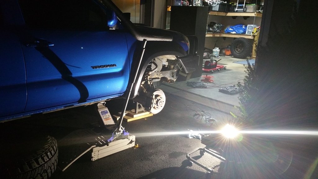

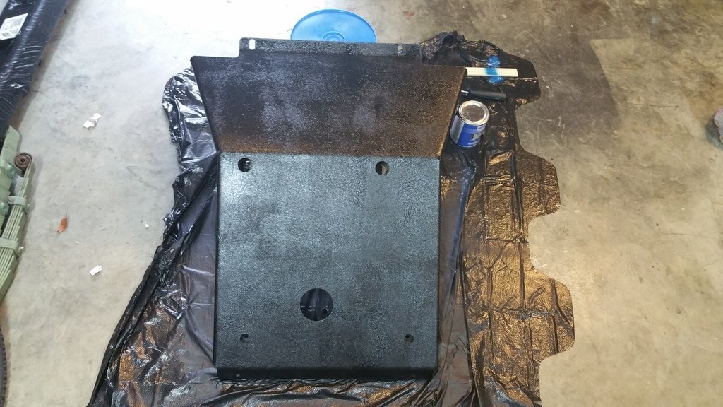

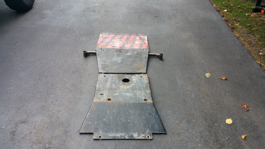

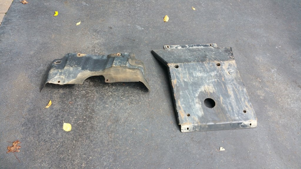

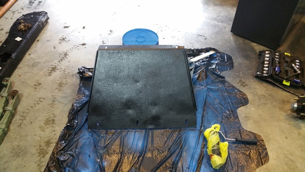

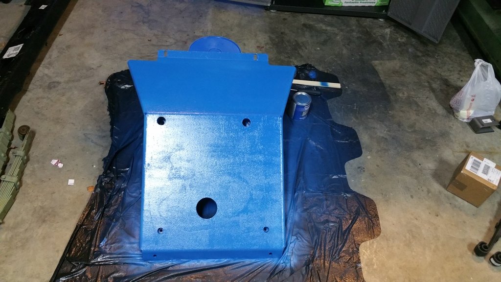

    Some updates.. Picked up a set of skids from a local member (@nj636). IFS skid, trans skid, and t-case skid. I proceeded to power wash them and clean them up the best I could, then prepped them for a fresh coat of bedliner. Decided to through a couple coats of blue on the IFS skid to see how it looks and I'm kinda digging it so it'll be blue for now
    Full set:
    Old vs New:
    Bedliner and Paint:
    Gonna put the IFS skid on tomorrow after i FINALLY remove my sway bar. Then gonna get my exhaust rerouted so i can bolt up the other skids! Sliders are going on soon as well!

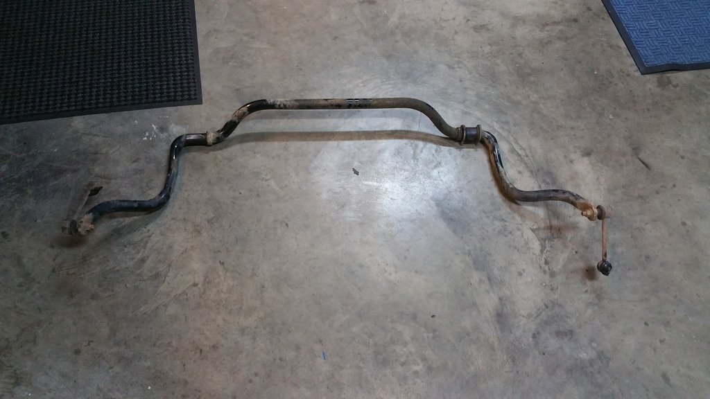

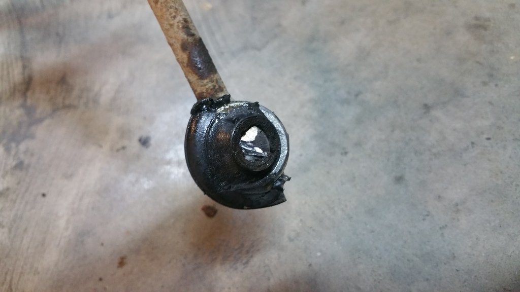

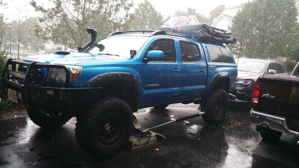

    Holy shit the sway bar removal sucked. just about every bolt was seized up, but its out.. and unless i buy new end links, its out for good because i gave up fighting them and cut them out.
    Here is how far i got before mother nature said take a break:
    Finished one side and was on to the next:
    And here it is in its chopped up glory:
    Skid will go on tomorrow

    when i took mine off my 2010 i had the biggest pain because doing it by myself couldn't thread it out. Ended up taking off the stock front skid and supports and took it right through the front.
    you're going to notice how differently it rides, corning it will lean a bit more, but as long as you don't drive it like a race car you should be fine. I really noticed it on long off/on ramps on the highway. Other then that it seemed to ride a little better over bumps, and offroad it felt a lot better, truck wasn't so "tippy" feeling going over stuff
