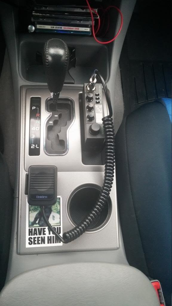

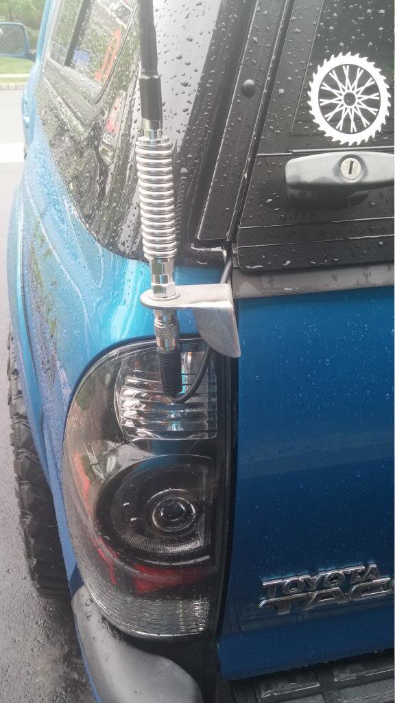

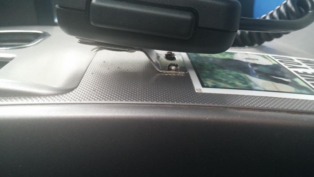

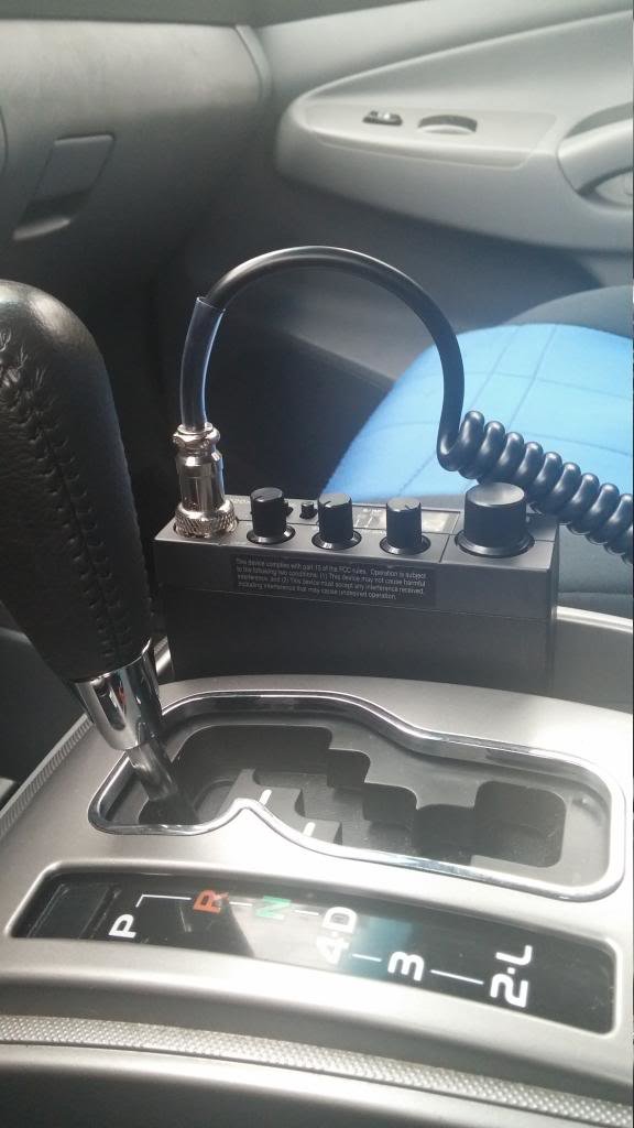

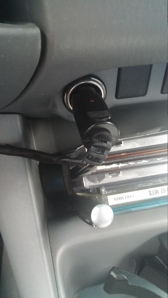

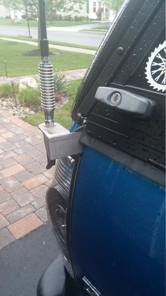

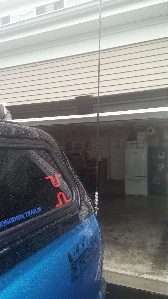

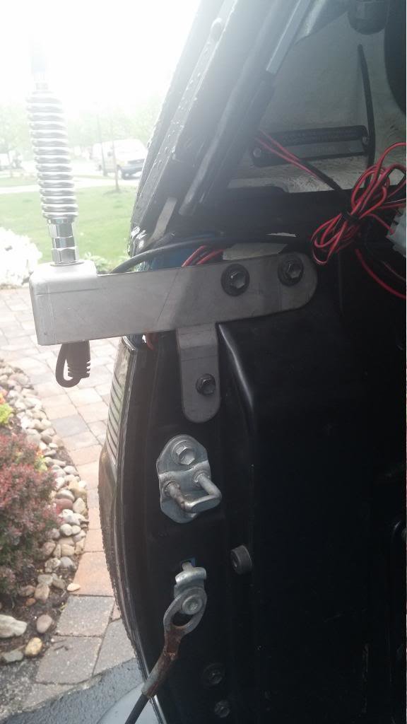

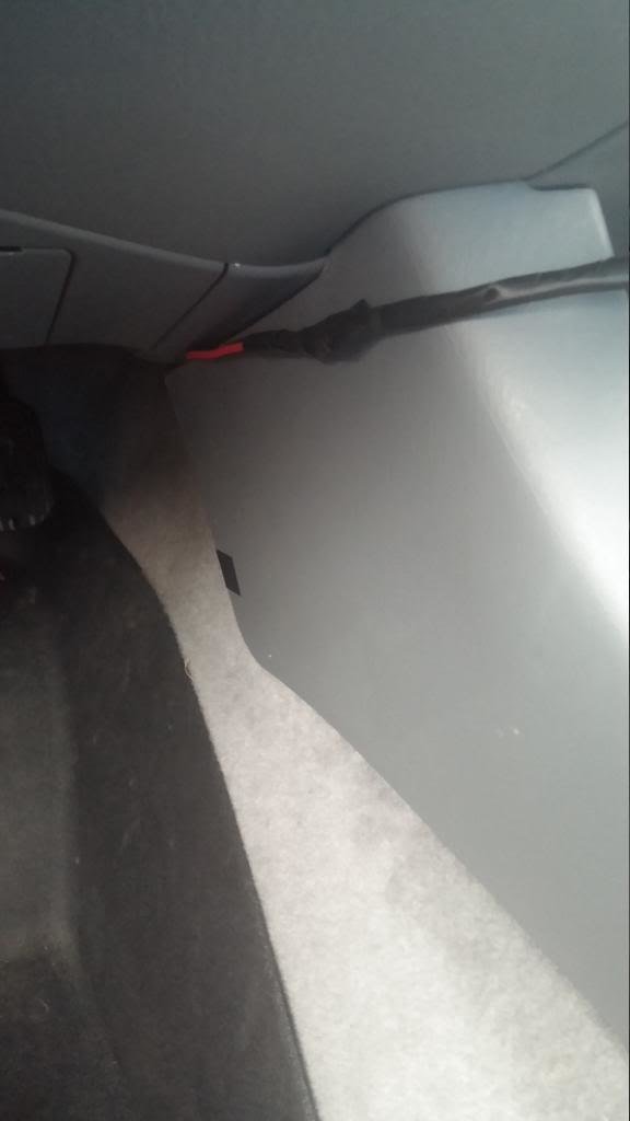

    My BAMF tailgate antenna mount came in today so I finished my CB setup :woot:
    The Setup:
    Undien Pro 520XL
    18' wire
    4' black FireStik
    CB "L" adapter for coax wire
    Walmart accessory plug to power it
    Basically, I like everything to look clean and "stock" so i decided to dremel out the little coin slot and fit it nice in there. In this spot, I'm able to hide all of the wires and it looks really clean and nice. I also bought the "L" adapter for the wire which allowed me to push the CB down pretty far.
    This is how much it sticks out
    Drilled 2 little holes to mount the mic
    This powers it and is the only visible wire
    BAMF tailgate mount
    The Firestik :cool:
    Im really happy with everything and it was pretty inexpensive for it all.. probably around $100 for it all so I'd say its a pretty good deal :D

    Looks good, but why don't you use an add-a-fuse and hardwire it to the fuseblock that is inside the cab?

    Thanks dude... I actually didn't even think of that. If the plug ever craps out ill go that route. I don't smoke or anything so the cig lighter is never used so for now it'll be fine

    Love where you mounted your cb box in the console...nicely done. may move mine
