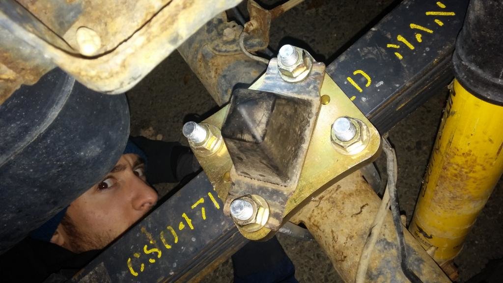

    I also found a way to install my stock bumps onto my flip kit.. Been holding on well and works great so far.

    Was there any modifications needed? or just turned and tightened bolts?

    I uswd a hammer to flatten out the bump stop, where the u bolts used to hold them on.. Then took a grinder to it and widened out little divet to nake it large enouge to fit bothe bolts. Also had to grind the divets deeper

    Hmm I might have to do this. Thanks!

    No problem man, really easy to do.. Just mock up some kines of where you wanna cut and then just start smashing and grinding haha
