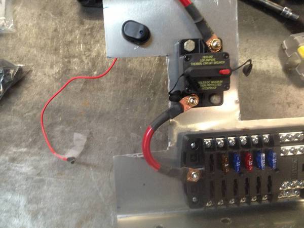

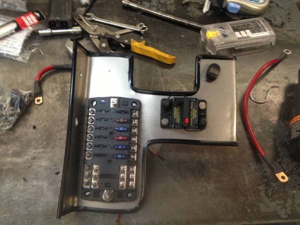

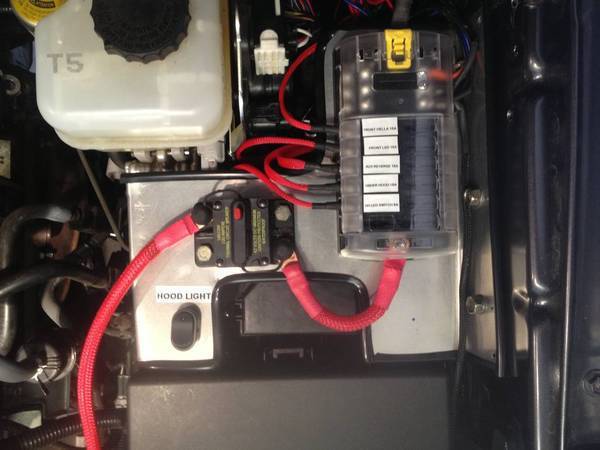

    Another thread on Blue Sea Fuse Block install. I know there are several of these around, but each one was useful to me, so I am adding mine in hopes it will be useful to someone else. Enjoy.

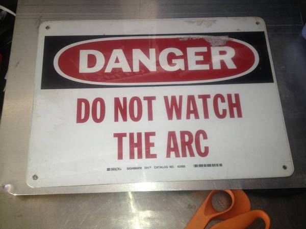

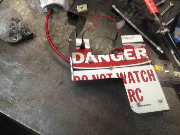

    Step 1. Find something to make plate out of. I am cheap. The shop has too many safety signs already!
    After it was cut
    Edges were a little rough.

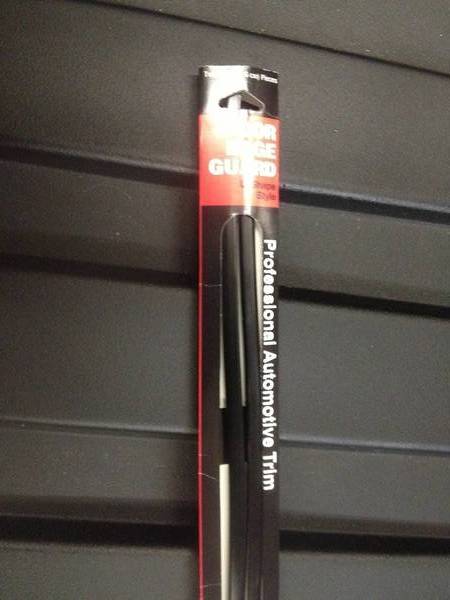

    Found this at Pepboys $2.99.:D
    Heated it with a heat gun to help mold it into place

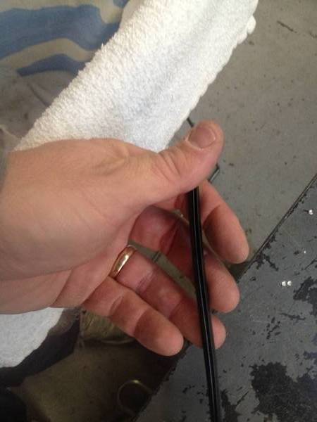

    Used some Techflex to tidy up the wiring.

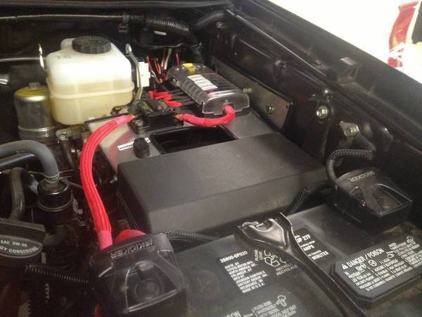

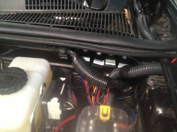

    Everthing is tight on the 2012. I can still open the small fuse block.:cool:
    Mounted the relays on the firewall out of the way. Labeled them for future trouble shooting.
