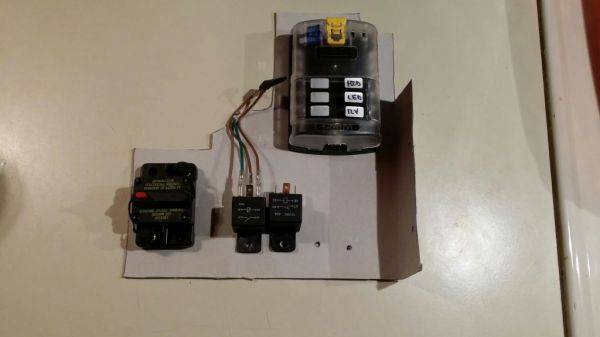

    This was my switch panel in my Duramax...
    All of the toggle switch wiring was run from a piece of ethernet cable and a 3a fuse. Made it really easy to run the wiring to the relays, which were housed in a Pelican box mounted to the shell.
    Each lighting circuit had its own fuse. The 6 circuits (the 4 100w overhead lights were split between two relays) were split between two 30a runs from the battery on 4ga cable.

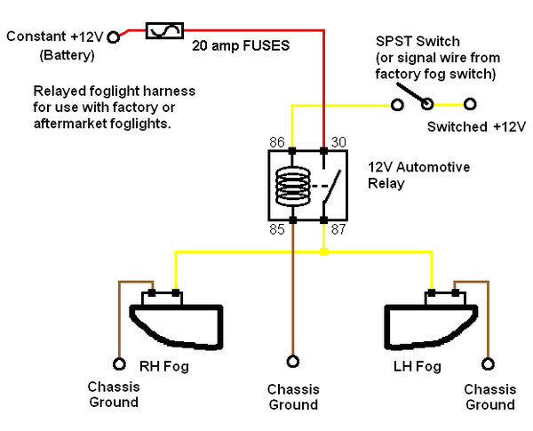

    ok found this
    where the hell else can #6 on the switch go I have no factory fog lights and I get that #2 on the switch goes to the cig lighter, but I will have 4 switches wont putting all of them to the cig lighter overload it?

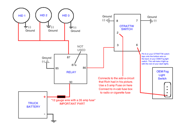

    Hehe i made this diagram :D

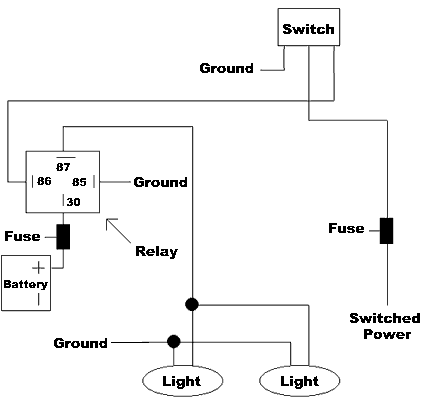

    Just do this.

    I'm going to need it dumbed down a little but with the diagram, more pics or explaining please.
