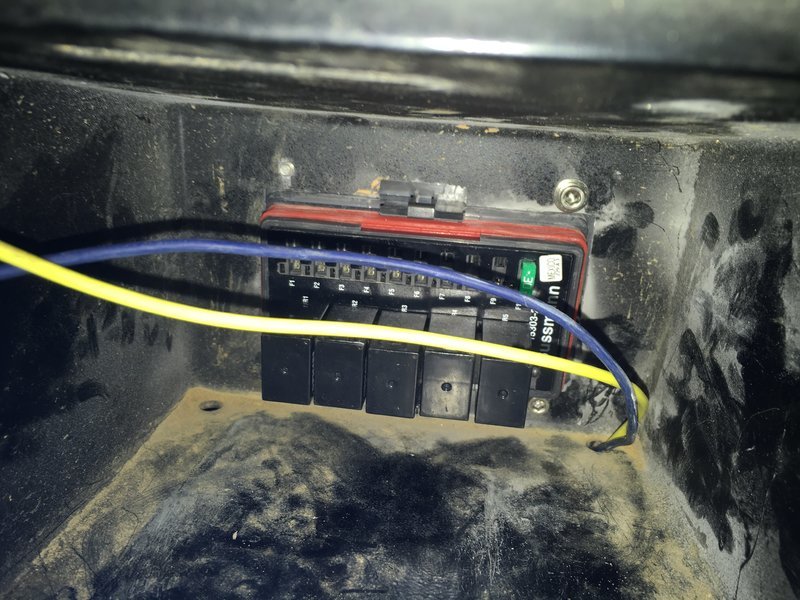

    @Acerwin has a Bussmann Relay Box in the bed cubby.

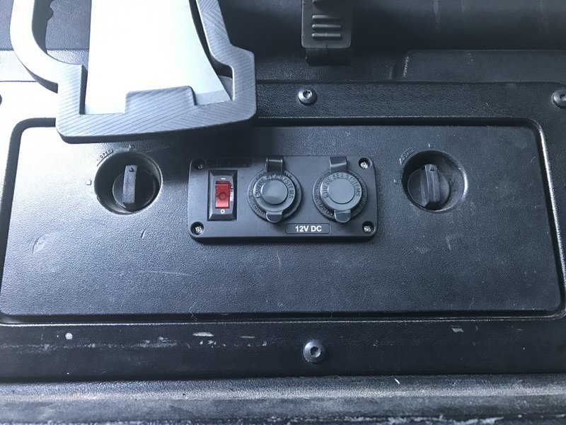

    This is where I mounted it.
    So far it has worked really well. I use it to power my shell lighting, and camp lighting, and to charge phones or such when at camp.

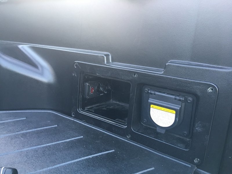

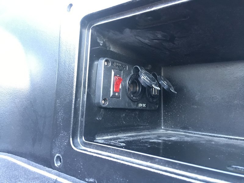

    Here some pics

    I have the Off Grid version mounted in my small cubby door on the passenger side of the bed.

    I'm curious why you mounted this to the outside of the cubby door and not the inside?

    It is already a waterproof setup, and by mounting it in the door, it is easy to access the backside if needed. Plus I don't have to take the door off to hook stuff up to it all the time.

    Why did you choose to mount it on the passenger side? I'm contemplating the driver side simply because that's the side the battery is on.

    Gotcha. Thanks man.

    Inside the Cubby is the Bussmann RTMR Relay box(link in my sig), and on the outside of the door is USB, 12v outlet, battery guage, and switch.

    The Bussmann Relay box is a Power managment system. Pics and more details in link in my sig.

    Not my pictures, but I saved these so I can copy the install.
