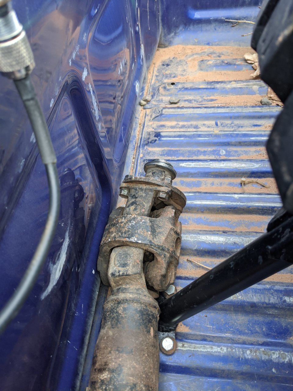

    Went wheeling today. No pics for now.
    Was coasting at about 35mph on the drive home and it felt like the truck popped out of gear...after checking several gears I threw it into 4wd and pulled into a parking lot
    The DS CB nut stripped the thread and the DS came apart. Glad I caught it before the DS totally came apart and vaulted the truck off the pavement. I was pissed at first because I thought I grenaded the rear diff :homer:

    Damn dude. Glad you caught that in time

    Actually twisted a driveshaft in two at a little over 100 mph back in the day. Took almost a half mile to get stopped with the back half of the shaft steadily digging onto the pavement.
    Wasn't my time to go....

    That sounds like it wasn't a very fun ride. I'm glad I avoided something similar on HWY 24

    Wow that's crazy! Did you stake the nut when you installed it? Thanks BTW now I'm going to be paranoid since I cut an inch off that threaded CB shaft when i stripped the threads on it being a dumbass.

    I did not :homer:
