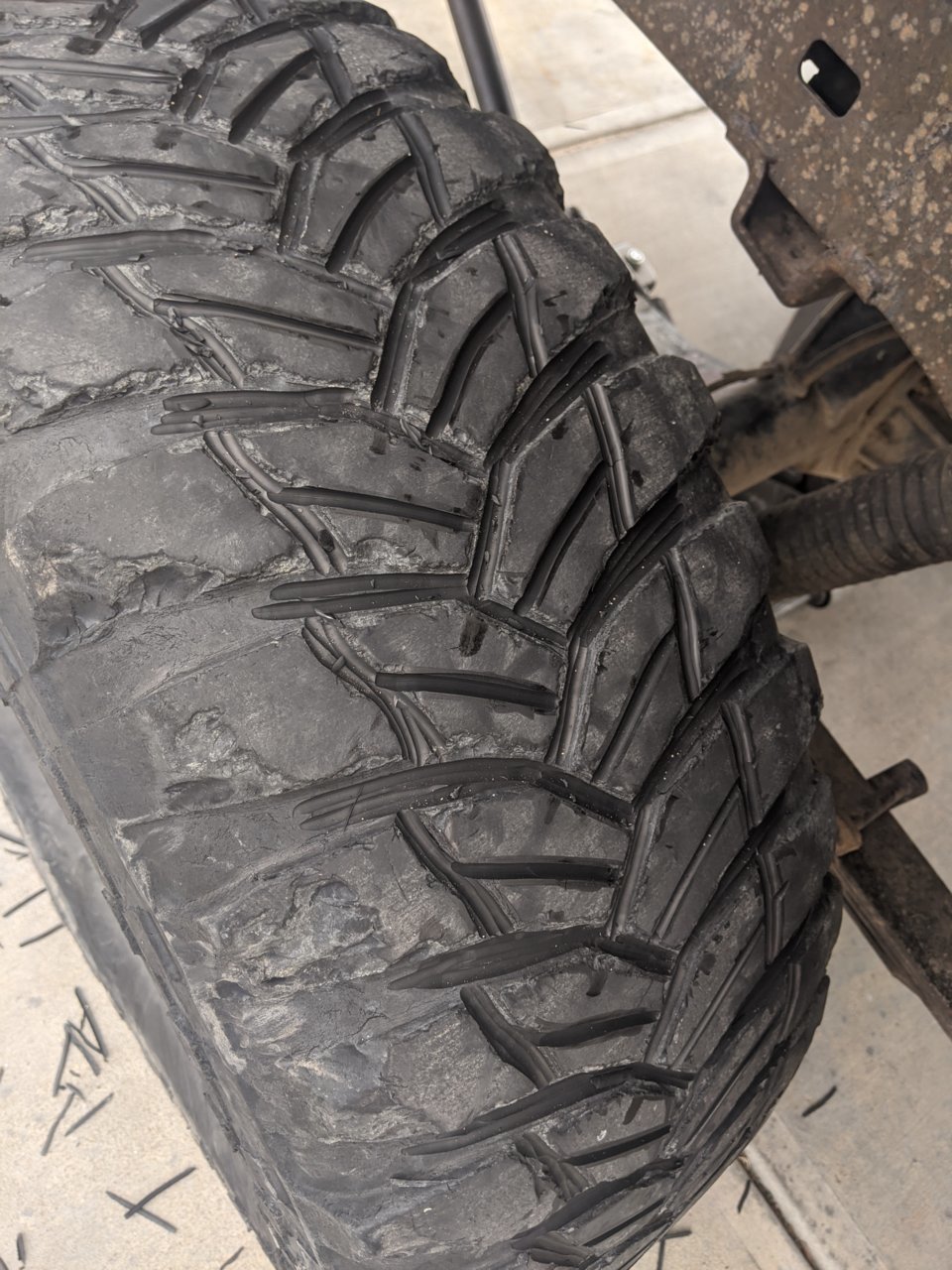

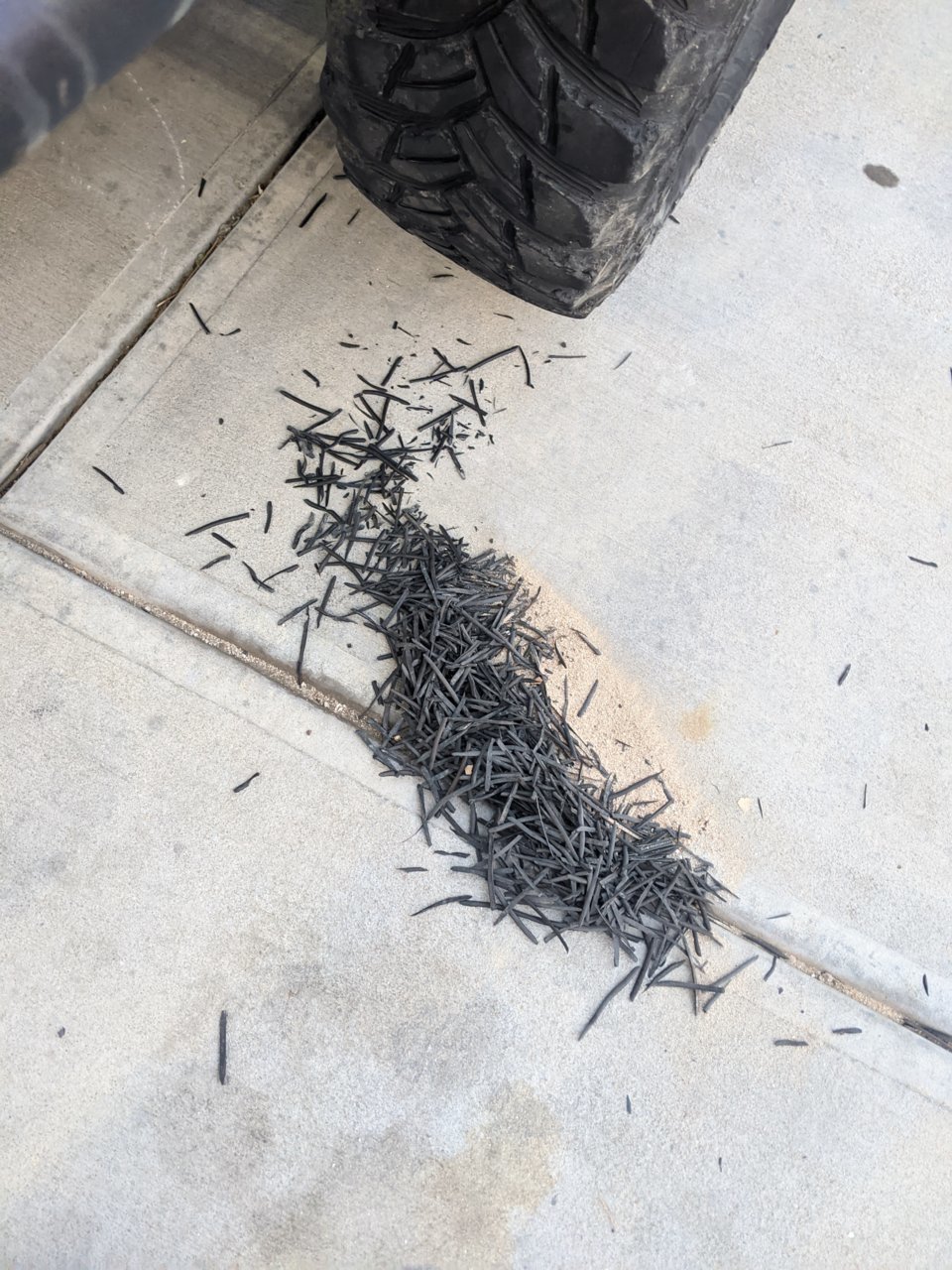

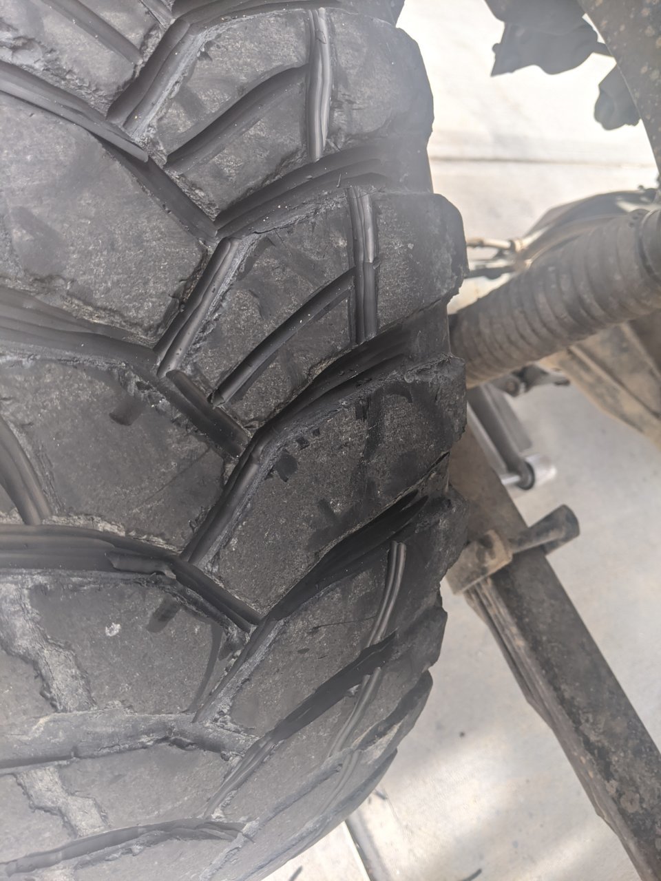

    Been poking at some stuff on the truck. I pulled the belly skid off and adjusted the tcase parking brake so it works again. I've also pulled out the groover and put a little more tread on my two low tires before working on my washer bottle setup.
    here you can see what it looked like at the wear bars on the outer blocks.
    I wish I had the larger head with a square blade as it would have turned out cleaner than multiple passes with the round blade but ya gotta piss with the cock you've got :burp: it is fine for a wheelin shit box.

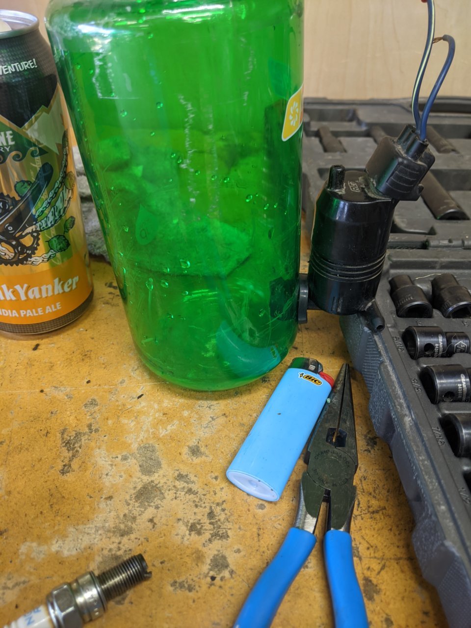

    I've had this bottle installed between the airbox and core support for a while but it's never worked well. I tried to use a straw hose setup through the lid and these pumps do not provide the suction required. I pulled it out and drilled so I could add the grommet and pump from the factory bottle. It ought to work a little better this way. I still need to wire it up.
