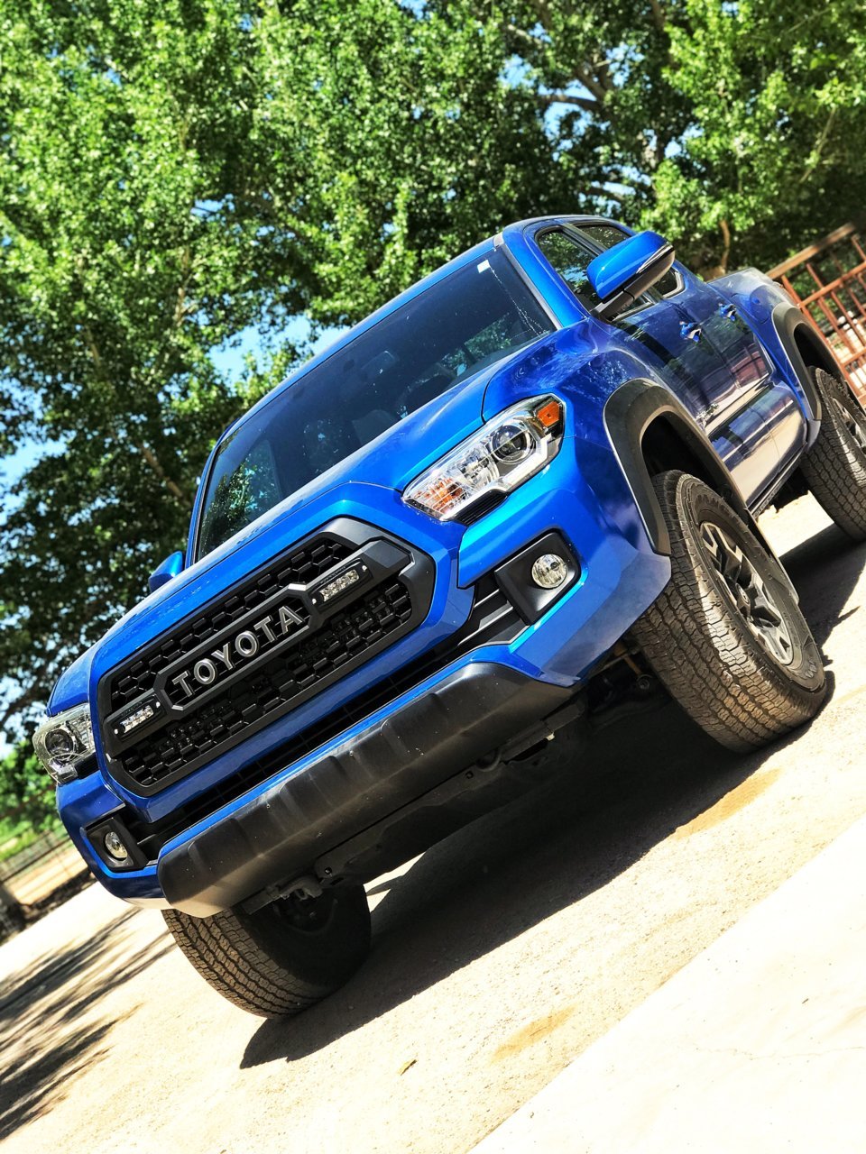

    Finally pulled the trigger on a fully loaded 2017 turd gen, picked it up 2 weeks ago in Denver
    basic info on the truck
    2017 Double Cab Short Bed
    Premium and tech package
    Blazing Blue Pearl
    4x4 offroad
    12k miles currently
    probably my favorite part was the price, picked it up for $31.5k... switch is a steal IMO.
    So far right now its bone stock, below is a list of what all i have done to it and what all is coming next. overall its going to be a very basic and clean build.

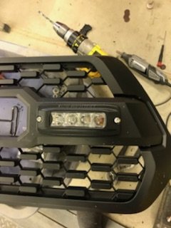

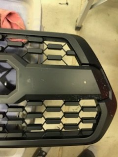

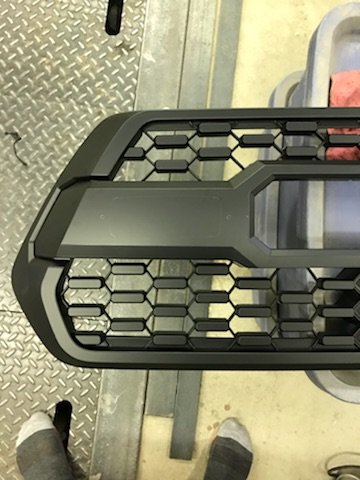

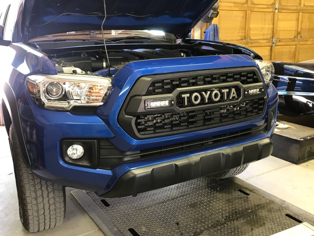

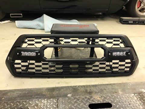

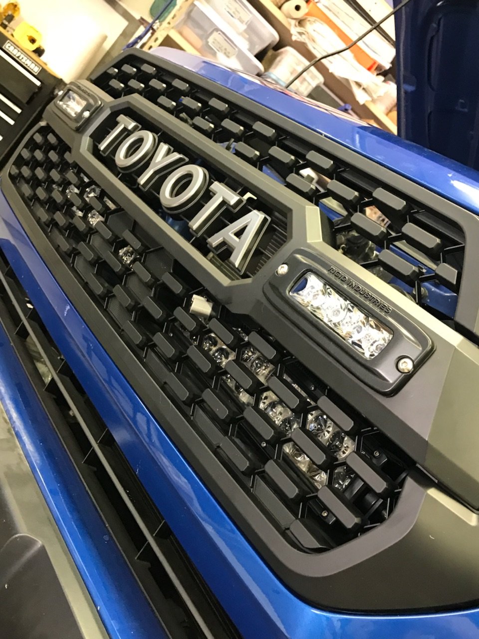

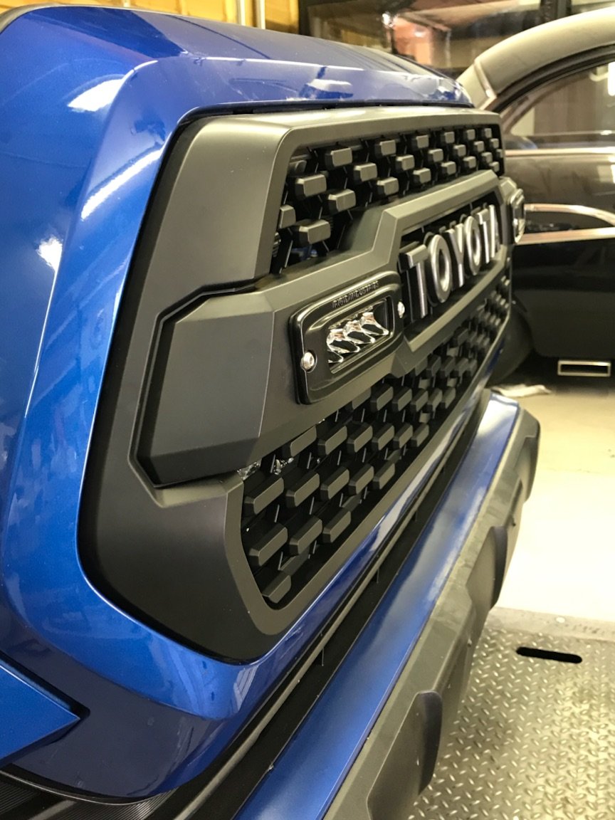

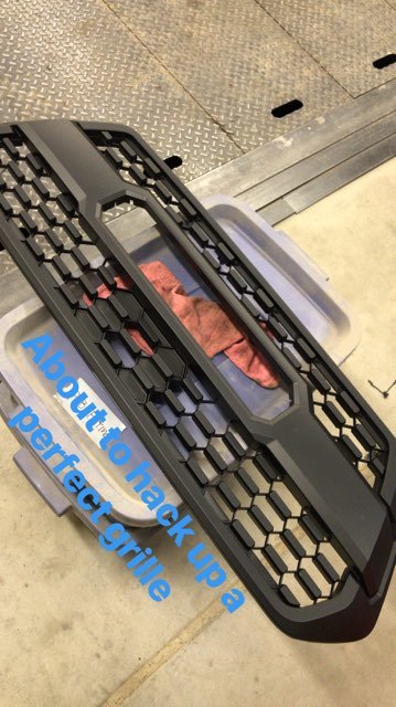

    Picked up a turd gen finally last week and had some Rigid SR-Qs laying around that i was planning on using for something so i came up with the idea of flow mounting them in the pro grille...
    so lets get into the process of what i did.

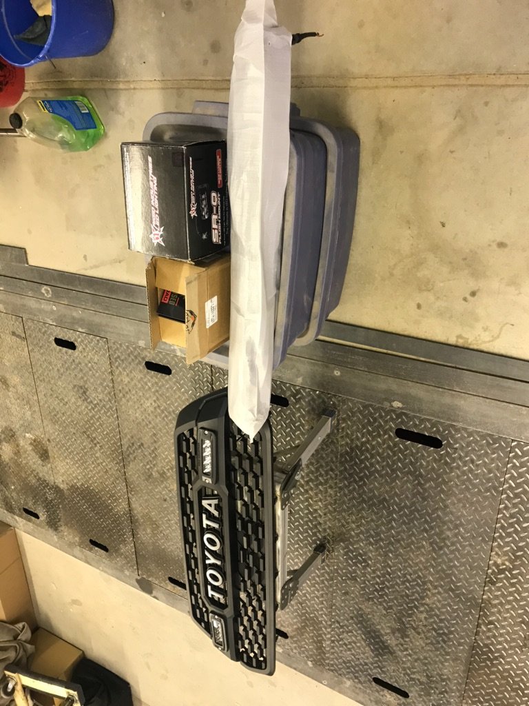

    Part 1:

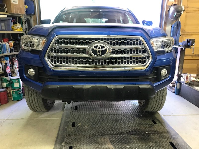

    https://www.ebay.com/itm/302693428094
    Buy a china pro grille, i got this guy off ebay for $150 and shipped in 3 days and arrived perfect condition and plenty of protection, should be getting the letters here the next day.

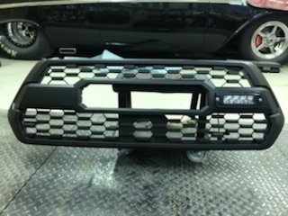

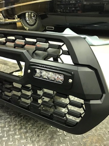

    Part 2:
    https://www.rigidindustries.com/led-lighting/925223

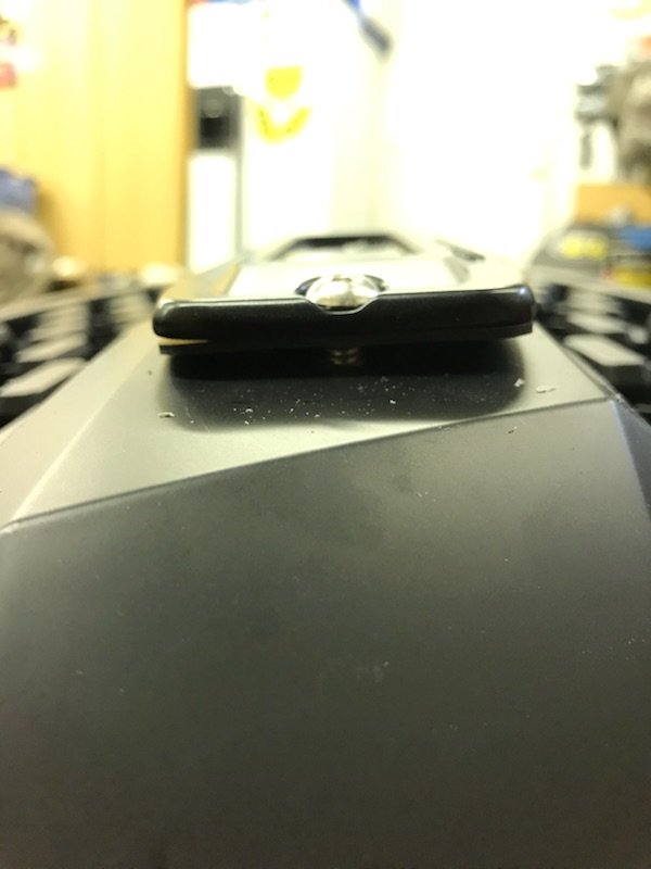

    Use the rubber gasket that comes with the SR-Qs kit and layout where you want them to go, as you can see there isnt much room to play with.
    what i did was just center the gasket vertically and then lined up the edge of the gasket with a vertical line around the main center section of the grille.
    Part 3:

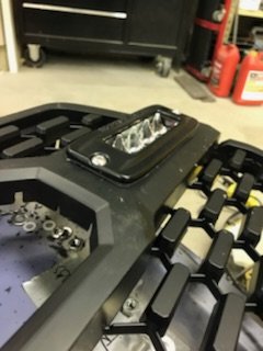

    Now for the fun cringey part, start hacking up a perfect good pro grille.
    pretty simple to do with a basic dremal. to cut one site out took me about 15 minutes maybe. sorry i forgot to take pictures of the fully trimmed opening.

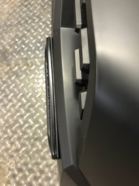

    Part 4:
    Trim your lights to fit real snug so edges don't peak out from the sides. The inside of the gasket works perfectly for a template but does move when your trying to trace it out.
    Dont mind the gap on the outer edges of the light, this will be snugged down when you fully tighten down the bolts.

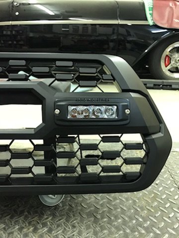

    Part 5: repeat to the other side.

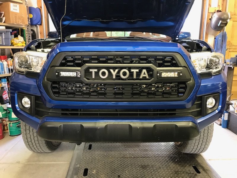

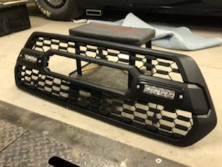

    Finished Pictures:
    Haven't seen this done before but i think it looks pretty good, wished i had got some midnight edition but could be easily switched out for different colors, light patterns, or even SRMs.
    Enjoy

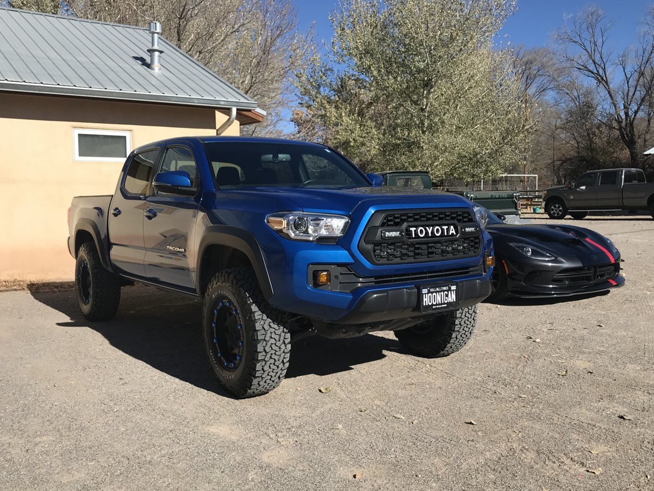

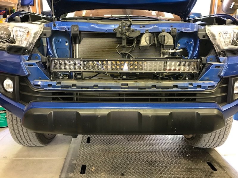

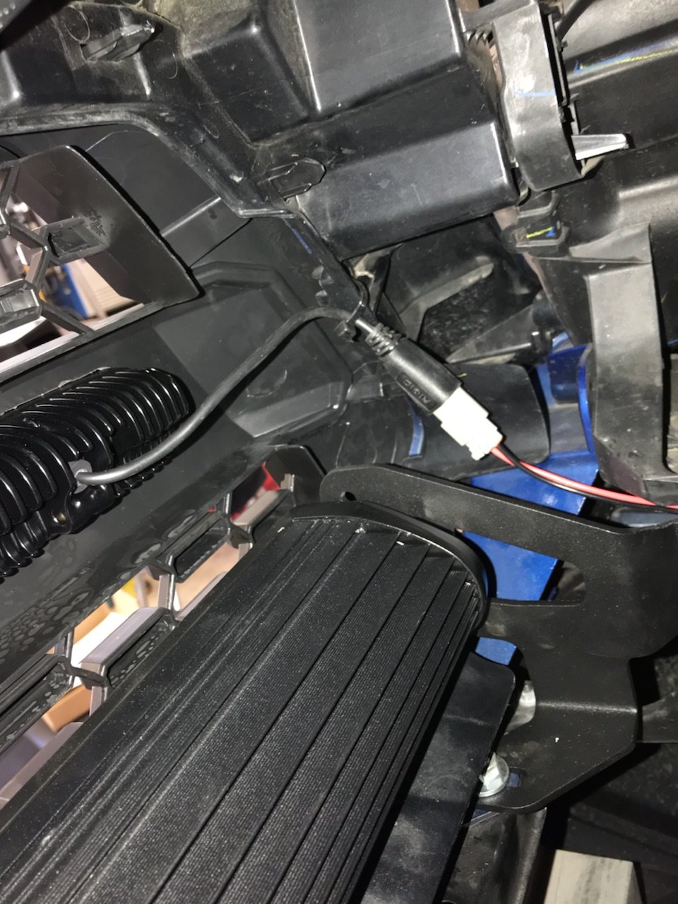

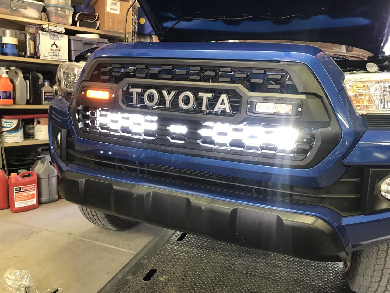

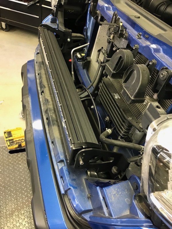

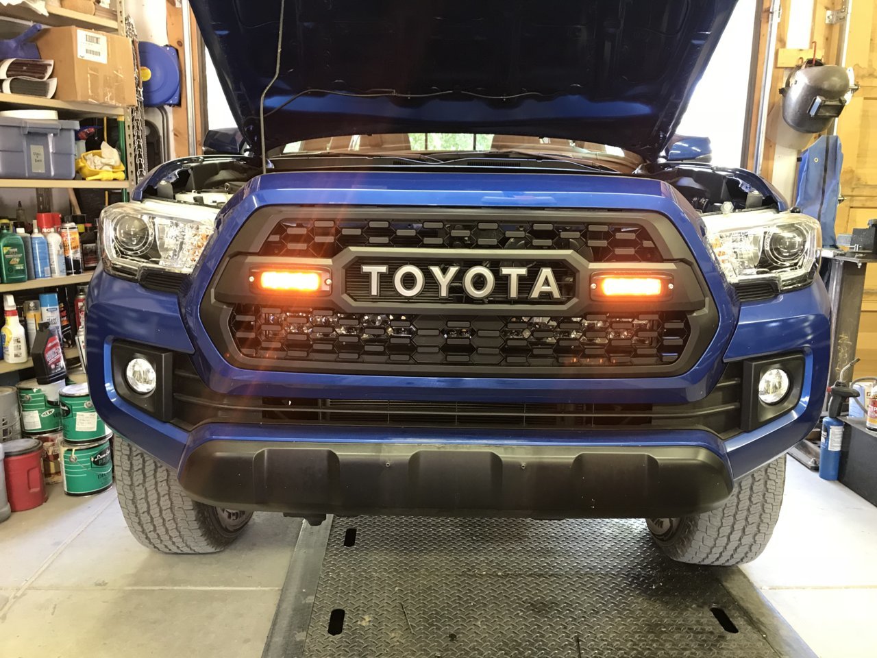

    update on the grille:

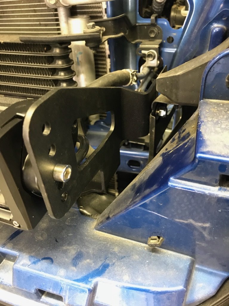

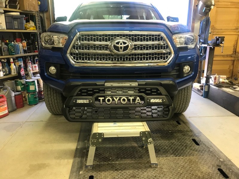

    so got it on the truck today, along with the grill i also did a cali raised behind the grille bar also for shits and giggles
    below are just pictures i took during the process. pretty self explanatory, enjoy.
    also got better pictures this time around.

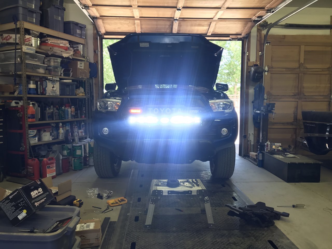

    Just did some light test
    Pulled it out of the garage
    schecter517 and pc3coyote like this.

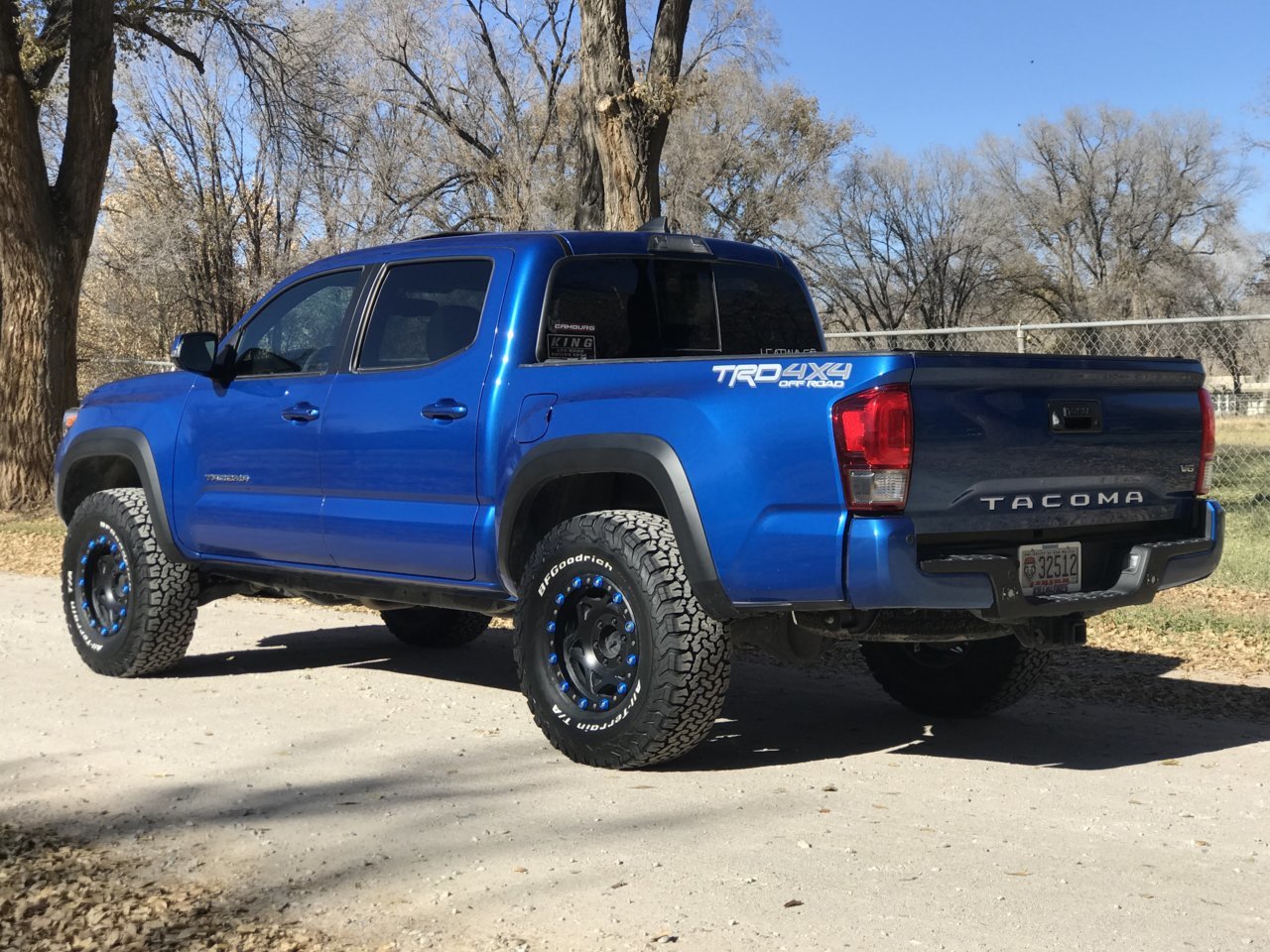

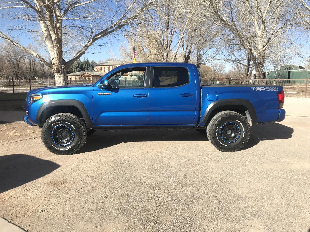

    Figured I’d update this.
    Put 285s on with a 1” level.
    16” walker evans
    Custom TRD bro badges
    Have new taillights on order
    And as of that the truck is done really. I was thinking of a hybrid bumper but 1500 isn’t worth it when I can buy bump stops for my race truck so this is done

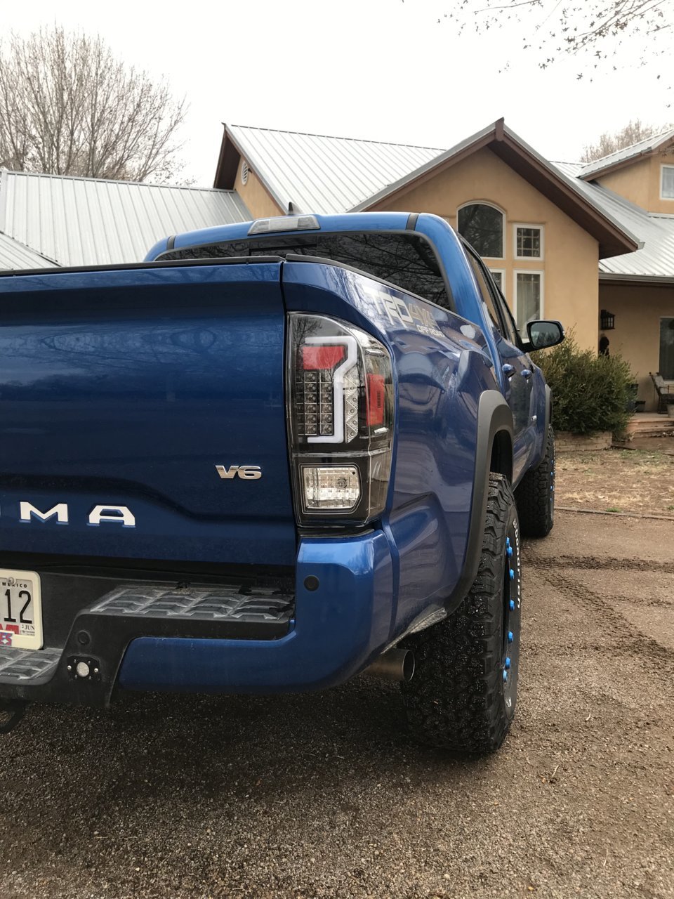

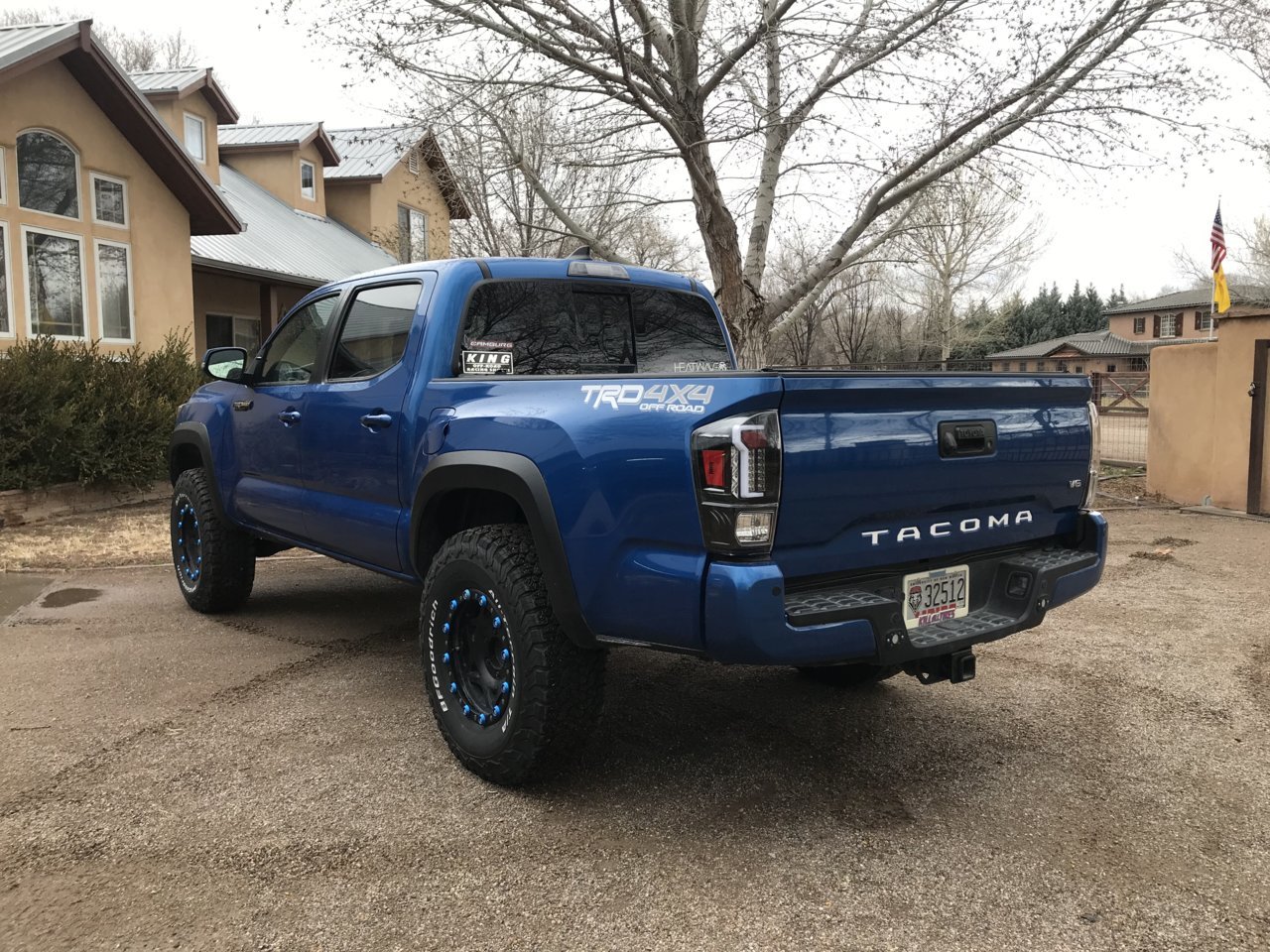

    New winjet taillights. Look badass. Up next will be a meso third brake light and then BHLM. Getting windows tented 15% end of this week
