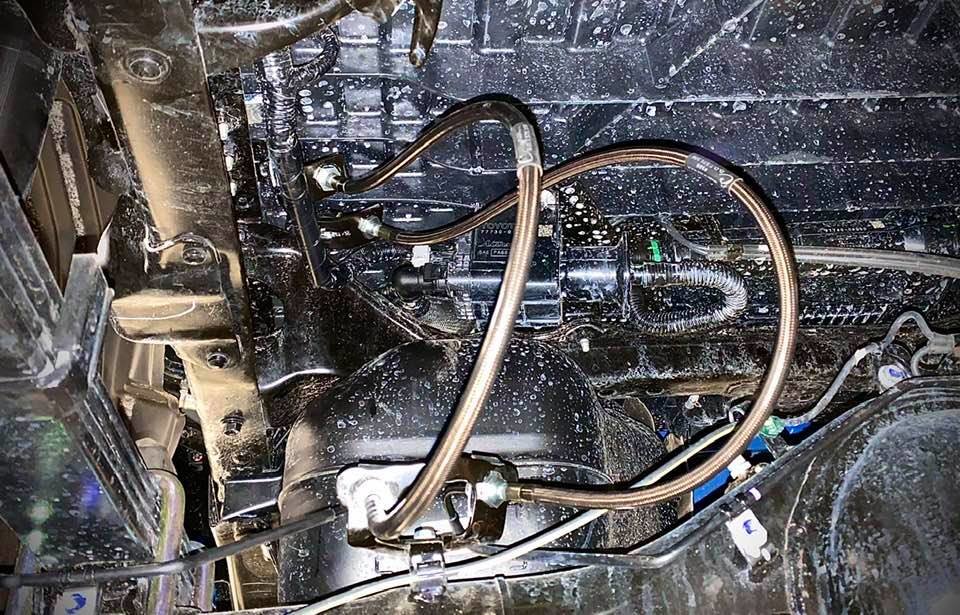

    2nd mod was an easy bolt-in. just extending the rear brake lines for the future mods.
    122247537_10114122815336673_321864703005_1ef2a0c3d2db6fa23613f19e154d0390e3e51bd4.jpg

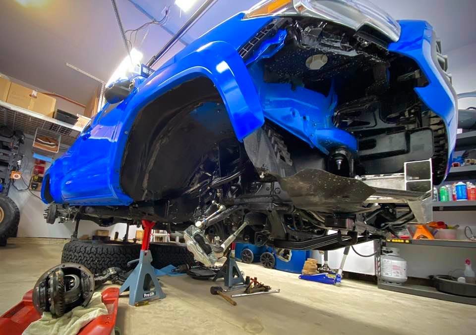

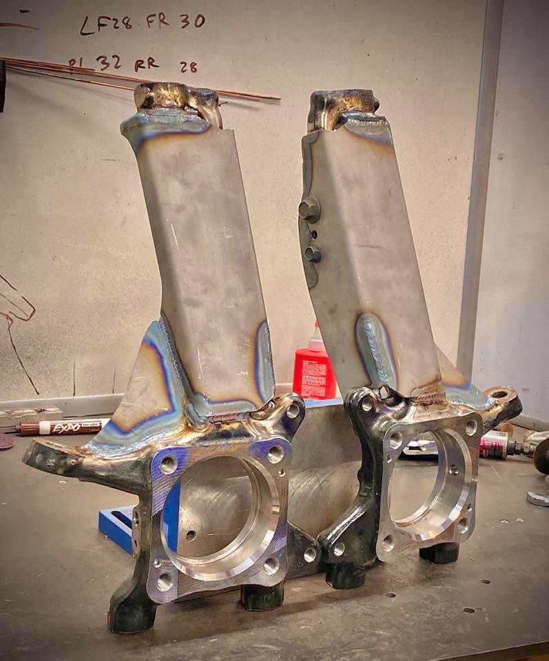

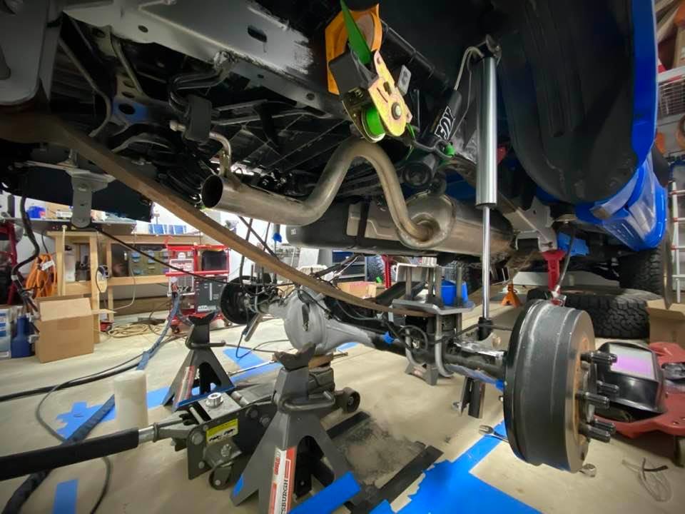

    and then i started to tear into it. both diffs pulled and shipped to ECGS
    122894644_10114144654979853_521434033573_1129b40ffaf1d6c87a5204baca1ce75c81bbfec6.jpg

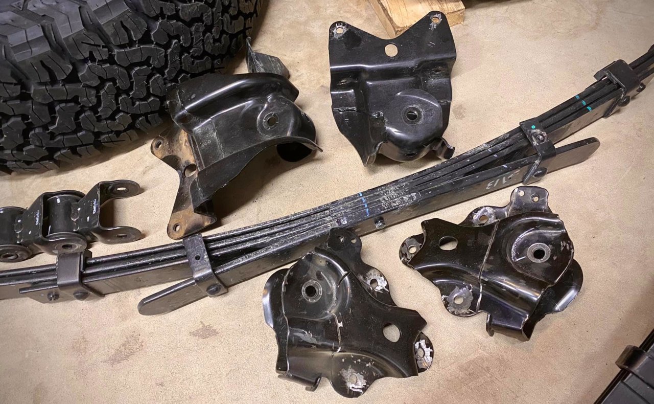

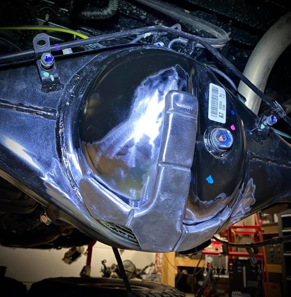

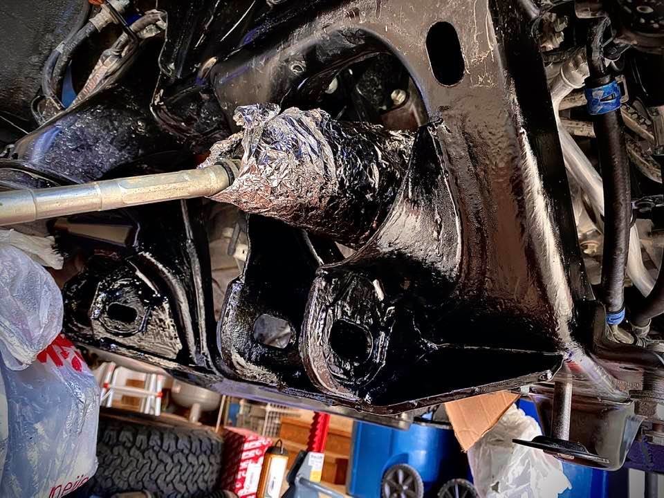

    while the diff was out, I beefed the axle a bit to make sure I never dent the rear cover into the ring gear
    123242821_10114148710058443_791846801552_b3298c1ea1769d7c85f09a58afb565fcd59f0604.jpg

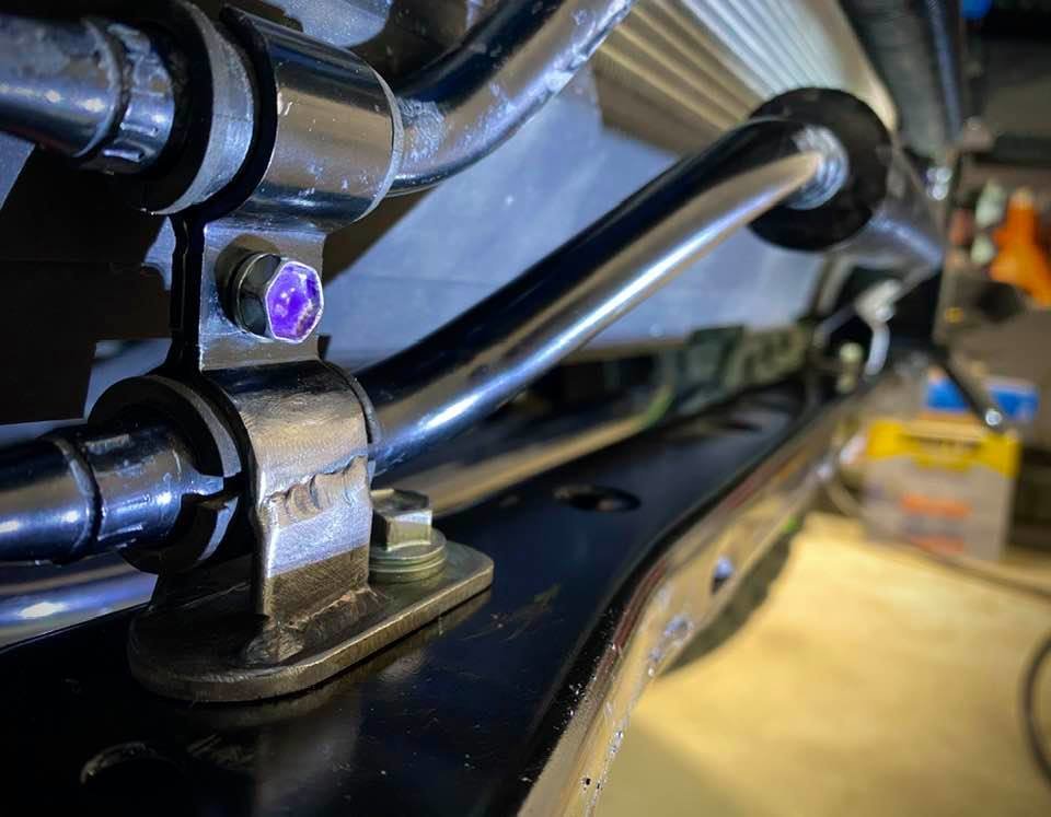

    front suspension got torn down to add reliability to the known weak spots
    123167077_10114154750762823_107360111585_2d9dfdfee79a4cbf9160e95e1ae4e32d53b57ec5.jpg
    hard to tell in this pic but i welded in the marlin crawler LCA tab gussets
    125010358_10114196245177683_818116265261_7fb14735282c66b1cd8a68b5c596d130195e4330.jpg

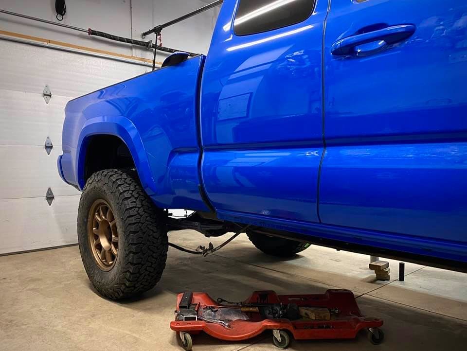

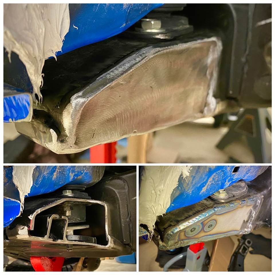

    cab mount chop for more tire clearance.
    126120929_10114227704657633_753089351800_d3b2038c960d4b9c096cbbadf24072b6544a47d1.jpg
    and after clearancing everything for the tires for full suspension stroke and steering, i got the BP-51s bolted in

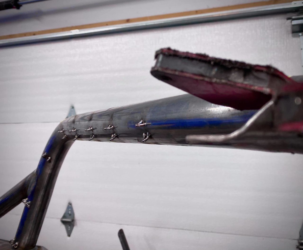

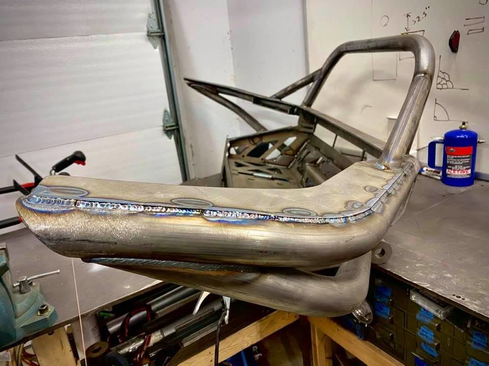

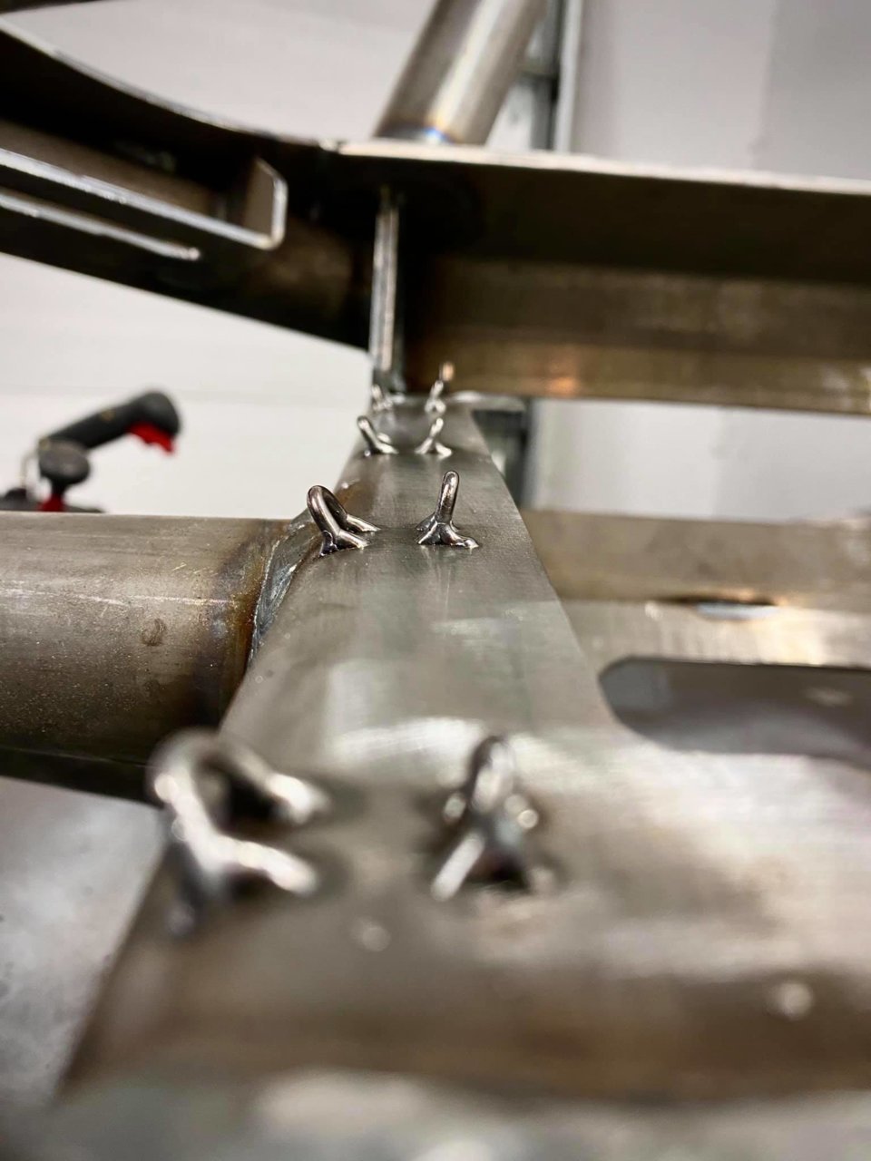

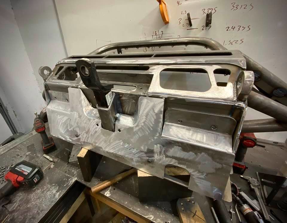

    This part won't be going on for a while but BAMF got my bumper done way earlier than expected.
    Typically I make my own bumpers from scratch but for the sake of saving time (lots to do on this truck) I ended up ordering what to me seems like the best quality/thought out (and looking) bumper I could find.
    that said, I couldn't help but fully weld the areas that were stitched, and I love having a hitch receiver on each end of my trucks. it's just too useful to have.
    131454389_10114357800384753_151481680225_e958df112c92879dc313418200677c838e790a5e.jpg
    little loops to ziptie wire runs onto
    132042354_10114358487318133_386790505247_ade98a6a14e9fe38a97bc0a5c0d01d67cb392989.jpg
    132040858_10114358487407953_120680437654_fe86fe3e0381ed665001b4cac561a3d2689cf1df.jpg
    132260429_10114362385516113_687636816085_559fce48e0d2c3636ea6a34373f649b197db8334.jpg
    and then had to spend a good amount of time modding and smoothing the bash plate to work
    132660005_10114373863524093_832090883565_1c3b80079e3aca1d9471d13dad179ae0fc2facb0.jpg

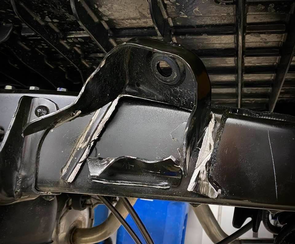

    then I decided to play with my new air chisel.
    got the rear frame rails cleaned up pretty easily
    133525592_10114392698668313_681581426475_549a9f018c049cd18fbcc842e6ef2d114cd4cd56.jpg
    132646928_10114392698778093_531846805433_91cb65523d991b7684dcf4769c89985e7d864980.jpg

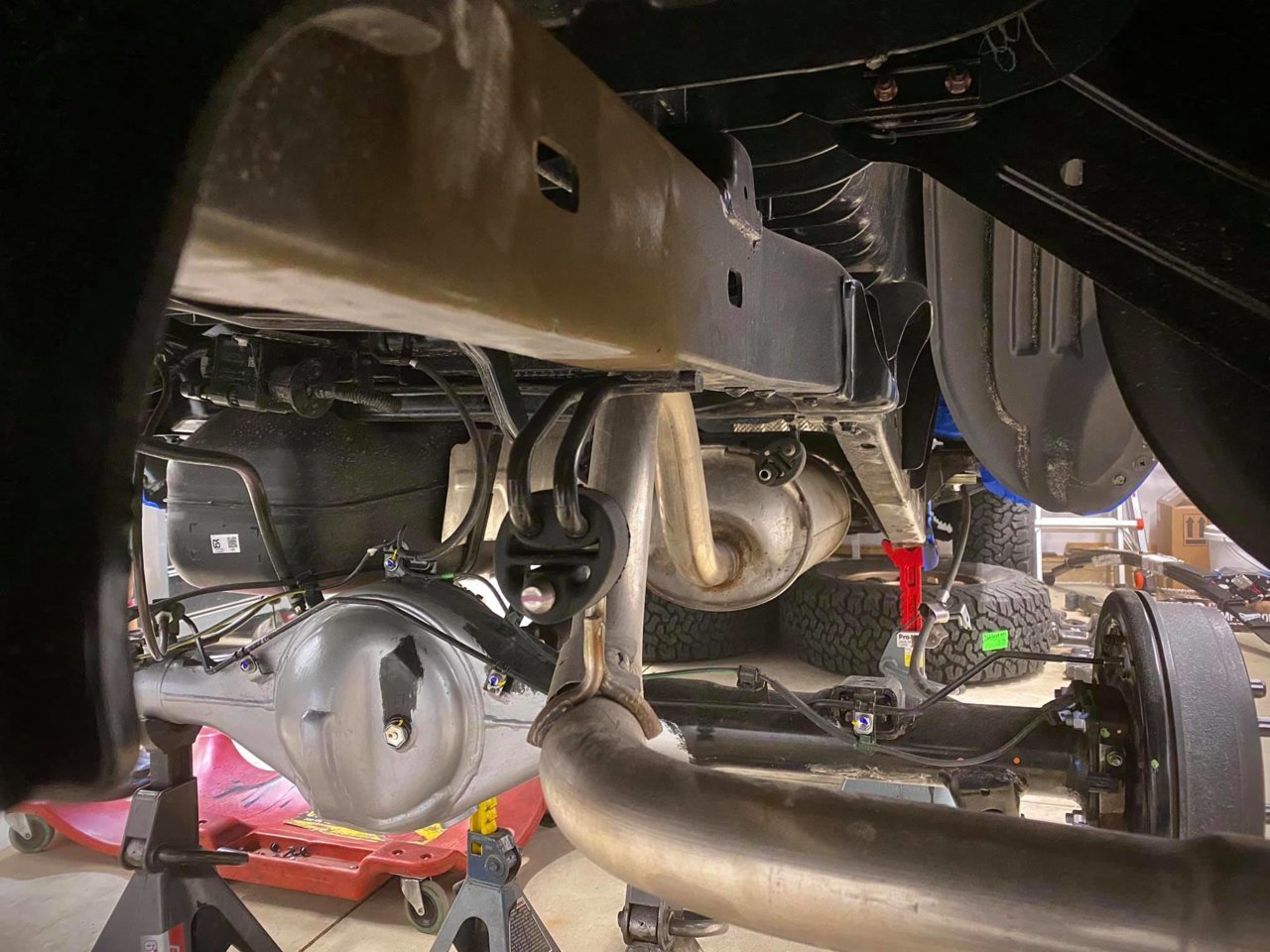

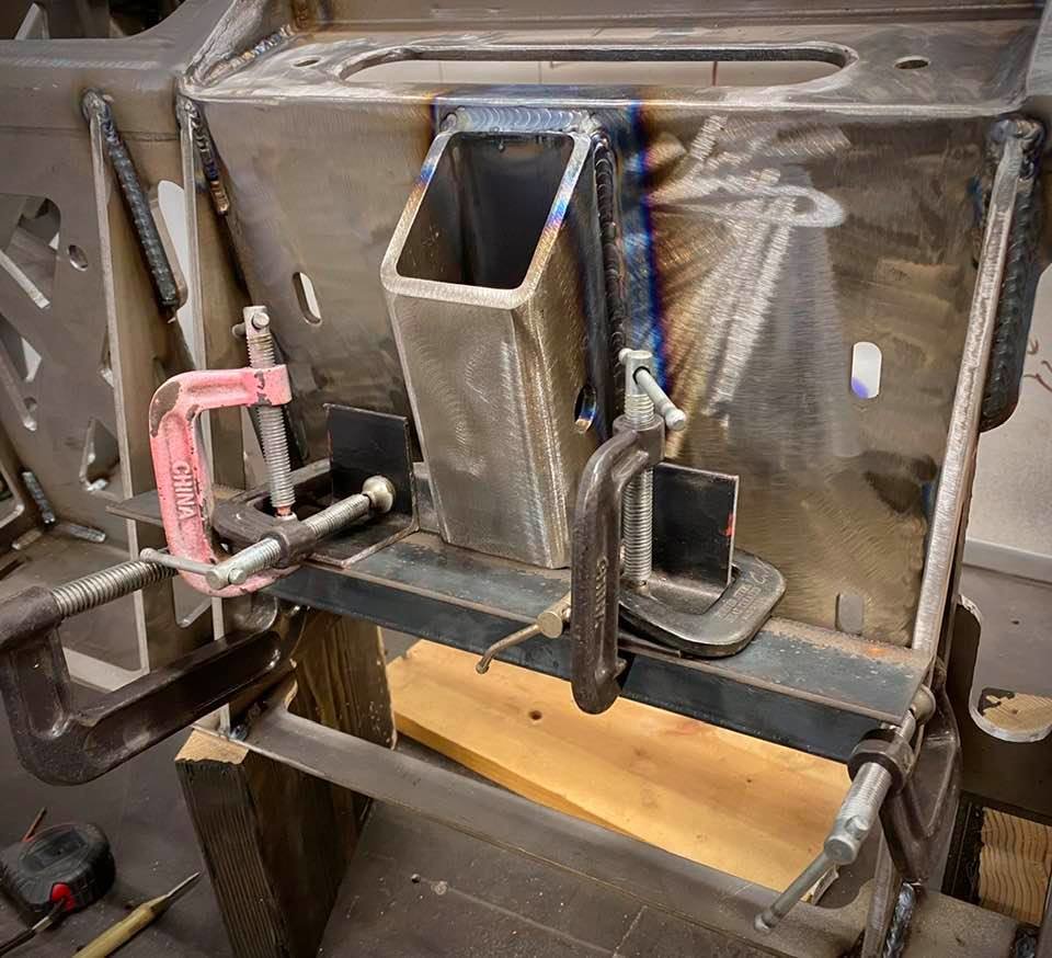

    and after hours and hours and hours of measuring and marking and remeasuring and mocking and remeasuring, I got the front leaf perches for the 63" chevy leafs burned in
    133412686_10114397035232803_829801042451_2b1429d87c92a2bda5446a370623c63a5f632f3b.jpg
    the ruffstuff kit shackle mounts didnt have enough nipples for my liking so i added some myself
    134100494_10114397189249153_685547878276_a0690264d3b4f06a8d4270b0f18572869567ce17.jpg

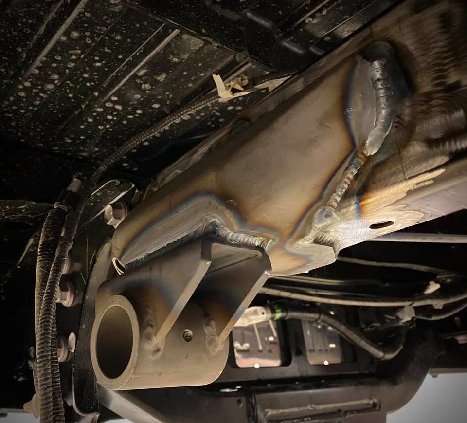

    ... and welded in with their outriggers
    134466302_10114400664439843_713445214075_ae719db42a6ec747b88e03fa040f139c445854f4.jpg
    I don't weld as much as I used to but it feels good when you lay a good string of beads down.
    134210889_10114400717448613_378184149340_fad5fe1288828bc2578132a9451e54efad02331f.jpg

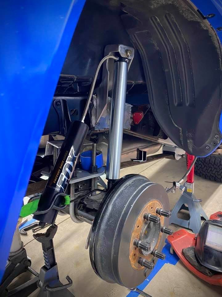

    134677708_10114410879014753_530794021061_65454177fd1cc1cedf48db6bd6da94cc3bb7cb5e.jpg

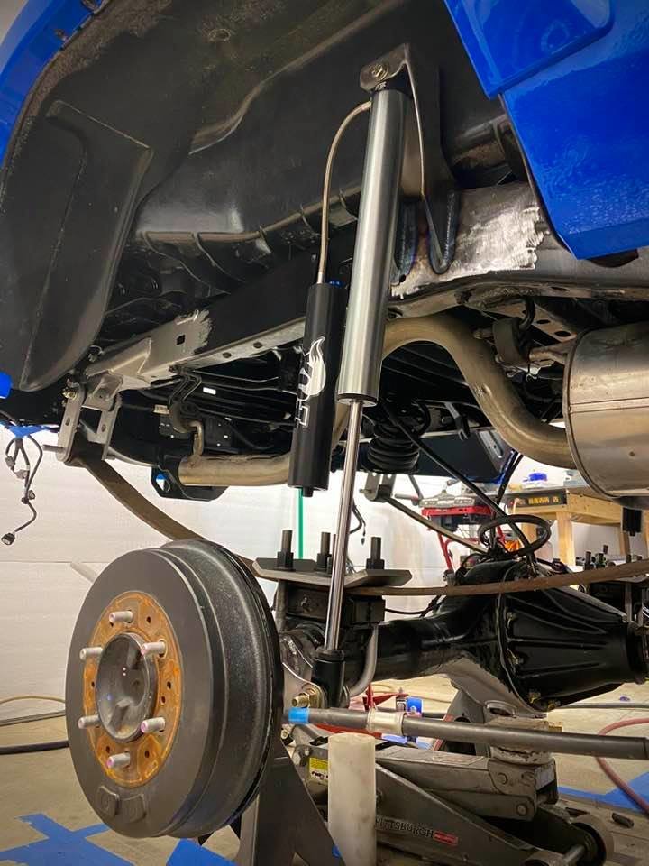

    and started mocking up the 12" Fox shocks on the BAMF shock relocation kit.
    I don't know how people do this without taking their leaf packs apart. (i actually bought new leafs for the truck, but pulled a set from the junkyard to use for mockup/cycling only. hence the rusty mono leaf in some pictures coming up)
    135185368_10114410892772183_422038909508_5d581ff349690ab263a83aad16ce3fe47e8461a6.jpg
    initial tacked position was full bump on the shock with only 4" up travel so I cut those off to redo
    135503600_10114410905905863_137320384810_a81aeff860e468e0261bf88d1feaf7e50ce82d1a.jpg
    clocked the lower tabs a little lower and got it to right around 6"/6" bump/rebound travel from a roughly mocked up ride height and got it fully welded in
    133858644_10114414337977963_798272532882_8cde5815ea2c6c27e3fc8ac28e421c74eb780738.jpg

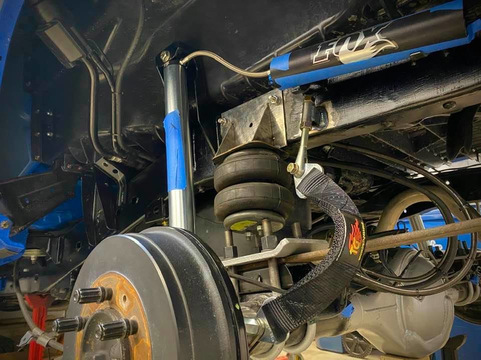

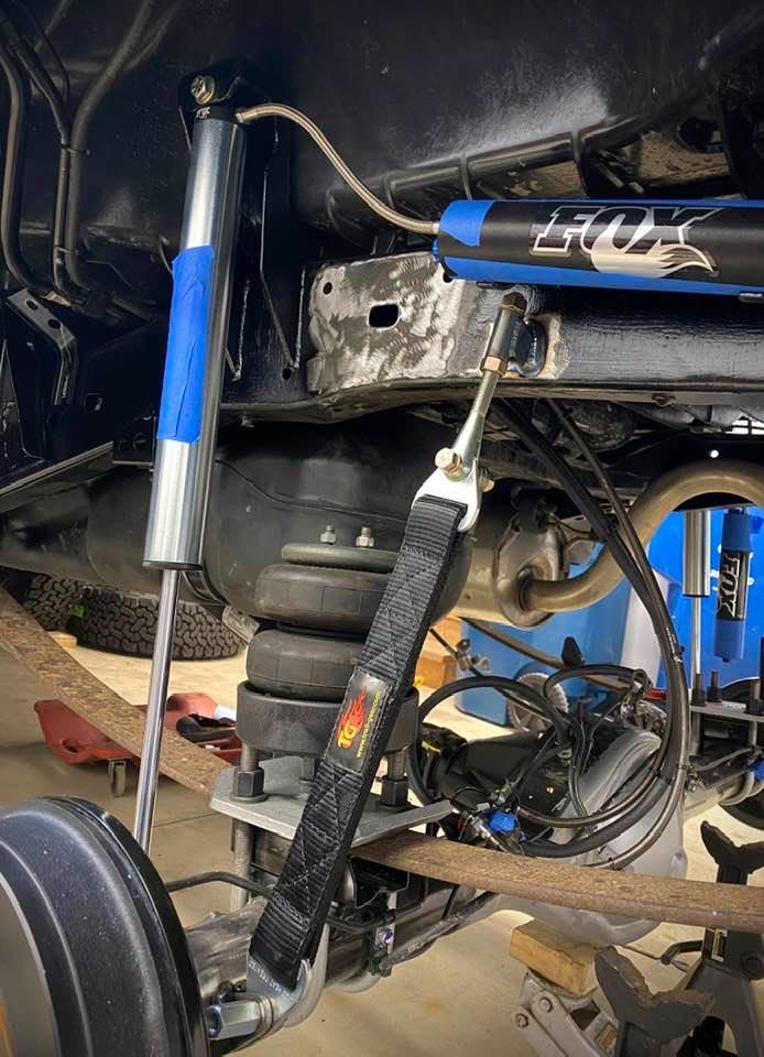

    and of course who doesn't want to protect their expensive shocks from pulling apart?
    135818886_10114444547757323_920385955804_2db0166acf2b8e460588b2d3c22f9703ac17aae5.jpg
    started fabbing up some brackets to hold air springs on. I'll be using the daystar cradles on the axle side.
    the air spring in the pictures is just mockup ones I had laying around from when I had a lowered S0 during high school....
    I found that airlift has some springs with internal jounce bumpers in them, with 3 different heights to choose from, so that is the direction I'm going.
    I'm not sure why I haven't seen many people use them on tacomas, since it's quite difficult to package both air springs and bump stops in the same location otherwise.
    136126807_10114444553580653_514545900306_8278f66ef1ff1567145e4c737c31026c32d147f3.jpg

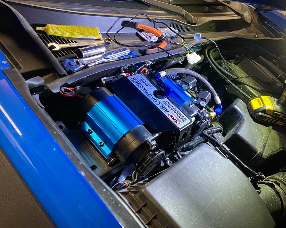

    and on the side I added some bling under the hood to power my dual ARB lockers and inflate tires.
    I'm looking forwards to faster airing up. I just used a portable Masterflow compressor with the blazer, and i was always annoyed at how long it took + trying to figure out what to do with a hot compressor after filling up 8 tires (what, your wheeling buddies have their own compressors? whaaat?)
    Didn't like the idea of not having a check valve on the leader line, and also heard people mention the -4 stainless line was restrictive, so I ran -6 stuff to a 1/4"NPT check valve. we'll see how that goes once i wire it up.
    138044589_10114447123056403_387927912895_a7348c70b8e4caab8a9ef4ce2df5e87a767c908b.jpg
    I got the back end back on the ground, but I'm still waiting on pinion shims to correct driveline angles and final hardware. I want to add tabs and brackets here and there for various things before i do a final coat of paint too.
    138300266_10114448484812433_656808173378_9f2eb2ba344f0c100604457483e1b86dbbd3d20c.jpg

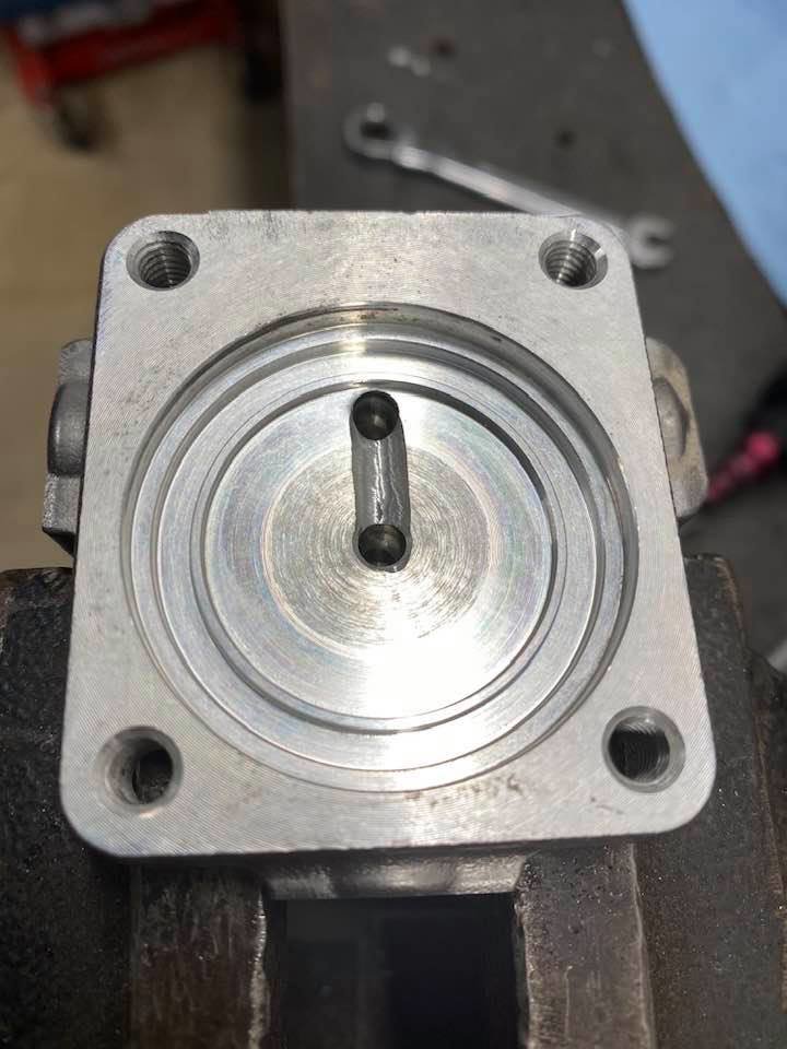

    Clutch hydraulics accumulator delete. There are some extensive threads on this if you are interested.
    Yea most likely, I have been surprised to see how many voodoo blues are in the area already though.
